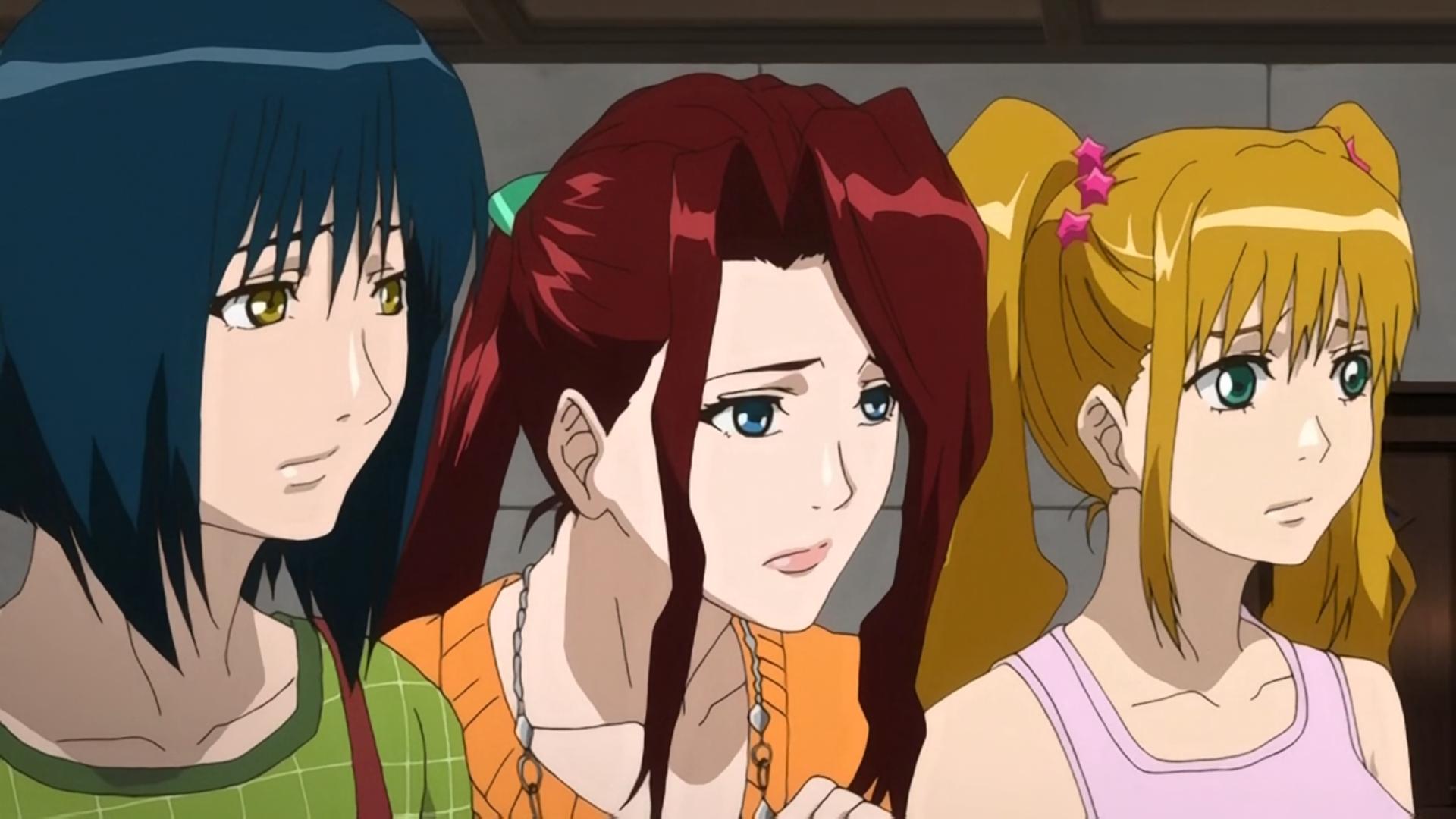

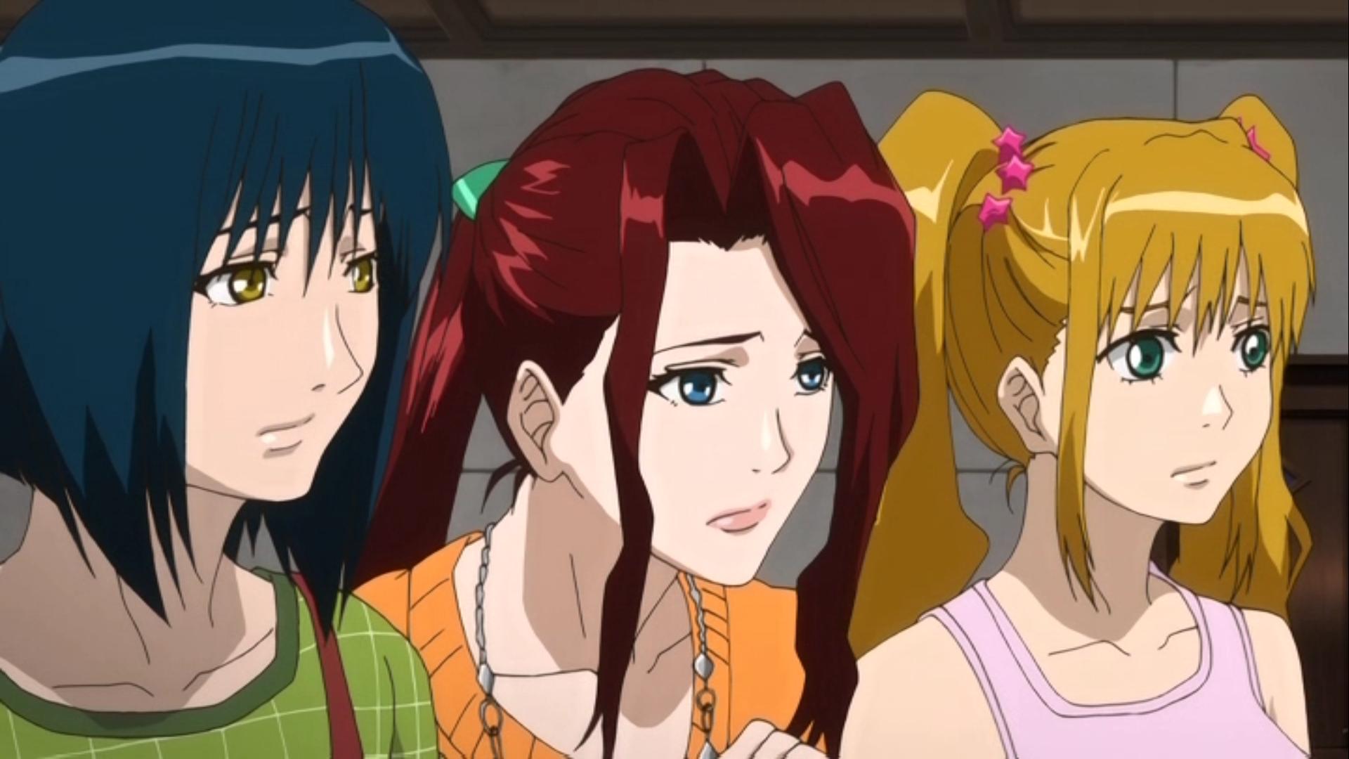

  1. before
    https://forum.videohelp.com/images/imgfiles/sd61qpa.jpg
    after
    https://forum.videohelp.com/images/imgfiles/BwZcc8H.jpg
    one is 480p version and the other is up scaled 720p version
  2. The two links/pictures are identical. And it looks like a simple resize from 480p to 1080p.

  4. Without having the actual source it's hard to say for sure but try something like:
    WhateverSource()
    FastLineDarkenMod()
    aWarpSharp(depth=3)
    nnedi3_rpow2(2, cshift="Spline36Resize", fwidth=1280, fheight=720)
    aWarpSharp(depth=3)
    Sharpen(0.2)
    nnedi3_rpow2(2, cshift="Spline36Resize", fwidth=1920, fheight=1080)
    aWarpSharp(depth=3)
    Sharpen(0.2)

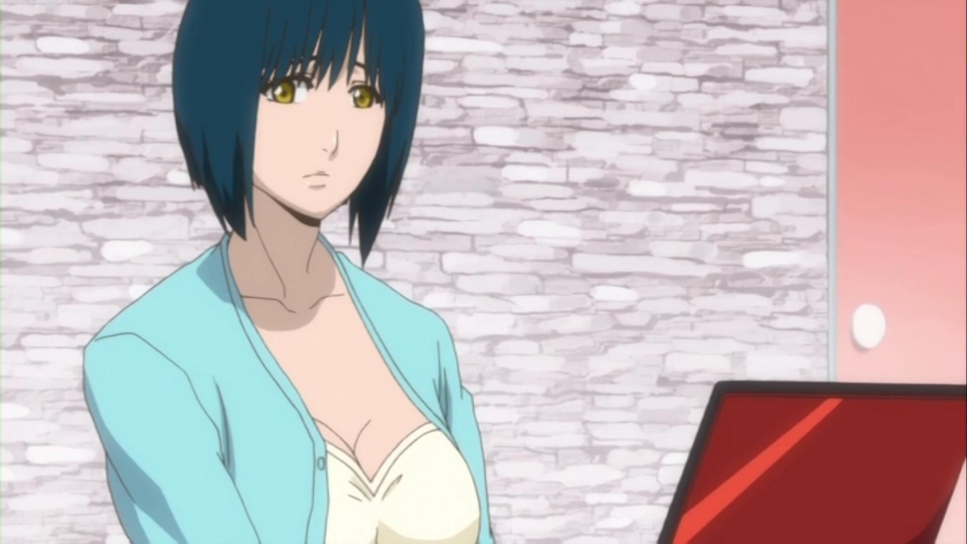

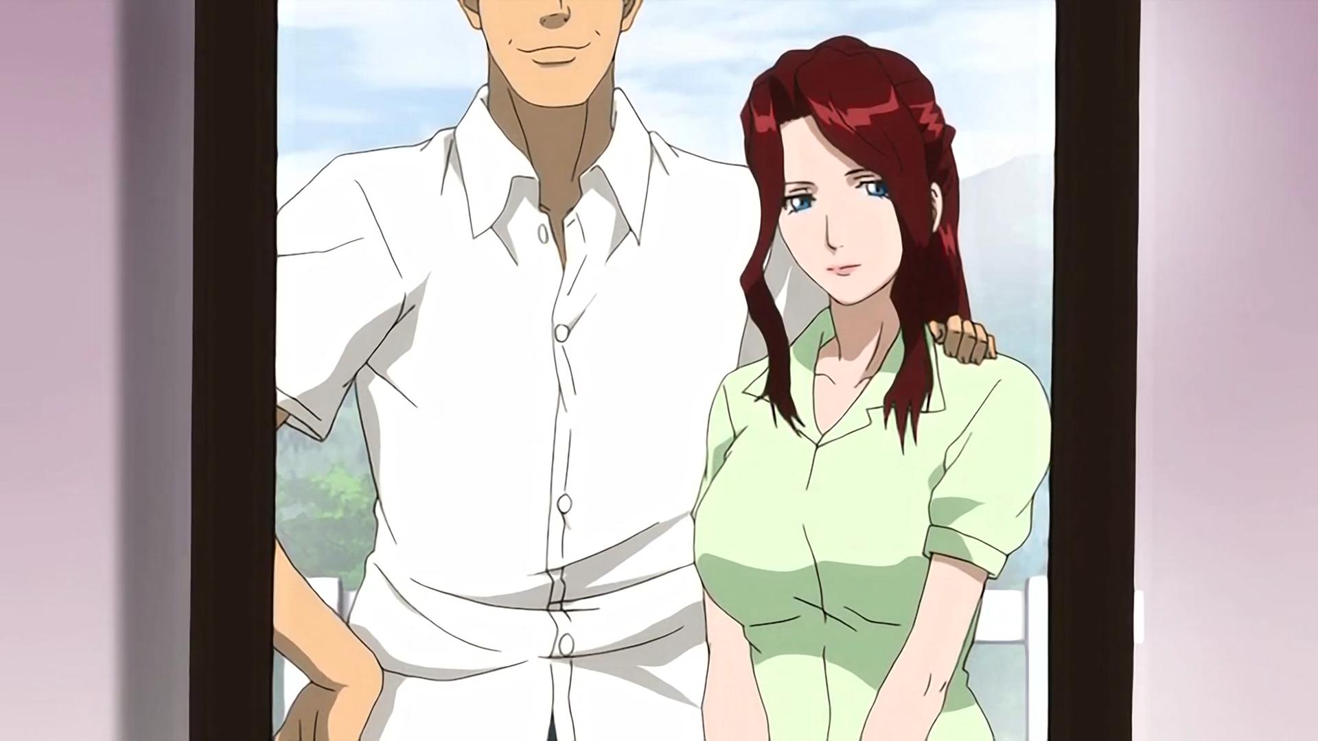

  6. Well the images were 1920x1080 so I upscaled to the same size. If you want 1280x720 remove the last three lines. If you do that you might want to increase the remaining aWarpSharp and Sharpen values a bit too.
    https://forum.videohelp.com/images/imgfiles/9khferJ.jpg
    https://forum.videohelp.com/images/imgfiles/mAbxfD1.jpg
    do you think to add anything else or is this "perfect" balance?
    huge improvement tough
  8. Oh, assuming your source is rec.601 (almost all SD is rec.601) you should convert to rec.709 (almost all HD is rec.709) with ColorMatrix(mode="rec.601->rec.709").
    You might look into applying some deringing to reduce the noise around the dark lines. If your source is DVD use Mpeg2Source("source.d2v", CPU=6) or CPU2="ooooxx"). The former applies deringing and deblocking, the latter only deringing. Mpeg2Source's deblocking is a little too strong for some video but should be fine with anime.
    Sharpening the chroma more than the luma usually helps too. Change the last aWarpSharps to MergeChroma(aWarpSharp(depth=3), aWarpSharp(depth=10)).

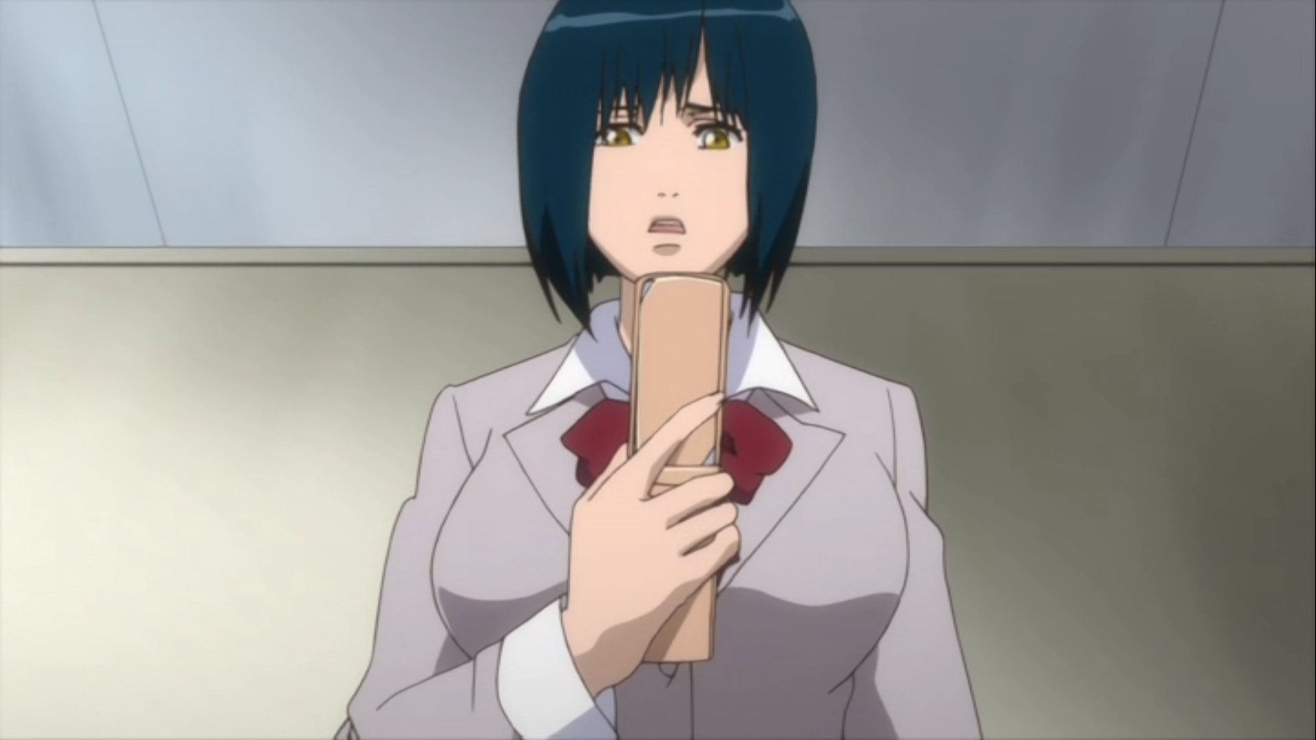

    https://forum.videohelp.com/images/imgfiles/VZqpHzQ.png
    https://forum.videohelp.com/images/imgfiles/85EZgrZ.jpg
    what do you think go with this script?

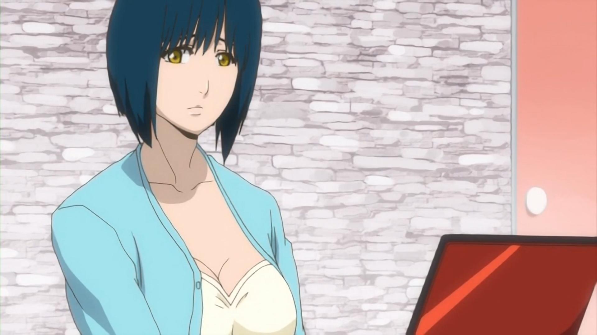

    Yes, notice how the laptop has changed color from red to orange in the images in post #7. That's what you're trying to fix.

    https://forum.videohelp.com/images/imgfiles/BZXSqqX.jpg
    https://forum.videohelp.com/images/imgfiles/fWYTq02.jpg
