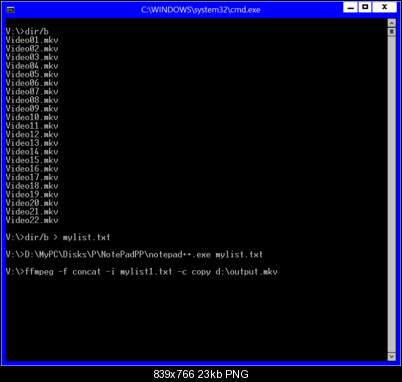

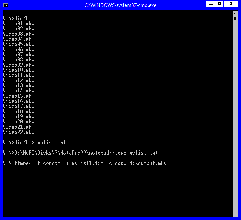

  4. First you download a static version of ffmpeg
    Open a CMD shell as shown below.
Name:	Screenshot - 2_14_2016 , 10_27_34 PM.png
    First "dir/b" shows the files.
    Next "dir/b > mylist.txt" creates the mylist.txt file.
    Next "D:\MyPC\Disks\P\NotePadPP\notepad++.exe mylist.txt" opens it for editing in Notepad++. The edited file is saved as mylist1.txt.
    Next "ffmpeg -f concat -i mylist1.txt -c copy d:\output.mkv" concatenate the files in mylist1.txt to the output file d:\output.mkv
