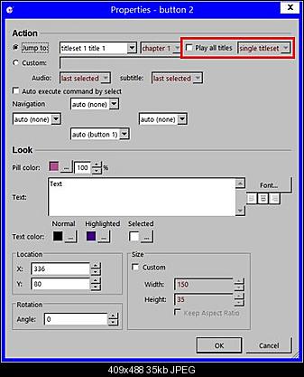

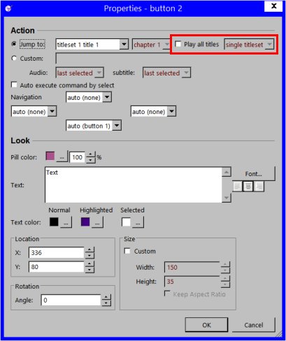

  3. Sorry. I misunderstood. Thougth it was chapters. Anyway DVDStyler has a "Play All" checkbox.
