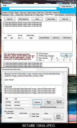

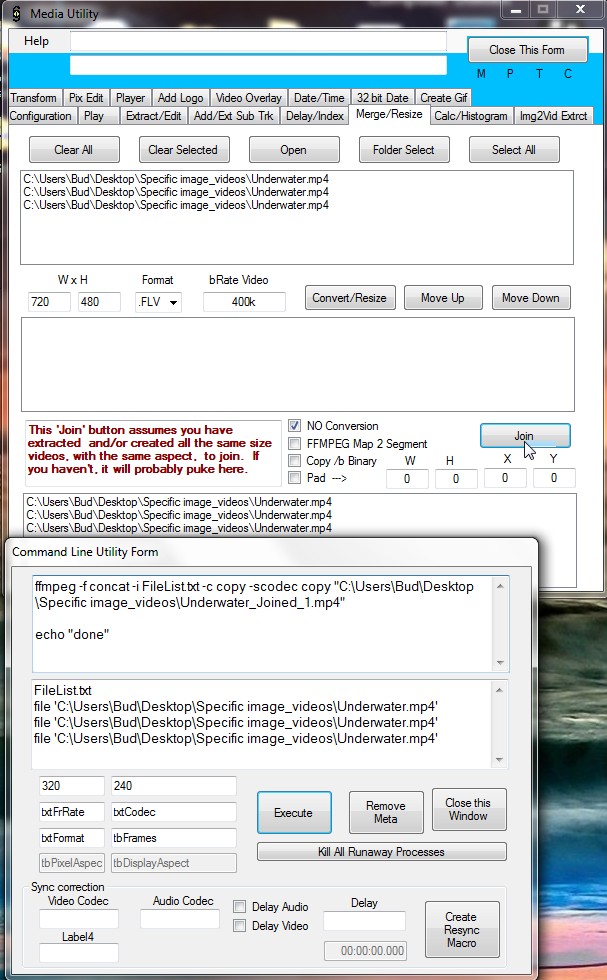

    I don't think you really need a multicore, cuda enabled, etc if you are not re-encoding since it's pretty fast. If you have a ton of these to join, it would make it worthwhile to have a program written for this and I recommend railroadartwork's suggestion for concat with ffmpeg:
Name:	ScreenHunter_190 Feb. 14 11.04.jpg
