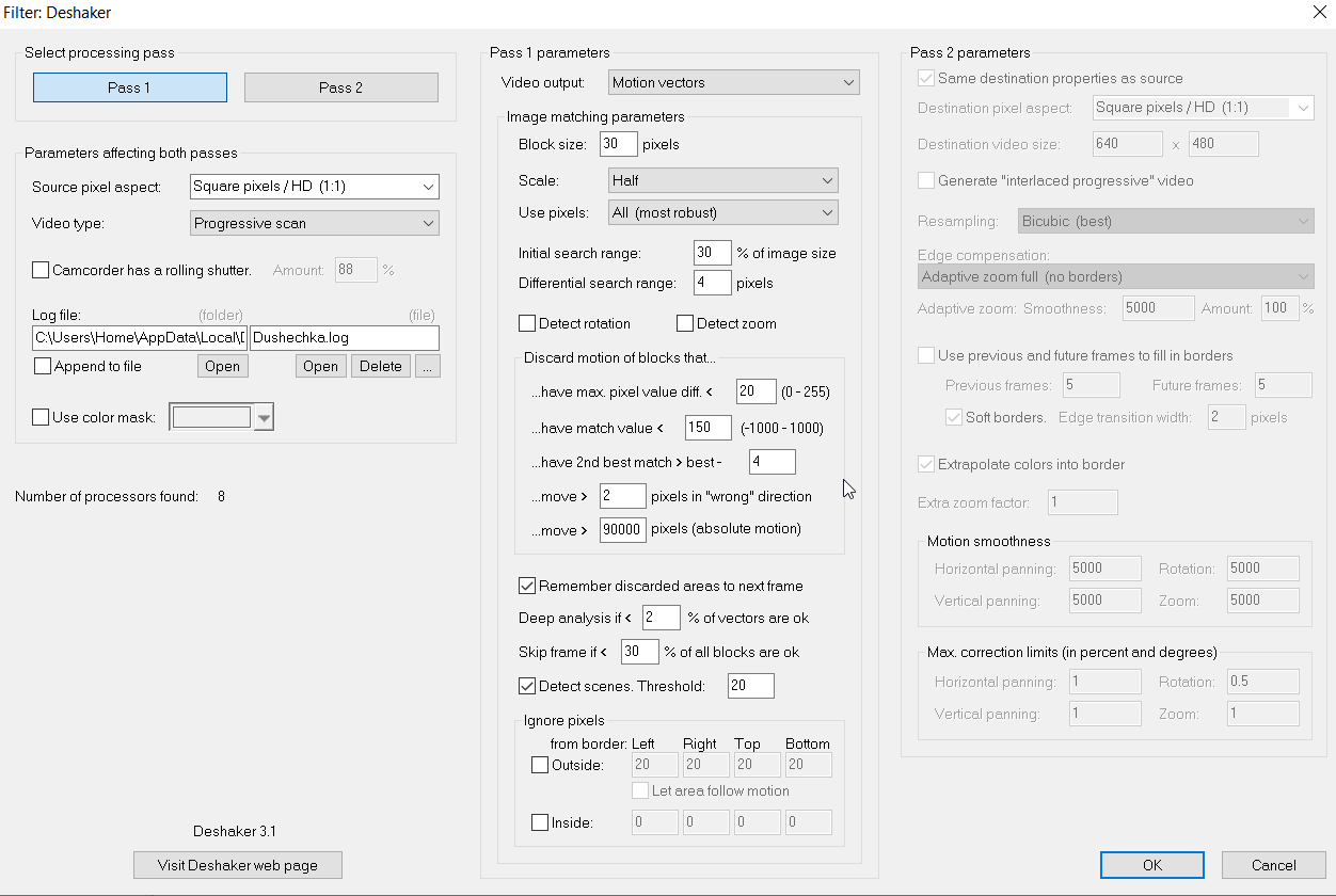

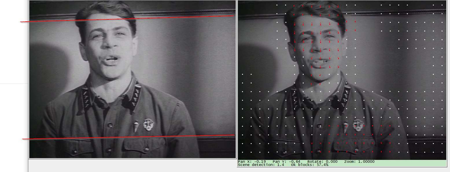

    Hey. I tried to process the video 11 seconds 7 mb https://drive.google.com/open?id=1eOEqGOVd7WdPPC9RLXAvRoHIaxB3xGH3 with parameters Image
    [Attachment 48358 - Click to enlarge]
    but it is impossible to stabilize (red lines) Image
    [Attachment 48359 - Click to enlarge]
    Can I hope for help?
  19. The problem with a shot like that there's not much detail in the background for the deshaker to lock on to. So it locks onto the person who's moving around. Try using the "Ignore pixels inside" feature to eliminate most of the person. AviSynth's Stab() works pretty well with that shot.
  20. +1 jagabo. I was going to send you a link to the Deshaker guide I wrote years ago, but it seems to have disappeared from all the sites that used to post it. The "ignore pixels" was one of the settings I highlighted. It works great for things like this, where you want to use only the background in order to remove the gate weave which is the source of the motion in this clip.
    [Edit]I've attached a copy of my guide, in Word format. Scroll way down to the "Advanced" section to get some more answers to your question.

  22. Originally Posted by doctorkhv View Post
    Thanks. I can also tell you about btightness/contrast ... before of the Deshaker. The "ignore pixels" does not work.
    Does it mean that means the Deshaker such stabilization is impossible to perform?
    No, it means you have set many of the options to the wrong values. I just looked at the settings in your OP screen shot, and you have changed many things from the default values. Almost every change you made will make the program work badly, but the worst settings are those at the end of pass 2. You have the max correction limits set all the way down to 1%. Set those back to 15, although you can keep zoom at 1 (you most definitely do not want to have it attempt to zoom in and out). I suppose you did this because you thought Deshaker might apply too much correction. That is not how it works. The only time you want to use these limits is if motion you want to remove is all in one direction. For instance, if you take video from a moving car, it doesn't jerk back and forth (your hand might, I suppose), so most of the unwanted motion is vertical. You might get better results by limiting the horizontal corrections.
    I could go through all the other settings, but the simplest advice is to start again by using the defaults and then make only the change that jagabo suggested. When you do that, make sure you are forcing the program to look at the edges. It is easy to get confused and get the setting backwards. It will be obvious during pass 1, so make sure to check. Also, when you limit what part of the image will be used, keep plenty of pixels. I mentioned this at the end of my guide, if you had a chance to skim through it. You need at least the "block size" number of pixels around the border, and preferably 2x or 3x that size. If you really think you need a narrow border, then use a smaller block size, although that will make pass 1 take more time.
