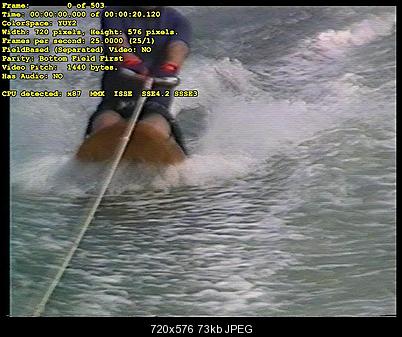

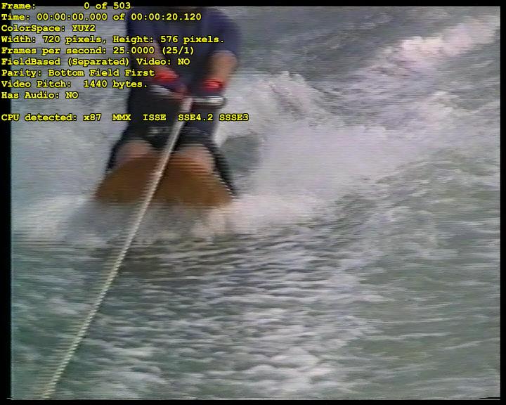

  16. I was afraid MediaInfo wouldn't say anything useful. Try Opening each of the videos with an AviSynth script like:
    AviSoure("filename.avi")
    Info()
    That will overlay information about the video onto the picture. What does it say about the colorspace?

  17. OK .... just to run the sequence
    Original file DV capture - YV12
    Deinterlaced and colour space change to YUY2, compressed with GV-Lossless (Bitrate shows as 429Mbps) - saved as test
    open test and save again as GV Lossless or direct stream copy - YUY2 (Bitrate shows as 429Mbps )
    open test and save using fast recompress - YUY2 (Bitrate shows as 199Mbps)
    So not showing any colour space change only bitrate
  18. How are you verifying the colorspace used in each file?
  19. with the script you posted in #16 .....
    can post screen grabs if you want ... but other than colorspace all other info was in Mediainfo files
