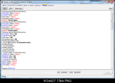

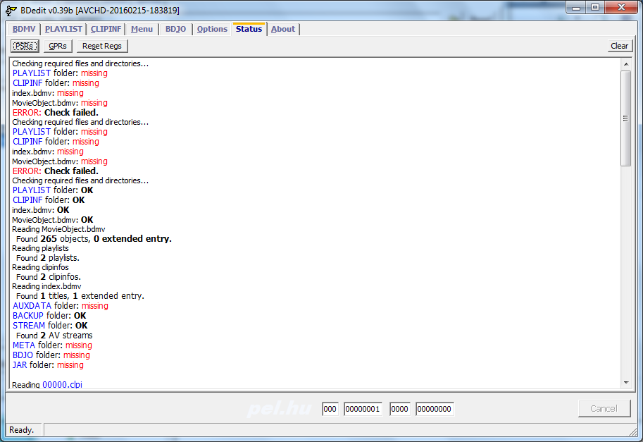

    Loading file structure into BDedit - multiAVCHD appears to generate two errors but movieObject.bdmv does exist in the directory structure
Name:	BDedit multiAVCHD.png
