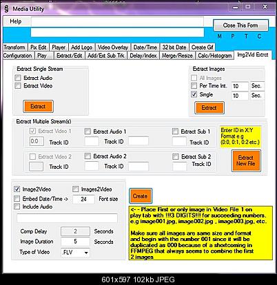

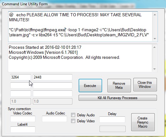

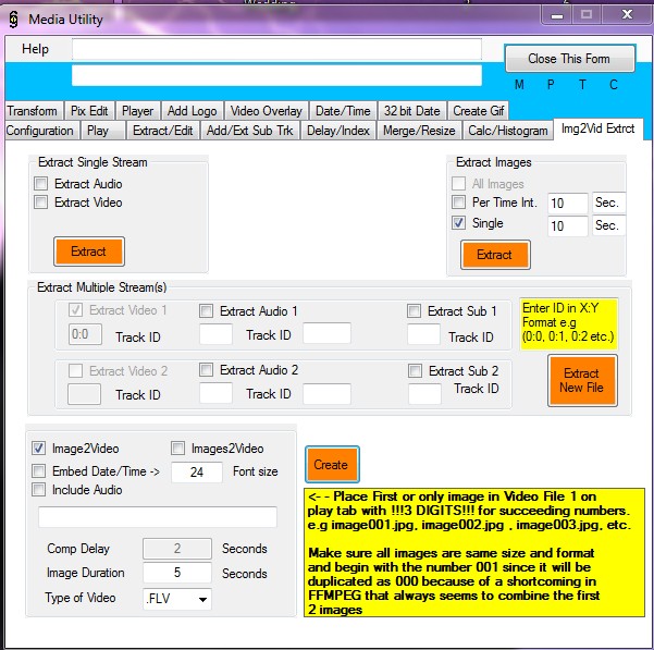

    FFmpeg (Command Line) seems to handle 8 Mega Pixel (3264x2448) okay but if you are converting a JPG to an Mjpeg so I'm not sure you can do it without recoding it. You want a movie basically from the images correct?
Name:	ScreenHunter_189 Feb. 10 01.28.jpg
Name:	ScreenHunter_190 Feb. 10 01.29.jpg
    EDIT:
    Just a thought but if you intend to put 8 hours worth of 8mp images into a video with say 25 fps then the resulting video in Hevc, 4K, x265 is going to be HUGE and encodes slowly also...
    Data: Stream #0:0 -> #0:0 (mjpeg (native) -> hevc (libx265))
    Data: Press [q] to stop, [?] for help
    Data: frame= 241 fps= 12 q=-0.0 size= 584kB time=00:00:07.00 bitrate= 683.7kbits/s dup=238 drop=0 speed=0.351x
    Data: frame= 241 fps=5.8 q=-0.0 size= 584kB time=00:00:07.00 bitrate= 683.7kbits/s dup=238 drop=0 speed=0.168x
    Data: frame= 359 fps=5.1 q=-0.0 Lsize= 1197kB time=00:00:11.90 bitrate= 823.9kbits/s dup=356 drop=0 speed=0.168x
    Data: video:1191kB audio:0kB subtitle:0kB other streams:0kB global headers:1kB muxing overhead: 0.458128%
    Data: x265 [info]: frame I: 2, Avg QP:24.24 kb/s: 126037.56
    Data: x265 [info]: frame P: 71, Avg QP:33.87 kb/s: 187.60
    Data: x265 [info]: frame B: 286, Avg QP:35.72 kb/s: 94.59
    Data: x265 [info]: Weighted P-Frames: Y:0.0% UV:0.0%
    Data: x265 [info]: consecutive B-frames: 1.4% 0.0% 1.4% 0.0% 97.3%
    Data:
    Data: encoded 359 frames in 70.75s (5.07 fps), 814.62 kb/s, Avg QP:35.29
