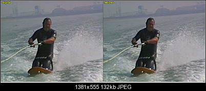

  3. It's not just viewing angle ... every frame .. the right hand side is different colour balance to the left, ... look at this screen grab:
  4. You're not looking at the same frame from each video. The color of the original video is varying from frame to frame. Remove the two Trims from the first line of the script.

  6. Originally Posted by Tafflad View Post
    I don't follow ...
    You should. When doing side-by-side tests like that it's pretty important that you compare the same frames of the two versions. Just looking at the picture you can easily see the top of guy's head in the left pic is at the horizon line, while in the right pic it's noticeably below the horizon line. Different frames.
    This isn't to disagree with your conclusion (right has 'more color' than the left), but only to mention that you should be making true comparisons.

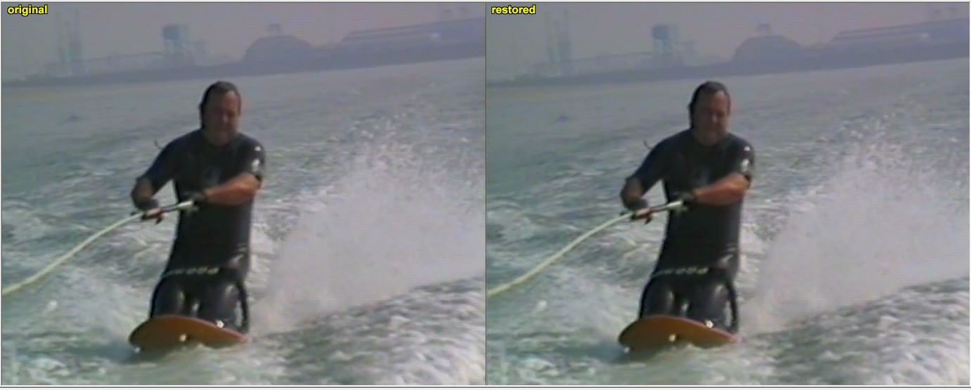

    When I look at it the right hand still seems to have a colour cast .. maybe it is just the way the image is ... or an optical confusion for me.

  13. The colors in your two images are the same. Here I've cropped they arms/hands and set them next to each other:
    Otherwise... The frame has a green tinge on the left, changing to a blue tinge on the right. That alone gives the illusion that the colors are different. And as I indicated before, since you are cropping differently you literally get more of the green in one of the images. Make the cropping the same. Also try using Interleave(a,b) instead of StackHorizontal(). That shows the videos one after another (frame by frame) rather than side by side. That is the best way to see subtle differences. Another method you can use is Subtract(a,b) -- that gives a flat grey image where the frames are identical and deviations from grey where they are not. It often helps to follow Subtract() with something like Levels(120,1,136,0,255) to accentuate the differences.

  14. Just unlucky - the swing from Green to Blue made images look as if there was marked colour change ........ certainly fooled me
    Thanks for your help
