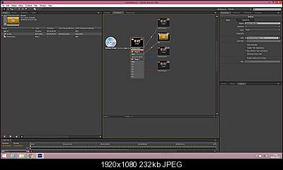

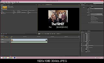

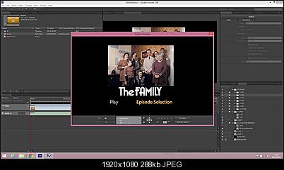

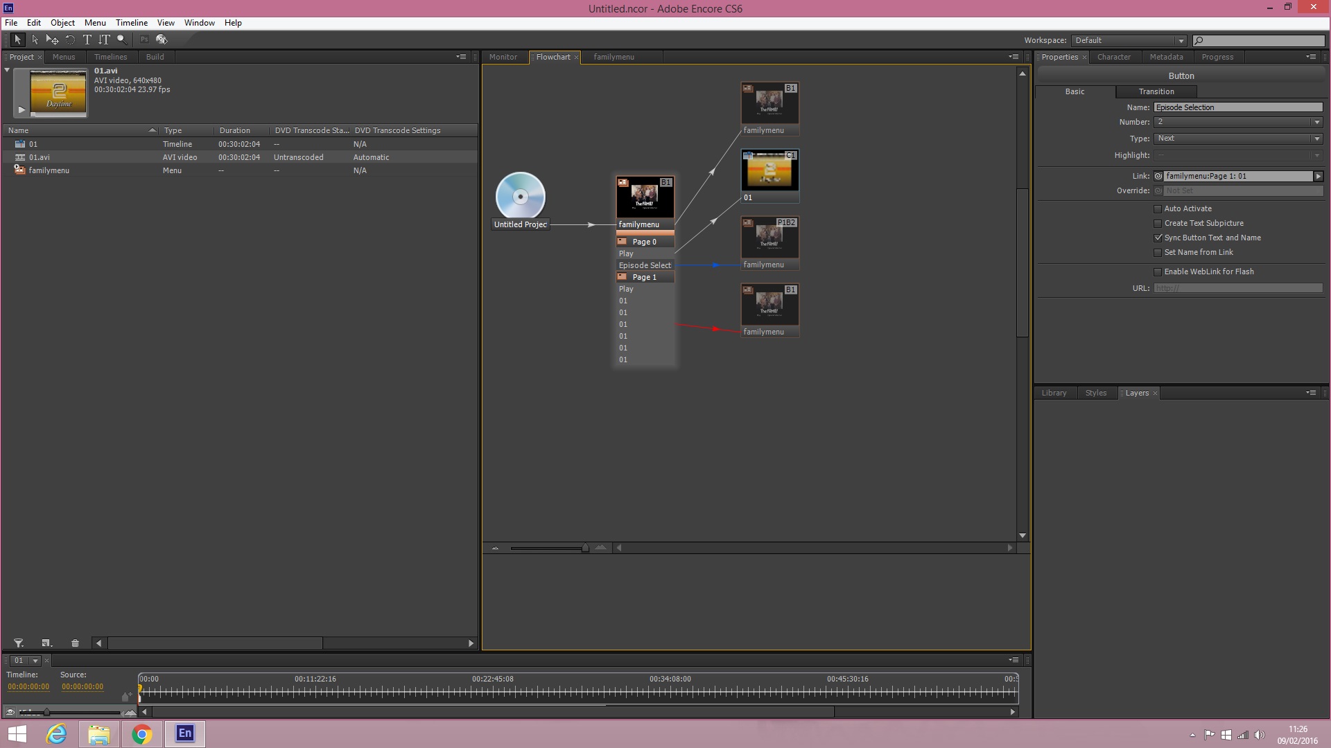

  3. Screenshots showing your button and routing configuration in Encore would help.

    Here are some screenshot for you. Basically, I have used this YouTube video in order to create the main menu and 'sub-menu' (being careful not to call it a multipage menu!
    But, as per the comments on the YT page, the Episode Selection or Chapter button does not do anything - in both Preview or Build.
