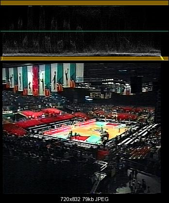

  11. Should I be using the proc amp (either the AVT or the internal) for anything other than avoiding crushed whites/blacks, or is it best to leave that for post? I've got a tape with the whites in almost exactly the right spot, but all the blacks are about halfway between the blue mid-line and the start of the lower yellow area.
  12. Well, tried it both ways.
    Any feedback?
    Any feedback?
    I see clipping in both, but less with the ProcAmp version, so at least you're on your way. (Look at the top part of the histogram - Original, then ProcAmp below.)
    I hate VHS. I always did.
  14. ColorTools in VirtualDub isn't great for checking levels. It works in RGB after a rec.601 conversion. That conversion clips Y values below 16 or over 235.
    The proc amp has pulled overall levels down by about 8 units and decreased the gain by a tiny bit. You can get the original to match pretty closely with ColorYUV(gain_y=-4, off_y=-8). Neither has hard clipping at Y=255 or Y=0.
    The black level in the clips is probably way too high, around Y=50, not Y=16. I say "probably" because it's always possible these two shots are supposed to be this way. But I think they should look more like:

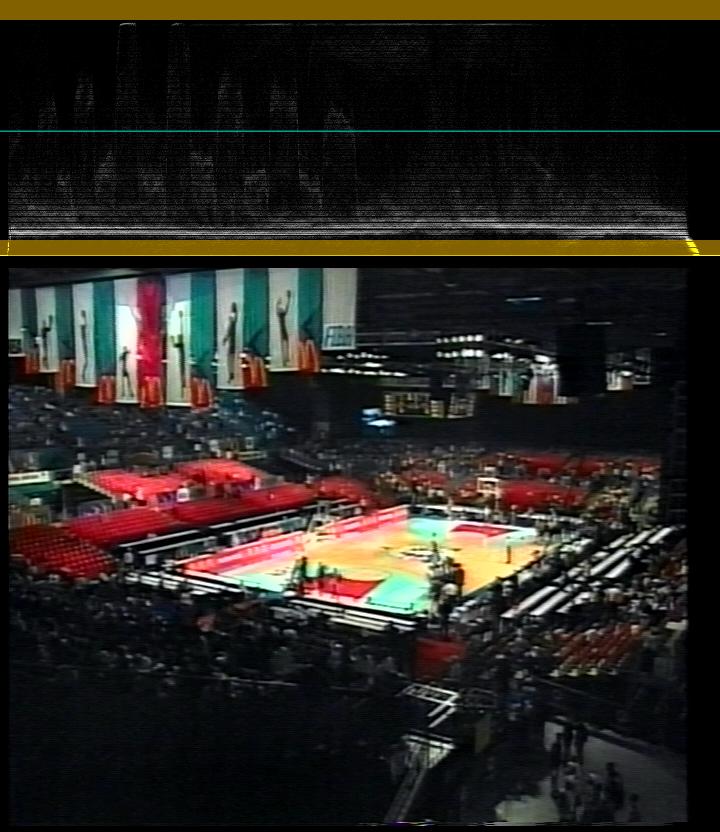

  15. Member PuzZLeR's Avatar
    Oct 2006
    Toronto Canada
    Hi Jagabo,
    I've re-adjusted the parameters a bit better, and I still see clipping, particularly more so in the Original, but even in the improved ProcAmp. The Y channel is fine, but I'm concerned about the R, G and B. Yes, no hard clipping as you say, but clipping nevertheless even when there are no serious "flatheads". Should we be concerned here? (Again, "Original" first, "ProcAmp" version next.)

  16. Originally Posted by PuzZLeR View Post
    even in the improved ProcAmp... I'm concerned about the R, G and B. Yes, no hard clipping as you say, but clipping nevertheless even when there are no serious "flatheads".
    There are a few pixels with Y>235. But most of the problems are from illegal combinations of Y, U, and V (even when each is within its individual valid range) because the video is way over saturated. For example, at Y=235 the only valid U and V value is 128. Any other U or V value will lead to an illegal RGB color. Only about 1/6 of the possible YUV values leads to a valid RGB pixel. See the "RGB Colors Cube in the YCbCr Space" image at this site:
    https://software.intel.com/en-us/node/503873
    https://software.intel.com/sites/default/files/did_feeds_images/0EF01A88-F874-4ECB-B2B...1EB8211A76.jpg
    The outer box represents all possible 8 bit YUV values. The inner box is the portion that leads to valid 8 bit RGB values.
    During capture you're really only worried about hard clipping at 0 and 255 (Y, U and V). Everything else can be fixed later. Of course, you don't want too little range in the YUV values. That will lead to posterization problems.
