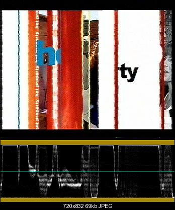

  5. Success! Although there's a weird green area at the bottom, and all I can get in VDub is whatever frame it happens to be on when I open the AVS, so this took a while to pull up.
    ETA: It doesn't matter what I do with the proc amp settings, there are no superblacks. There are, however, superwhites very briefly during the transition from the wrestling to Hot Property, and if I pump brightness and contrast way up, they appear throughout the rest of the tape as well.
  6. It looks to me like you have a 720x480 picture in a 720x576 frame, ie an NTSC vs. PAL issue. Maybe you have the frame size set wrong somewhere.
    By the way, you do have super blacks but I'm pretty sure it's the green bar at the bottom of the frame. You could use Crop(0,0,720,480) before Histogram() to eliminate that.
  7. Ah, yeah, there was a GraphStudio picture setting which I'd set to 'Unknown' when I was having issues with the AVS, setting it back to PAL_I got rid of the green area and the superblacks (which slipped past me thanks to never moving at all, no matter how much I played with the proc amp or what was on the screen). Now it's as I said, no superblacks, occasional superwhites, fiddling with the proc amp can get me more superwhites but can't introduce superblacks.

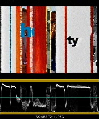

  9. Originally Posted by koberulz View Post
    So am I supposed to make sure the whites are as high as they can get at this stage, or should I just make sure everything is inside the black and worry about the rest of it in post?
    In general, you want to keep the histogram in the black area. With the darkest darks just above the bottom brown area and the brightest brights just below the top brown area. But VHS is prone to a lot of faults so you have to use your judgement a bit. For example in your testcap3.avi:

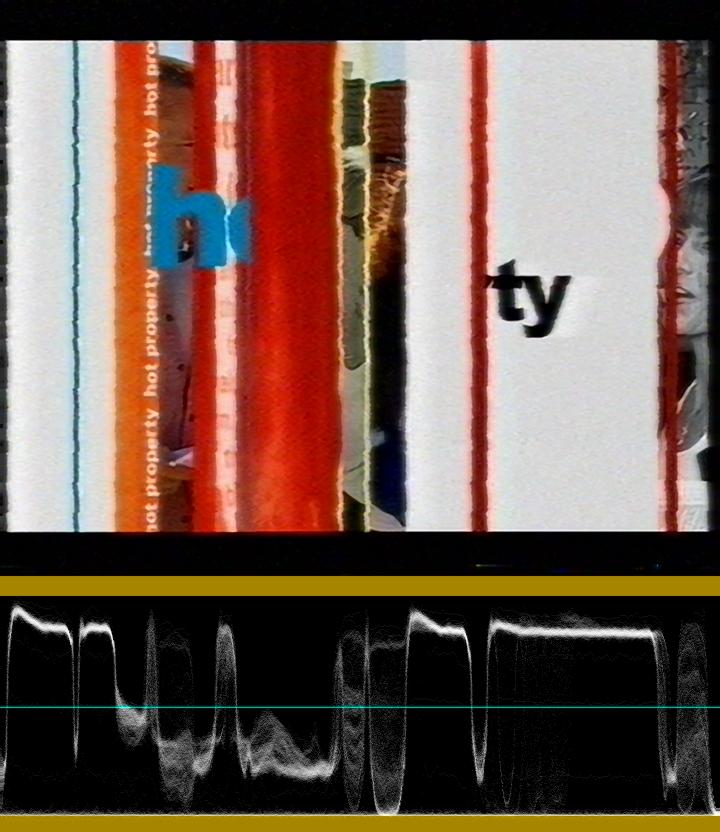

    Notice how there are oversharpening halos at the transitions from dark to bright or bright to dark. Some of the bright halos extend into the super brights. And at the other end there would have been some overshoots into super darks but your capture device has clipped them. After reducing those halos with dehalo_alpha(rx=6, ry=1, brightstr=0.9) you get:

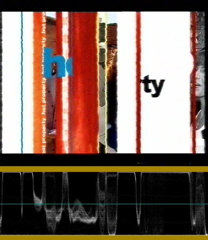

    Those sharp overshoots are very much reduced. My guess is the bright white areas were originally very close to Y=235, right below the top brown bar. And the darkest blacks were just above the bottom brown bar. The remaining humps at the left side of the peaks are probably another defect of the VHS deck, or possibly from multigeneration copying. So the original broadcast probably had levels more like:
    In a case like this you don't mind the peaks protruding into the brown bars because you are going to fix them later. Even if you don't plan on fixing them they are a defect that you don't care about, not a real detail of the image.
