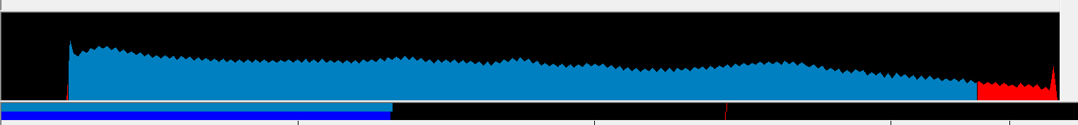

    Captured a 30-second sample. Audio is out by about a second right from the jump. Turning on the histogram, there's a touch of red to the left and a lot of red to the right, but it doesn't change based on what's displaying on the screen.
    I'm not sure it's supposed to be stationary, but I'm assuming the red areas are fixed with the proc amp controls on the AVT (which I don't have yet)? What do I do about the audio?
  5. Don't use any audio compression while capturing. Be sure to use a fast video compression codec like huffyuv. Don't use high compression codecs like Divx, x264vfw, etc. Play with the Capture -> Sync... options until you find something that works for your device. Often "Do not resync..." works best. Whenever possible capture to a drive that's not your boot drive.
    In my experience you have to turn off Video Preview for the histogram to work properly. You can usually adjust the capture device's proc amp controls to get proper levels. How you get at it varies but somewhere on the Video menu you will have access to them (Levels, Crossbar, etc.). Unfortunately, using the proc amp control that way you don't have a live preview or histogram so you have to go back and forth between adjusting the proc amp and viewing the image/histogram. A better option that works with most capture devices is to use GraphStudio to adjust the proc amp while viewing the preview/histogram in VirtualDub. In GraphStudio insert the capture module or crossbar (or whatever module has the proc amp controls) to the graph. Then right click on the module in the graph and select Properties to access the proc amp controls. Adjusting the proc amp there should leave you with a live preview/historgram in VirtualDub.
    Note that having a little of the histogram in the red region may not be a problem, especially if you are going to filter the video later. And at the low end sometimes the intrusion into the red is caused only by the black borders at the left and right edges of the frame. You don't really care about those.

    Adjust brightness and contrast to get all the histogram out of the red. The two controls are usually not completely independent. They usually work as an offset (shifting the whole histogram left or right) and a gain (stretching/compressing the histogram from left to right). Check a variety of scenes before settling on final settings. Again, some tapes/decks will have very dark bars at the left and right, much darker than the main image. In that case you can let the histogram into the red at the left. I wouldn't worry about what happens to the histogram during FF/RW -- automatic gain controls in the VHS deck may go bonkers then.

    Regardless of what I set brightness to, the red on the left doesn't really change. In that situation, I assume just dropping the brightness until there's less red on the right is the solution?

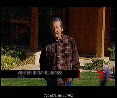

  10. No, I was capturing via line in, as the guide says to. Changed it, and now I can get the video and the histogram to display at the same time, and audio preview works as well, although if I have that on it drops a ton of frames. And if I have the video set to 'preview' I can get both it and the histogram, but it disappears when I start a capture. Sync in that case looked okay. But if I set the video to 'overlay', freezing the histogram and making video visible during capture, it seems to get a tiny bit out of sync (attached a sample).
    Set it back to preview, to see if that was also slightly out of sync...and now it's just capturing audio.
    Still appears like the title screen is too bright, looking at this (also, I can't pause it because this VCR doesn't have that function)?
Name:	Screenshot 2016-02-23 03.43.30.png

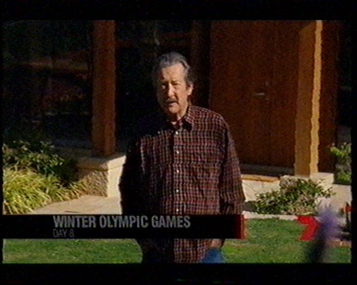

  11. Sync2's audio is about 250 ms early. The darks look overly dark in that shot. They're not crushed though so maybe it's just that shot.
    Now the bad news: you really need a line TBC to straighten up all the vertical edges. Notice how crooked the post at the right in the background is:
    And it changes with every field/frame. You could use an old Panasonic DVD recorder in passthrough mode for that. See this post for examples:
    https://forum.videohelp.com/threads/319420-Who-uses-a-DVD-recorder-as-a-line-TBC-and-what-do-you-use

    A histogram like that indicates that the capture device is clipping blacker-than-black rather than capturing it, so you'll never see dark values in red (besides that sliver). I suppose this is typical with PAL captures, since a 0 IRE system doesn't have superblacks.
    To ensure no black crush, you'll need to raise the Brightness until it's obvious nothing is being lost at all (there should be a larger gap to the left) and then gradually lower it.

  19. Often a sharp drop at the left (dark) end of the histogram indicates some pixels should have been darker but they were "crushed". For example, the light blue in this image represents the left end of the histogram you might get from a video:
    The dark blue indicates where darker pixels in the video should have fallen but some processing has crushed them up to that big peak in the light blue histogram. So if that big peak is at Y=16, something in the processing has caused values less than 16 to have the value 16.
    Note that the rec.601 spec defines Y=16 as as full black and there aren't supposed to be Y values less than that -- so some programs will automatically change pixels with Y below 16 to Y equals 16. That can also happen when video is converted to RGB (all values below Y=16 are converted to the same shade of RGB black, R=G=B=0) then back to YUV (Y=16).
    Similar effects can sometimes be seen at the right (bright) end of the historgram where Y=235 is defined as full white and values above that may be crushed.

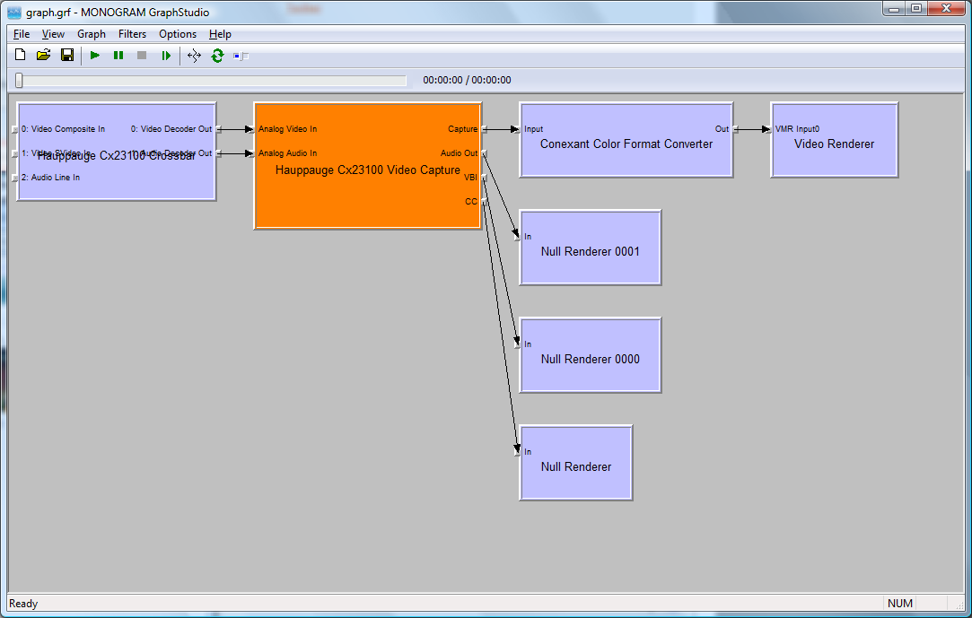

  22. Can you give more specific directions? I've gone into Graph Studio, added the Live2 as a filter, and saved the graph. Then an AVISynth script:
    DirectShowSource("graph.GRF")
    TurnRight().Histogram().TurnLeft()
    But I get an error if I try to open that in MPC, saying only 1 stream is supported for GRF files, one of Audio or Video must be disabled.
    And even if that worked, I'm not sure what the next step is? Leave it in MPC, fiddle with the proc amp settings in graph studio and MPC would update live? Or something else?
  23. You need to connect all unused output pins to the Null Renderer. Leave just the video capture pin open. You can then open the AVS script in any program that opens AVS scripts. Media players, VirtualDub, etc.
    But first, make sure you have the right capture filter. Right click on the video capture pin and select Render Pin. Then press the play button in GraphEdit and verify you get a live picture. You may have to piece together more components like a crossbar filter.

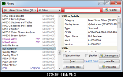

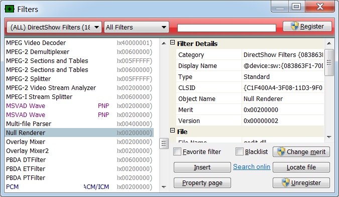

  24. "Null Renderer"?
  25. Yes, Null Renderer:
  26. Ah, righto. There's no "all" option for me, but I found it in the DirectShow Filters category. Still gives the error about only allowing one stream when I play the AVS, and when I do the render thing I just get a black window. Not sure what to do with the crossbar? I tried connecting it the only way it would seem to work, still getting the one-stream error and black render screen. Attached a screenshot of what I'm doing.

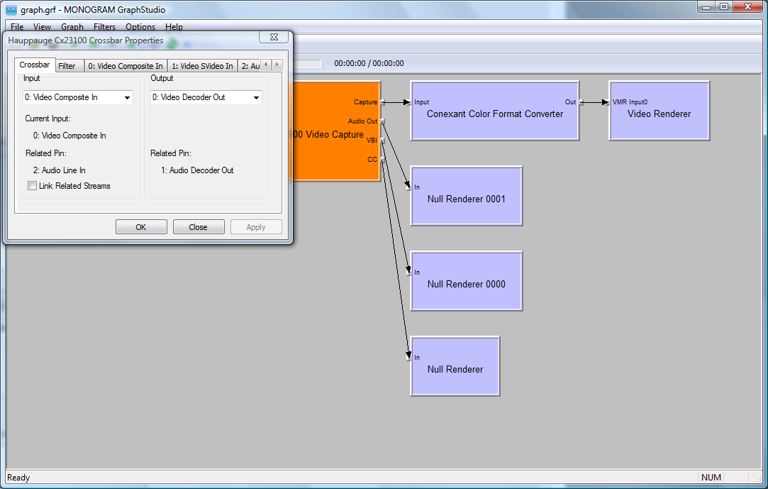

  27. Configure the Crossbar or Capture (depends on device) filter to take input from the correct source (composite, s-video, etc.). You should then see the live picture when you play the graph. Before saving the graph for use in AviSynth remove the Video Renderer and (probably) the Conexant Color Format Converter. That leaves the video Capture pin available for DirectShowSource() to connect to.
  28. Formerly 'vaporeon800' Brad's Avatar
    Apr 2001
    Vancouver, Canada
    I've never had to add Null Renderer. I think my solution was adding audio=false to DirectShowSource.
  29. The Capture only contains 'analog video in', the Crossbar appears to be set up correctly (the VCR I'm using right now doesn't have S-Video):
Name:	Screenshot 2016-02-24 23.28.52.png
