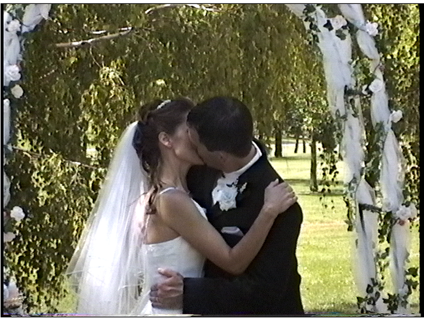

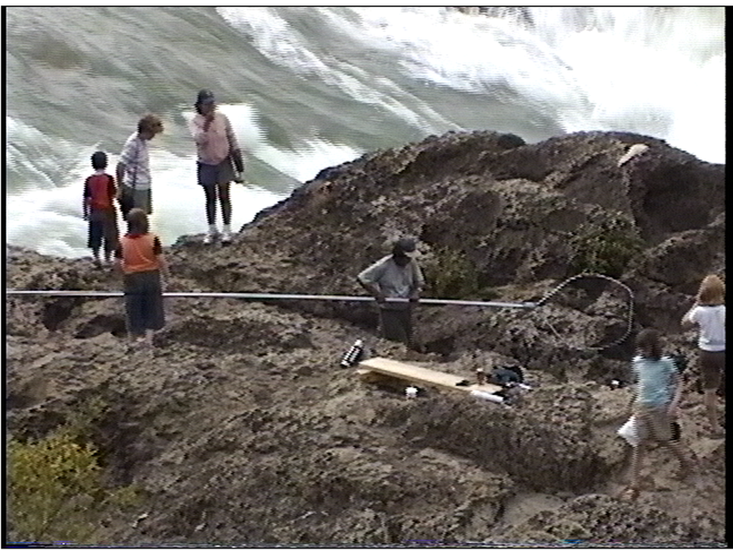

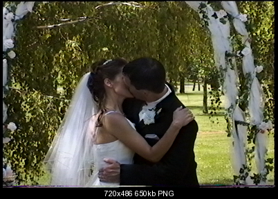

    As you can see, the camcorder's DV output and the first lossless capture have raised blacks and blown-out brights.
    I've included two video samples. It's the same portion of the tape as the first image set. I can add more videos if desired, but I think these tell the story fairly well.

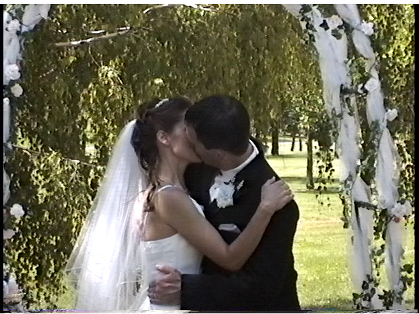

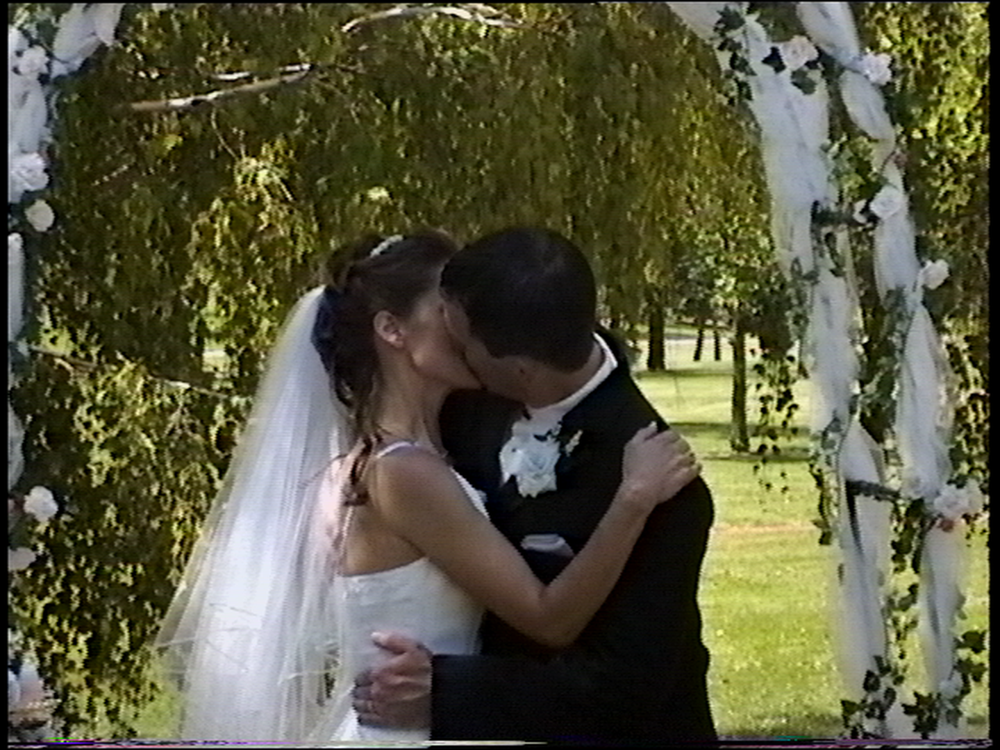

    The DV cap is losing a bit of fine detail. Even after running noise reduction filters like TemporalDegrain() there's more detail in the UT cap.

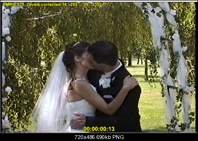

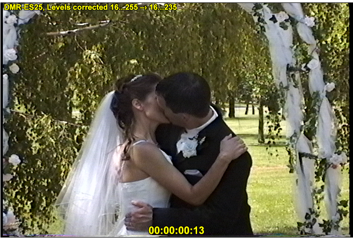

    After a levels correction recovering the superbrights (235...255), I find that the DMR Capture is not really missing any details for the first scene (same for the DV cap), actually the third cap seems a little too dark (there is no white, the brightest value is at about 235, whereas it should be 255 for a PNG screenshot).
    So I applied a Levels correction of 16...255 to 16...235 to the DMR-ES25 capture, comparing it to the third capture (NHX-E2) using your PNG screenshot.
ID:	35582Click image for larger version
Name:	Wedding P - 13-30 - NHX-E2.png
    AVISource("DV vs lossless - Wedding P 13-30 - DMR-ES25.avi")
    ConvertToYV24().AddBorders(1,0,0,0,color_white).Crop(0,0,-1,-0) # Match DV horizontal framing
    SmoothLevels(16,1,255, 16,235, Chroma=0, HQ=True)
    ConvertToRGB()
    Subtitle("DMR-ES25, Levels corrected 16...255 –› 16...235")
    ShowSMPTE()
    Addborders(0,5,0,1, color_white) #486
    Now the ES-25 doesn't seem to be missing any details in the brights anymore (at least in this scene).
    However, the second scene might be better suited to judge this ultimately (raw sample needed^^).

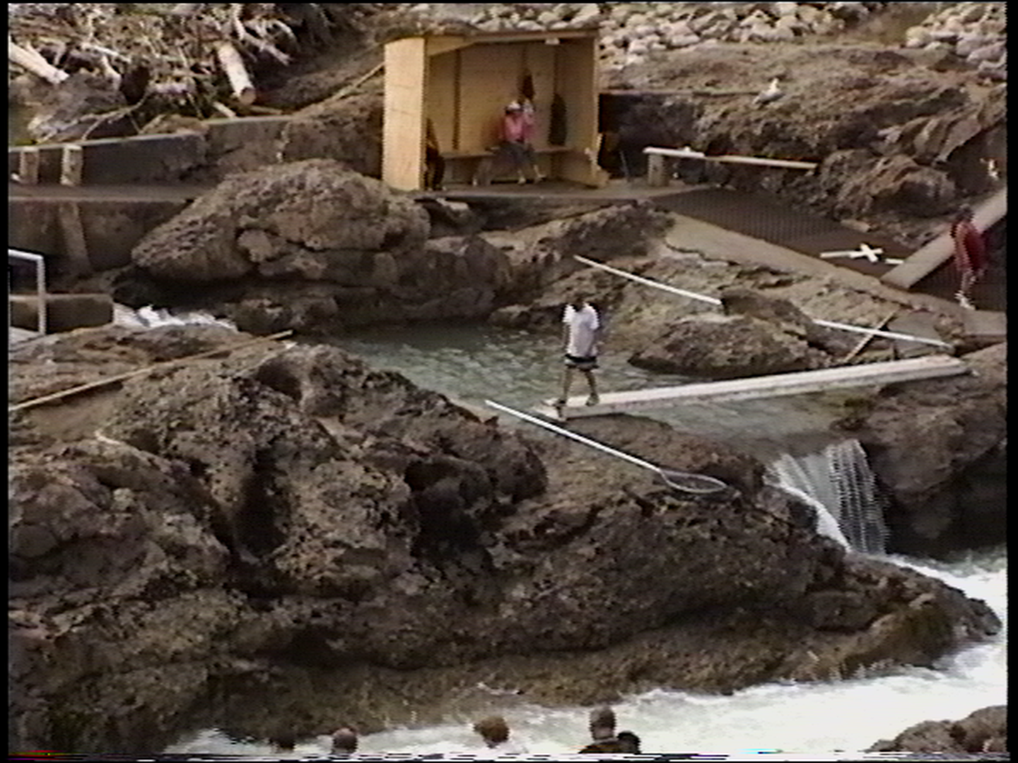

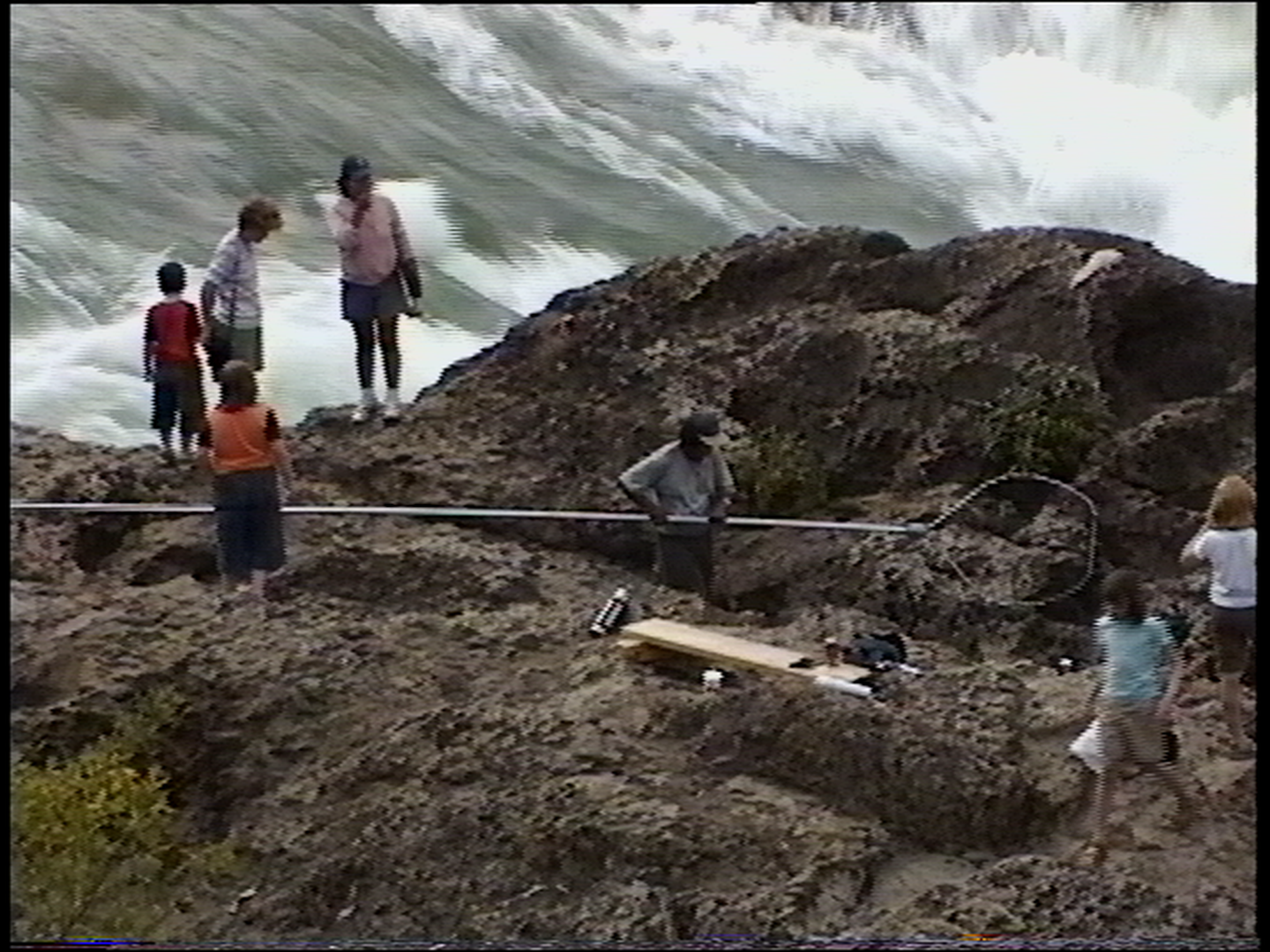

    I've attached samples of this scene ("24:32") to the OP now. The levels in the NHX-E2 recapture were in range during the wedding portion, but here they're a little over. It doesn't really matter; ultimately, none of the three methods grabs discernibly more bright detail than its competitors.

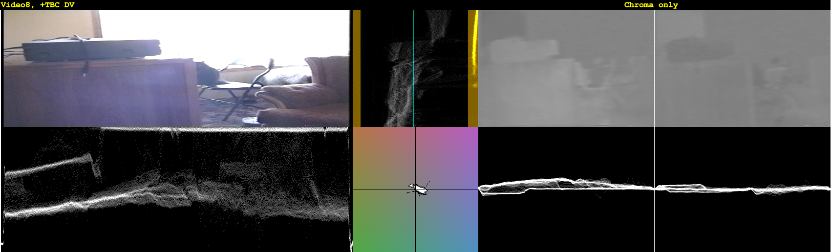

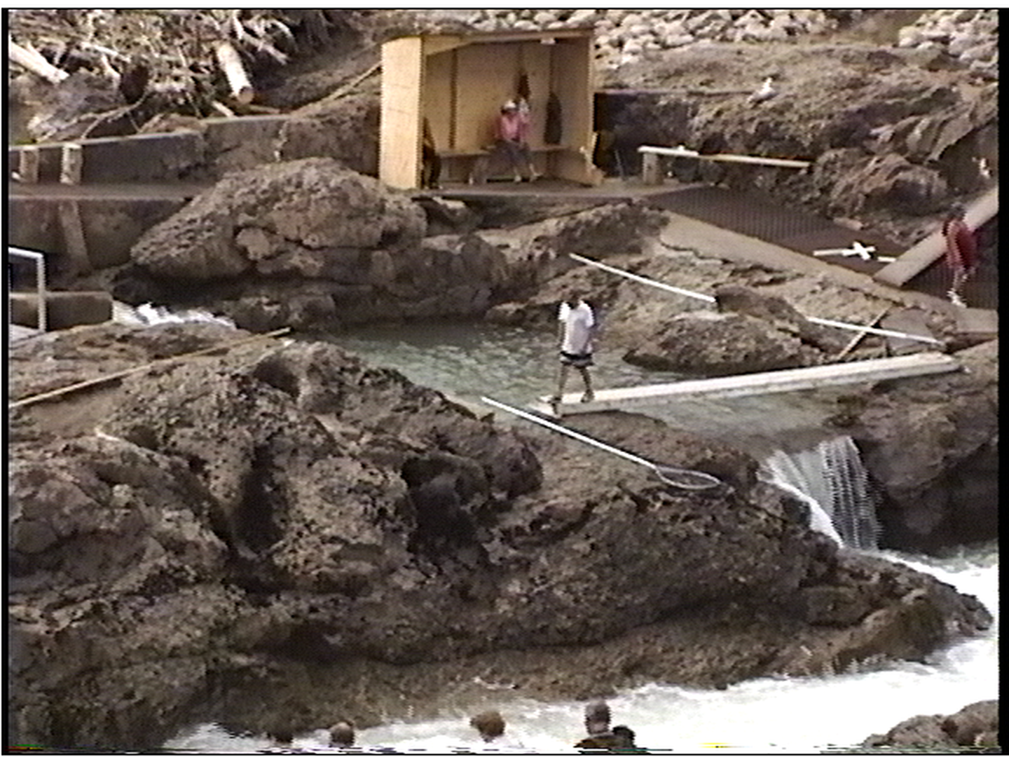

    The playback camcorder seems to be to blame for this. Here's a field from a Video8 tape that I had captured earlier. With TBC Off, there is a little less clipping. But it's clear that the analog output always goes through a digitization stage regardless (chroma is always DNR'd, and hard borders are masked onto both sides). Perhaps a non-TBC Hi8 player would reveal a little more at the upper end.
Name:	2002 Video8 living room - 01 +TBC DV.png
ID:	35587 Click image for larger version
Name:	2002 Video8 living room - 02 +TBC ES25.png
Name:	2002 Video8 living room - 03 -TBC DV.png
ID:	35589 Click image for larger version
Name:	2002 Video8 living room - 04 -TBC ES25.png

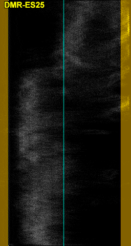

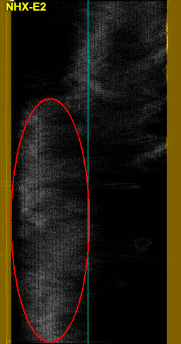

    I agree, so far there isn't more detail captured in the brights in any of the three.

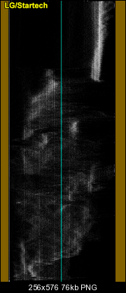

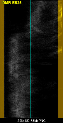

    One thing that would bother me is the (albeit slight) posterization in the NHX-E2 cap. It's not visible to the eye in the samples because these are bright scenes; and even in dark scenes there is probably enough noise to mask it, but it's there.
ID:	35613 Click image for larger version
    One could say the NHX-E2 capture is not using full 8 Bits per channel.
    I found that this happens with most capture devices if you put their "Proc-Amp" settings on anything other than the default.
    It seems that these settings do not affect the levels during the analog-digital conversion but rather after (which renders them pretty useless because you cannot recover any clipped brights this way; only squeeze, expand and shift what you already have). Actually the only capture hardware I know of where the Proc-Amp settings actually do affect the levels during ADC is the Canopus NX.

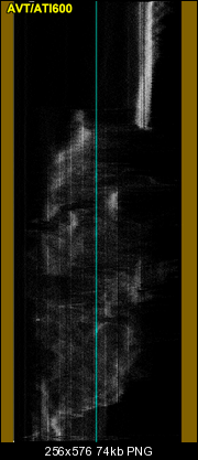

    It's a combination of a few different scopes in Avisynth, using a script I hacked together. I've posted it before, but not the current version, which I've attached. If the input video is any width other than 720, one of the text labels will be misaligned.

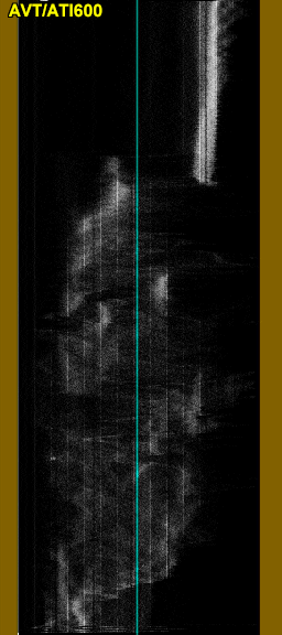

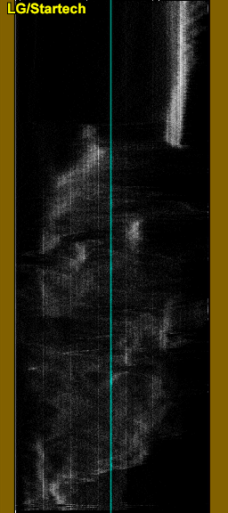

    Mar 2015
    Europe
    Interesting, as soon as I have time I will upload some samples using my LG HDD DVD Recorder RH199HS ( accepts firewire /svideo/composite and output almost everything from any of the inputs , Hdmi (720(1440)x576i, 720x576p, 1280x720p, or 1920x1080i ) component I or P , scart RGB, svideo or composite )
    The LG HDD/ DVD recorder is a 2006 device probably one of the best LG dvd recorders I think only sold in Europe and probably Asia with one of the news LSI chips (IC 1101 DMN8653 LSI) and a Philips 7137d a/v decoder . I will try the captures/ transfers with this device from svideo or firewire outputs from a digital8 camcorder playing a video8 tape and will do the transfer via hdmi 576i (PAL) through an startech usb3hdcap to compare with a direct capture from a Ati hd 600 usb or an Osprey 210e

  18. Member
    Mar 2015
    Europe
    Yes it as . I sometimes use it instead of the avt 8710 as a svideo pass through. It stabilizes the video and there are no drop frames any more .In terms of characteristics is very similar to the Panasonic DMR-EH65 , however the internal circuitry of both and final results I don’t know.
    Well, use of the camcorder ADC to do the A/D conversion , transfer the DV output to the dvd recorder, transcode internally and after record the hdmi stream is a sort of esoteric workflow more a “proof of concept”. Pal DV is 4.2.0 and svideo is 4.2.2 at the very least I will be loosing in terms of colour sub-sampling . Even so I am interested to see if the dvd recorder is able to improve or not the process.
    However the only workflow with interest will be the camcorder digital8 / svhs deck running analog tape- svideo – Dvd recorder – Hdmi576i – startech usb3hdcap/black magic shuttle/4k – virtualdub – Avi /Huufyuv and analyze results with the ones from established workflow and capture cards .

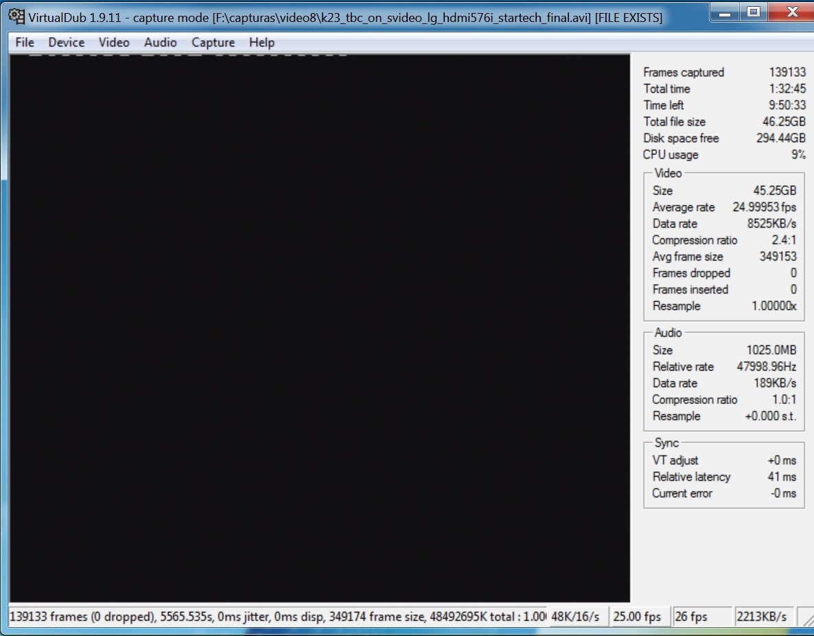

    workflow 1
    Digital8 camcorder sony DCR-TRV238E tbc on, nr off - video8 Pal tape
    LG HDD DVD recorder RH199HS set to hdmi 576i (PAL)
    Startech usb3hdcap
    camcorder->svideo->LG DvD rec -> Hdmi-> usb3hdcap->Vdub -> Huufyuv
    workflow 2
    Digital8 camcorder sony DCR-TRV238E tbc on, nr off- video8 Pal tape
    AVT 8710
    ATi Hd 600 usb
    Camcorder -> svideo-> AVBT-8710-> ATi 600 usb -> Vdub -> Huufyuv

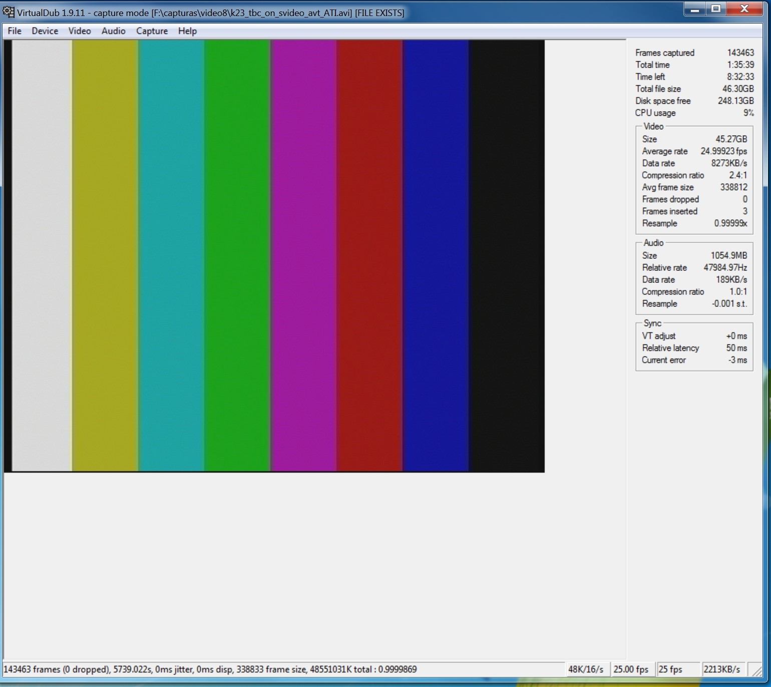

    the video8 tape is a 23/24 years old tape not in a particular good shape due to have been extensively played
    In the ati capture the three frames inserted as been due to the cancorder activation hiccup, this situation didnīt occurred in the LG workflow
Name:	Dvd Recorder.jpg

  22. Member Skiller's Avatar
    Oct 2013
    Germany
    Yeah, there's still jitter in both samples but since there is no perfect static part in it (like a date code for example), the right black border is my only orientation in terms of jitter.
    But what's overwhelming here is: both differ greatly in contrast and color (ATI600 cap has a green tint – I suspect the AVT 8710 TBC is the cause of that).
    Both caps have banding issues which the histogram reveals (AVT/ATI600 cap is worse here).
ID:	35648 Click image for larger version

  23. Originally Posted by FLP437 View Post
    Ok, can the horizontal jitter be tracking cancorder issues?
    The horizontal jitter is a result of the heads of the VCR spinning faster and slower with time. This is common to all consumer analog video tape formats. You need a line TBC to reduce it.
    There is any evidence of benefit related to chroma , noise ,.. due to dvd recorder filter function in the specific workflow?
    The ATI cap has less contrast, less saturation, and more noise. But you can probably adjust that with the proc amp controls. The chroma channels are 1 or 2 units higher too. That could be adjusted in post without any loss (ColorYUV(off_u=1, off_v=1) but it's not clear which cap is correct. It also has some mild vertical stripes in the luma channel (most visible in the sky).
