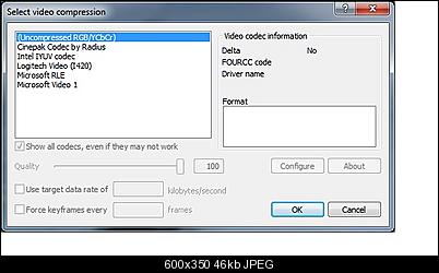

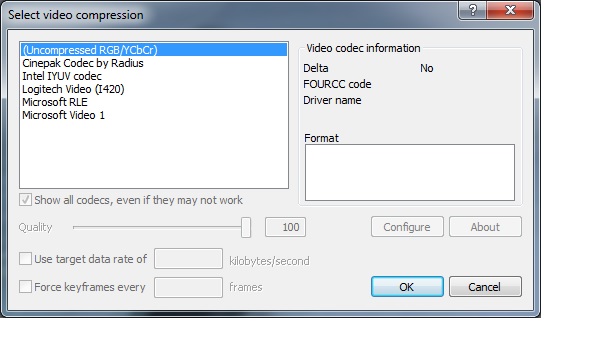

    Yet when I drop a simple DV.avi file onto VD ( ..... full processing mode selected) ... when I look under codecs all I see are:

  3. I have downloaded new copy of VD ........... still the same .....
    The Utility confuses me even more.. (files attached)
    It seems to confirm that for example the one we discussed separately Grass Valley HQX is installed ...... but not listed in VD
    I have just downloaded again .... Cedocia, HQX, Lagartith & Huffy .... all finish install without errors .. and show under Window codec check.
    And all codecs that I have used in VD in the past
    But still don't show in VD ?

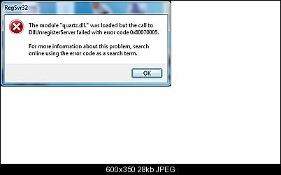

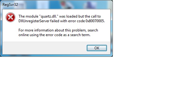

    I Googled and found some information that VD needs quartz.dll to be able to use codecs ... I tried deregister & register of quartz ... but I get error:
Name:	quartz error.jpg
    Any suggestions ... or do I need to remove all traces of VD clean registry and start again ....

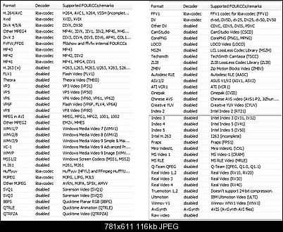

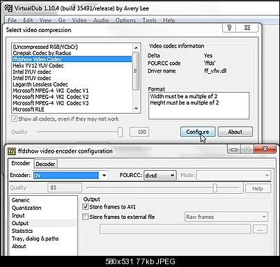

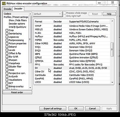

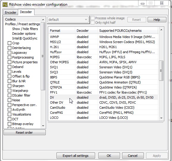

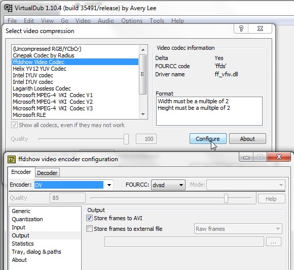

    Jagabo correctly pointed out that VirtualDub uses VFW codecs and your msinfo shows that the video uses DV codec (DSVD) Make sure under FFDshow VFW (green icon) configuration that DV is not disabled.
Name:	ScreenHunter_189 Feb. 07 07.34.jpg
    This will allow you to VIEW the video but if you want to ENCODE with DVSD then make sure FFDshow ENCODER is set to that codec in VFW codecs and select it in Virtualdub and configure in ffdshow.

  8. Originally Posted by Tafflad View Post
    The error code in your post possibly suggests a 'permissions' error. The thread HERE is for Vista, but the principle should still apply (there is a Win7 reference in a post near the end). I don't think your installed VFW codecs will appear in Vdub unless there is a registered version of Quartz.dll installed?....

  10. OK ... ref post #7 DV was 'disabled' fixed that .... but no change still codecs not showing.
    This is so frustrating as it previously all worked fine.
    I have just to be sure reinstalled 32bit Cedocia 'after' enabling DV ... but still no change.
    Neither Cedocia nor HQX appear in the list.
    Anything else need enabling in VFW ... it currently shows:

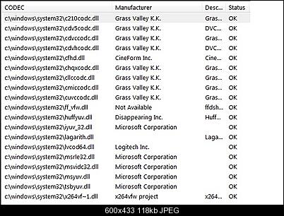

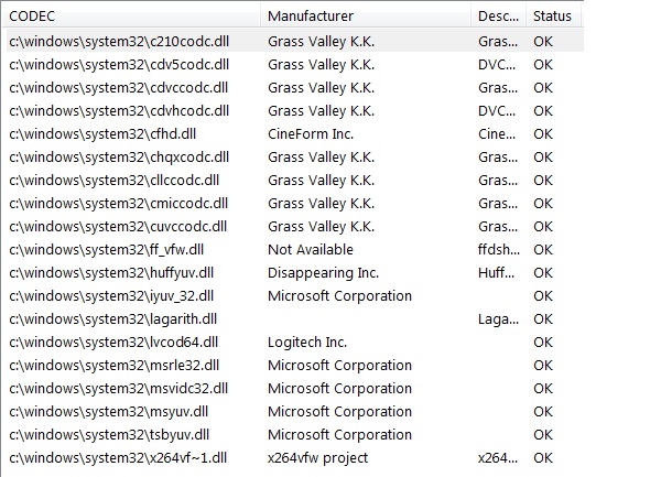

  16. Here is attached list of codecs from NIRSOFT report for my PC ..... seems to show all codecs are present.
    Not sure if things are correct ........ Lagarith downloaded from this site gives no choice of 32 bit or 64 bit ....
    It has installed in sytem32 so would that work with 32 bit VD ?
    I have also downloaded Huffy from this site ... the 32bit version.
    I right click on .inf file to install ..... a very fast popup window appears & disappears (too fast to read) but no error
    Neither of these show as being installed in SysWow64 ??
    Huffy does not show at all (unless it is know by other name)

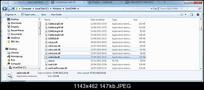

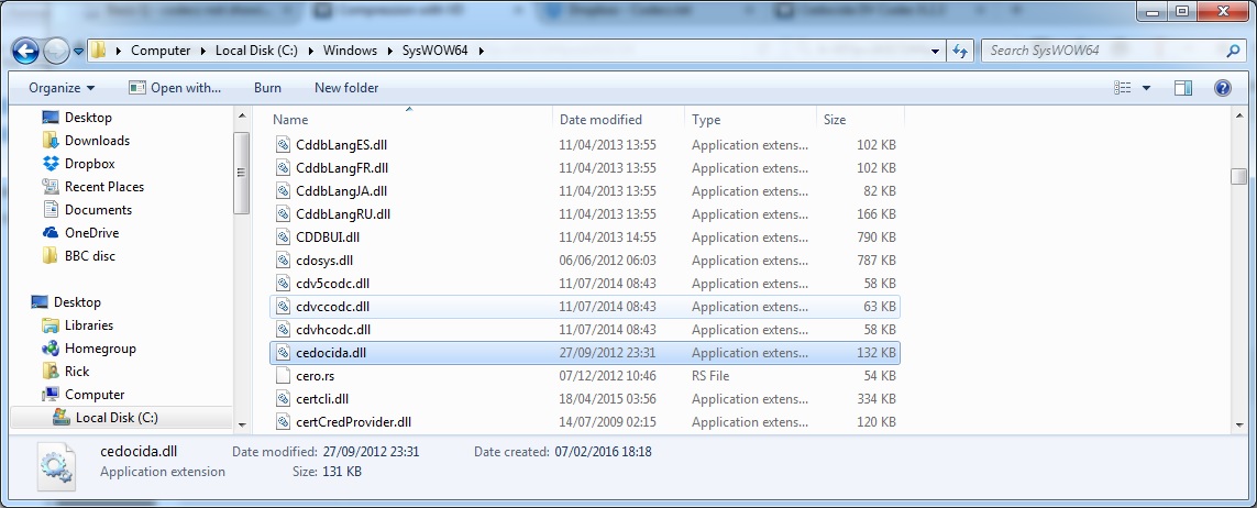

  18. This is where I get lost .... I downloaded Cedocia from this site ... there is only one link ... no 32 or 64 bit version.
    There are instructions .. and they say explicity:
    "For installing Cedocida DV, DVCPRO25 and DVCPRO50 Codec (caution: your current installed DV/DVCPRO25/DVCPRO50 codecs will be replaced):
    ==> right click on "cedocida.inf" and select install"
    That is exactly what I did.
    I went and checked and there is a cedocida.dll in both system32 and SysWOW64 so it has installed in both
    you can see file here is SysWOW64:

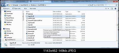

    Lagarith again downloaded file from here .. a single file option, no 32 or 64 bit.
    It arrive as an exe and when you run it it installs with no options where to put it.

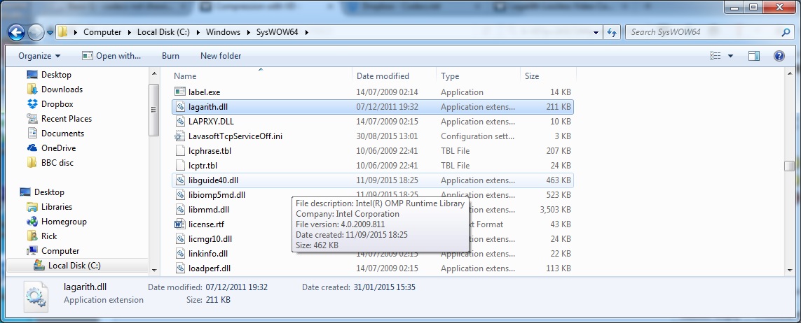

    Again it shows in SysWOW64 where you advise it should be:
    So I'm lost here when you say they need to go in SysWOW64 .... there is no choice where to put them during install, and in any event that is where they are.

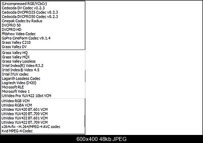

  19. Fixed it .... well so far looks like it.
    Using the Nirsoft Installed Codec tool, I could simply disable & re-enable codecs without resorting to regedit.
    There was a post on Doom9 I was pointed to for a similar issue and they found that vidc codecs were to blame.
    I disabled all the vidc codecs and .... success all the expected codecs reappeared in VD.
    (so they must have been installed correctly after all)
    By a process of elimination found out that it was codec VIDC.RTV1 as soon as I disabled that .. all is fine (so far at least)
    I have an MSI graphics card and this is an MSI afteburner codec, maybe it is faulty or it got installed it an update.

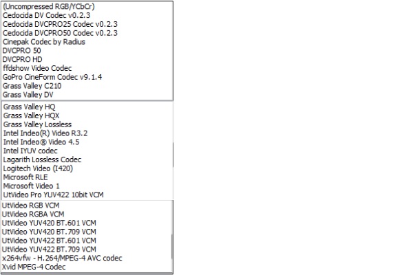

    Now VD shows:
