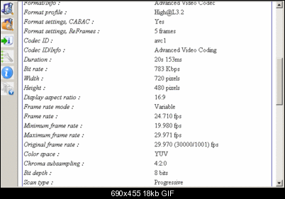

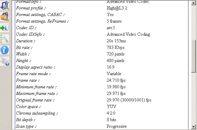

    But no, not necessarily. You'd probably want to use "original frame rate" but that's not always shown and I've no idea where MediaInfo gets that info from.

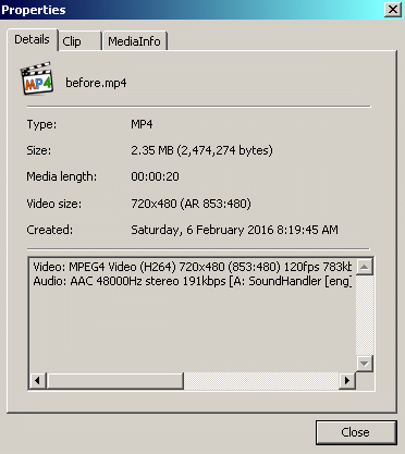

    Edit: That's odd. I just noticed MPC-HC is reporting the wrong frame rate too, which is unusual, although I think it's playing at the correct speed.
