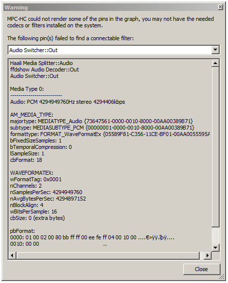

  7. Originally Posted by Baldrick View Post
    Have you tried just remux them(no video reconversion)? In xmedia recode choose Format MP4 under Video -> Mode -> Copy and Audio -> Mode -> Copy.
    I get a playback error and no audio.

  9. Originally Posted by Baldrick View Post
    If I have XMedia Recode convert the audio to AAC as MKVtoMP4 does, then the .mp4 plays with its audio.
