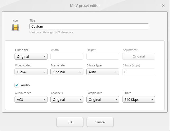

  1. If I convert Blu-ray film to MKV h.264 format and I set the size 16000 MB ? (additional information about what settings I use attached).
    Whether in this case the best One pass or Two pass? The file size I choose for yourself , and it is less than 18000 mb. I want the best quality, the size of 16000 mb
    I watch movies in Full HD screen. I use Freemake Video converter program.

    US
    1 Pass = Faster but worse quality and bitrate inefficient
    2 Pass = Better Quality for the file size
    Considering you seem to be new to video conversion, I would suggest Handbrake, Vidcoder, or any program that uses x264 and gives you control over its settings. Instead of Freemake Video converter which is not designed for quality.
  3. Yeah but Freemake is very easy to use.
    So, this two pass is the best way if you want the best quality for file size ?

    Handbrake is also pretty easy, just use the simple x264 presets options. There are better quality options out there than freemake.
    Inside freemake yes.
