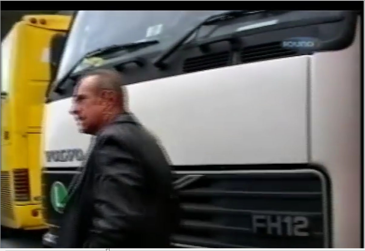

  1. Originally Posted by DB83 View Post
    Now I have not done this for a long time and youtube, as I said earlier, is somewhat different now, but I link to a clip which, in the best Blue Peter tradition, (you will have to be a Brit to understand this) I made a little earlier.
    Certainly the original capture was interlaced @ 720*576 mpeg2. I can not think I would have exported from the Ulead editor (after the enhancement) in to anything else. Unfortunately can not put my hands right now on the original.
    https://www.youtube.com/watch?v=3HOmtVAFEGs
    Sadly, I don't have a Blue Peter Badge ... I'm not one of the chosen few.....
    The Quo You Tube clip downloads as a very strange item..... a progressive mp4, with frame dimensions of 600 x 480 (5:4) -- and a variable frame rate! ... Oh, and a constant bit rate.. Goodness knows what You Tube did to the original to arrive at that....
    Could be the mediainfo file that is up the creek I suppose?....
    Edit: ... No, it's definitely 600 x 480 and You Tube have made a pig's ear of de-interlacing it. (See attached frame capture).
    I'm not surprised they don't want interlaced footage!

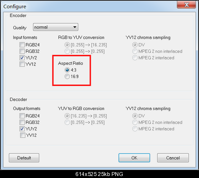

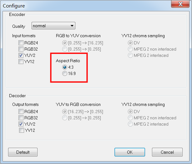

    "You didn't flag the SAR or DAR in the codec "
    ... is this a setting in VD ?
    AVI doesn't really support SAR/DAR flags. The DV stream in an AVI does have an AR flag and most editors/converters/players recognize the flag. You set the DAR flag in the DV encoder's settings, cedocida for example:
    Some other codecs support it but programs may not respect it. This is why everyone keeps saying you should resize to square pixels if you can't control the downstream processing and playback environment.
