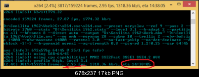

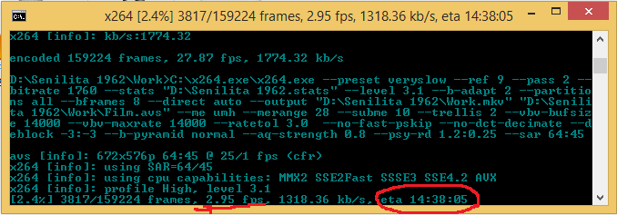

    Hello!
    I'm new in encoding by x264 CLI, I have tried many parameters to encode with 2 pass but I've failed. All the time I got this after the first pass
    Although I don't put "--slow-firstpass" I get a very slow speed in the second pass about 1fps- 2 and this is a screenshot
    My parameters are :
    C:\x264.exe\x264.exe --preset veryslow --ref 16 --pass 1 --bitrate 2000 --stats "H:\Movies\The Rise and Rise of Michael Rimmer -1970.aldo.CG.stats" --level 3.1 --b-adapt 2 --partitions all --bframes 8 --direct auto --output NUL "H:\Movies\The Rise and Rise of Michael Rimmer -1970.aldo.CG\Work\Encode.avs" --me umh --merange 28 --subme 10 --trellis 2 --vbv-bufsize 14000 --vbv-maxrate 14000 --ratetol 3.0 --no-fast-pskip --no-dct-decimate --deblock -2:-2 --b-pyramid normal --aq-strength 0.8 --psy-rd 1.2:0.25
    C:\x264.exe\x264.exe --preset veryslow --ref 16 --pass 2 --bitrate 2000 --stats "H:\Movies\The Rise and Rise of Michael Rimmer -1970.aldo.CG.stats" --level 3.1 --b-adapt 2 --partitions all --bframes 8 --direct auto --output "H:\Movies.mkv" "H:\Movies\The Rise and Rise of Michael Rimmer -1970.aldo.CG\Work\Encode.avs" --me umh --merange 28 --subme 10 --trellis 2 --vbv-bufsize 14000 --vbv-maxrate 14000 --ratetol 3.0 --no-fast-pskip --no-dct-decimate --deblock -2:-2 --b-pyramid normal --aq-strength 0.8 --psy-rd 1.2:0.25 --sar 64:45
    pause
    Thanks in advance

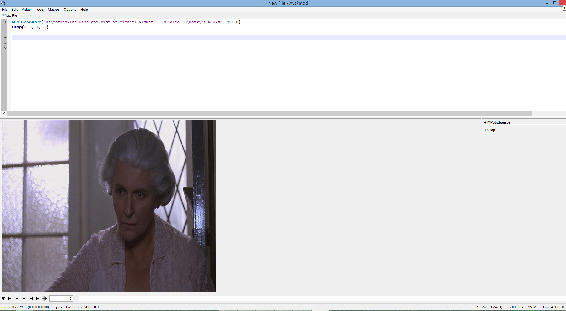

  2. What is your CPU? Is the speed limited by your avs script? Benchmark the script without encoding, i.e.:
    avs2pipemod.exe -benchmark "script.avs"
  3. Member TeNSoR's Avatar
    Mar 2014
    Hungary, Debrecen

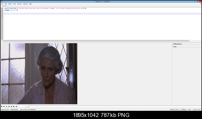

    It's intel icore7. my script has no filters at all because the source is PAL "progressive" just I put d2v and cropped it.

  24. Originally Posted by TeNSoR View Post
