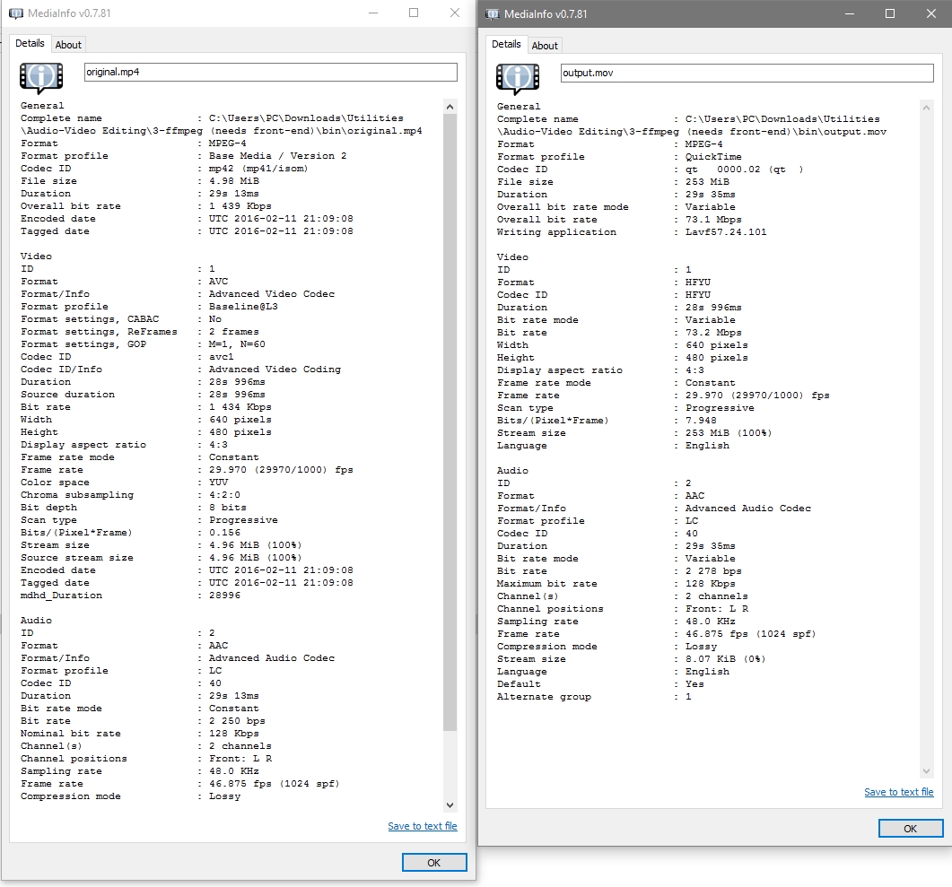

  24. I'm not an expert by any stretch of the imagination so be gentle with any responses. So have you tried this?
    ffmpeg -i original.mp4 -vcodec huffyuv output.mov
    Compare my original file with the output file:

    I just did another test using an 18,000KB .mp4 and the conversion turned it into a 1.18GB .mov with a bitrate of 349MBs.
    You wanted big; yes?
