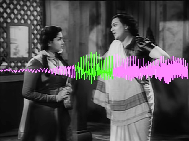

  5. Like redwudz mentioned, MPC-HC can be used for this. To fine tune the delay I use AviSynth's AudioGraph filter in an Avisynth script to synch the audio (using a sharp noise, like a punch to the chin or gunshot or something) with the video:
    A=AviSource("MovieFinal.avi").ConvertToYUY2()
    B=WAVSource("MovieFinal.wav")
    AudioDub(A,B)
    #B=B.DelayAudio(-0.12)
    AudioGraph(2)####number of frames on either side to display audio (5 video frames worth of audio in this example)
