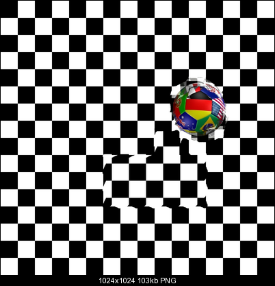

    Thanks for that. It works well for that black background. But on a similar test video with a checkerboard background it sometimes gives really ugly errors. Artifacts around the ball are expected but note the disturbance of the checkerboard pattern below and to the left of the ball:
    I guess I'll have to play around with the settings some more.

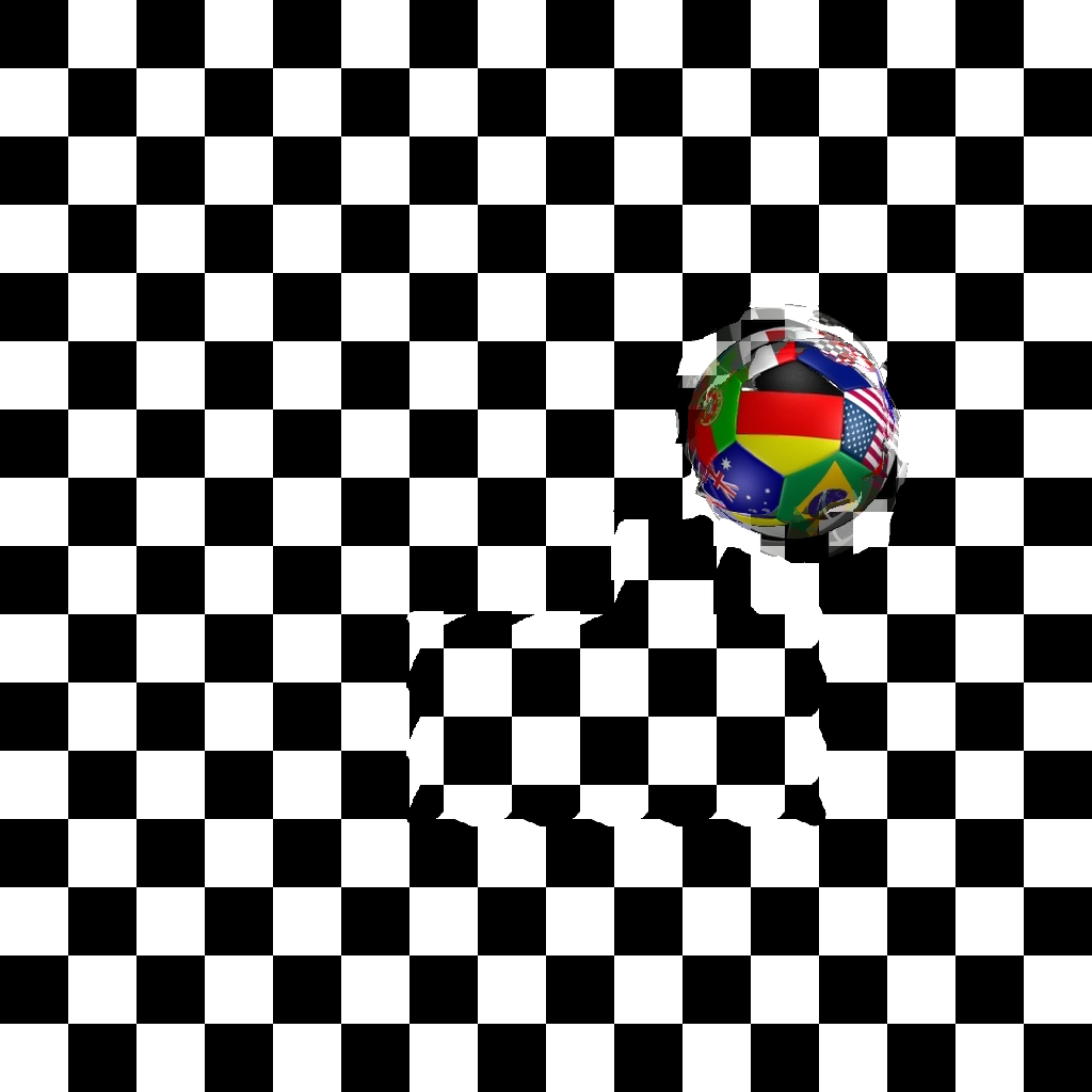

  16. I haven't been able to find any combination of settings that get rid of the type of artifacts seen in post 13. If anyone want's to try:
    function circular(clip bg, clip ovr, clip bmask, int ang)
    	x = int(cos(ang*1*3.14159/360.0) * bg.height/4)
    	y = int(sin(ang*1*3.14159/360.0) * bg.height/4)
    	Overlay(bg, ovr, bg.width/2-ovr.width/2+x, bg.height/2-ovr.height/2+y, mask=bmask)
    bg = BlankClip(width=64, height=64, fps=15, pixel_type="YV12", length=73)
    bg = StackVertical(StackHorizontal(bg, bg.Invert()), StackHorizontal(bg.Invert(), bg))
    bg = StackVertical(StackHorizontal(bg, bg), StackHorizontal(bg,bg))
    ovr = ImageSource("ball.png", start=0, end=72, fps=15).ConvertToYV12(matrix="PC.601")
    bmask = ovr.ColorYUV(off_y=-1).ColorYUV(gain_y=100000)
    Animate(0,360, "circular", bg,ovr,bmask,0, bg,ovr,bmask,7200)
    SmoothFPS2_modified(last, 1) # or whatever you want
    Oh, I modified the ball image a bit to get rid of black pixels within the ball (so only the background is transparent in the generated mask). New image:

  17. 1. I duplicated the problems with SVPFlow that you posted in your original example (black background). MVTools2 version worked correctly.
    2. I then copy/pasted poison's code and used it, and it worked.
    3. I went back to your SVPFlow code, and suddenly it too was working. I was so puzzled by this that I started over from scratch, extracting the files from your original zip, and couldn't get it to fail again. It appears as though something is being retained in memory.
    As for your checkerboard pattern, I reduced your example and tried it not only with the various SVPFlow and MVTools2 scripts you posted, but also with a much simpler one that is basically straight from the MVTools2 documentation.
    My conclusion: you have created a "pathological case," something that would almost never happen in the real world. Motion estimation has a huge problem with background objects which get revealed as something in the foreground moves in front of them. The higher the contrast between the moving foreground object and the background, the worse the problem. By using a pure white/black checkerboard, and then moving the ball "in front" of it, you have created a true torture test that, I think, ANY motion estimation software would fail. You could try it on AE, Twixtor, Motionperfect, etc. and I think they'll all show the same thing. I doubt very much you'll find any combination of settings that will make things any better.
    Of course you could take the results from your "ball on black background" and then overlay that onto the checkerboard and get a perfect result, but that would be cheating
    [edit] I was not able to duplicate that strange distortion in the PNG you posted, where the checkerboard was distorted a long way from the ball.

  18. I think jagabo is specifically referring to the large displaced artifacts way way out of the motion path . You don't get those with the other mvtools2 variants, only the typical "edge morphing" localized artifacts. I can't figure it out either , and even went so far as to try a few older svpflow versions - and they all seem have that problem, despite trying a variety of settings. And if you reduce the artifacts with various, it starts to skip frames (duplicates) like the initial problem. Even using the MV's to plug into vanilla mvtools2 demonstrates the problem, so the problem is likely with svpflow's MV's
    All motion estimations algorithms do fail to an extent (at least with the localized edge "morphing", not the large displaced artifacts in svpflow), if run in "automatic" mode. But the "pro" versions typically require some additional inputs like motion tracking, mattes to guide the motion estimation to improve the results . And they do work quite cleanly for things like this because it's 1 object, no axial rotation, no deformation (a real "ball" would deform as it bounces, and spin), no motion blur, no noise, no compression artifacts etc... It's really a textbook case
  19. Originally Posted by poisondeathray View Post
    I think jagabo is specifically referring to the large displaced artifacts way way out of the motion path.
    Yes, I expect to see distortions right around the moving ball. It's the distortions hundreds of pixels away that I'm referring to. With different settings I get them on different frames and in different locations. But nothing I tried was able to eliminate them completely. Apparently the filter is occasionally mis-matching the repetitive background and interpreting that as motion. When you see it frame by frame it's obvious that that area of pixels is moving to the right and down by one background block (in the image shown it's moved half way). On a background without a repetitive pattern (for example, using an enlarged version of the ball as the background) it didn't have the same problem.
    And yes, these are edge cases. I often use simple tests/patterns like these to get a feel for how filters work and what effect the parameters have. The ball on the black background was originally used to see how far the ball could move between frames and still be seen as movement by mvtools2. The black background was used so there would be no background details to confuse the filter.
