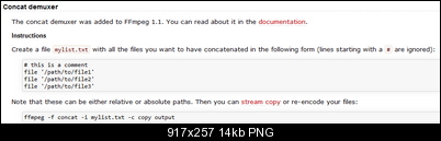

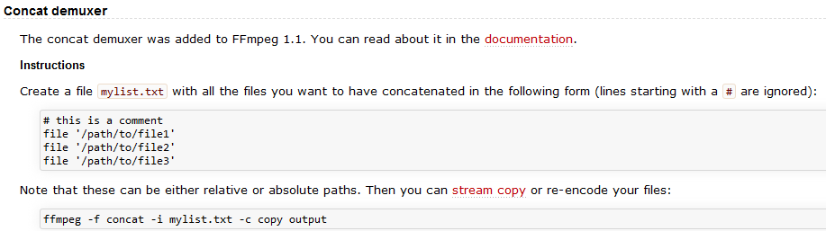

  7. Originally Posted by thufz View Post
    I read through the ffmpeg method and honestly I don't understand it.
    You only need to follow the small part at the beginning of the doc:
    As you suggested above I could re-encode the shorter video files to match the bigger one and then append using mkvmerge. Could you tell me how to do this (in simple terms) .
    I cannot explain in simple terms. Re-encoding everything or using the ffmpeg method is much simpler.
    [Attachment 35474 - Click to enlarge]
    Thank you. FFmpeg Concat demux worked perfectly.
