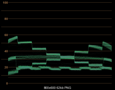

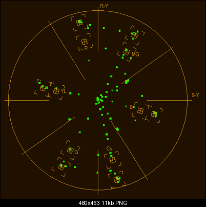

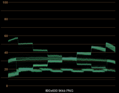

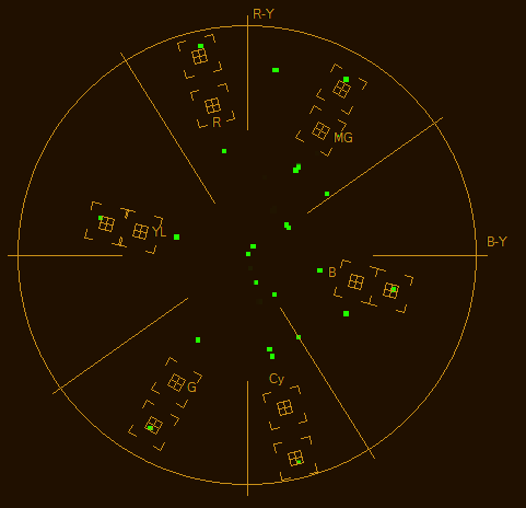

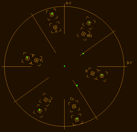

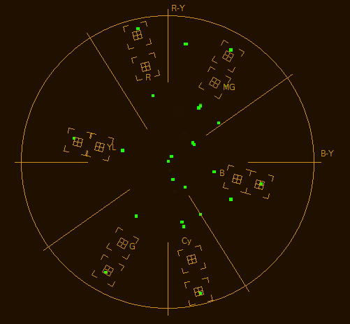

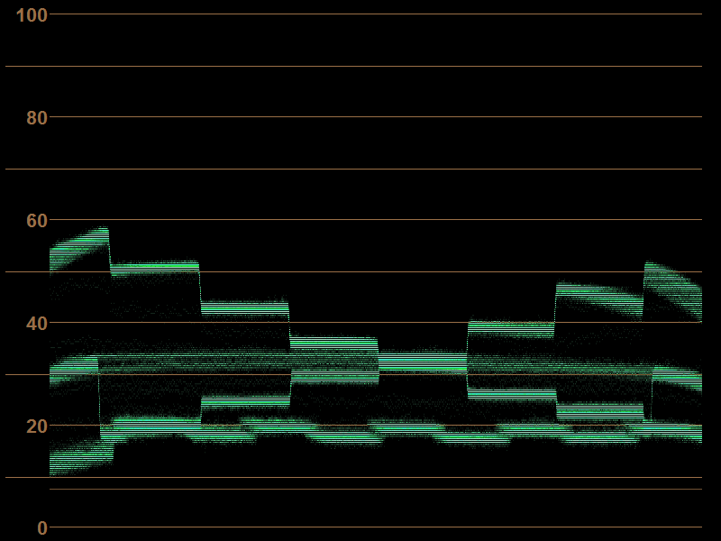

    However, your comments got me thinking, so I decided to do a test. I shot some gray bars on my Canon HV40 in Cine mode to my Ninja in ProRes 422 HQ. I brought it into AE and using Color Finesse grabbed a scope. Then, I took the Ninja file and pushed it through ffmbc using the following:
    ffmbc -i graybars.mov -vcodec prores -profile hq -qscale 1 -pix_fmt yuv422p10le -an ffmbc.mov
    Then, I grabbed a scope of it using Color Finesse. Then, I shifted the FFMBC transcode in a composition to have the FFMBC bottom bars on top of the bottom row of the original graybars and grabbed a scope of that (this corresponds to the stairstep from black to light gray going left to right and is a little more solid than the original images). From what I can see, there are no problems. But maybe I am doing something wrong?
    Ninja ProRes HQ Gray Bars
    FFMBC Transcode to ProRes HQ
    Overlay
  18. Sorry I should have been more clear instead of rambling 2 sentences . For non Apple Prores variants, there is sometimes a gamma shift in programs like resolve and FCP. It doesn't seem to plague Adobe (or at least as frequently), which is more forgiving. Quicktime in general can be problematic in many scenarios and is riddled with various gamma shift issues. This is very well known. DNxHD as mentioned eariler, especially the MOV variant is especially susceptible. The MXF variant is less susceptible
    For ffmbc prores specifically, there is a slight discrepancy, but only when there is a bit depth difference in input vs. output. So in your case for a prores input, you shouldn't see any difference with a prores output because both are 10bit YUV422 formats. This is a true difference and affects everything (not just Adobe or software title x,y,z). The reason is ffmbc applies floyd-steinberg dithering for colorspace bit depth conversions by default, which is different than ffmpeg behaviour .This dithering behaviour is nothing to be worried about in most cases, in fact you might argue it's beneficial. But the inconsisitencies in handling in FCP/X and Resolve is something to be worried about
    But the other problem to be aware of is ffmbc cannot handle newer avs 2.6 additional colorspace scripts properly. eg. So if you feed a dither tools YV16 script, you will get an even more visible (even to naked eye) shift
  19. Thank you as always. I did a little more research on the web and came across the following which is quite interesting:
    http://www.stopp.se/wp-content/uploads/2013/11/Stopp_ProRes_Test_Chart.pdf

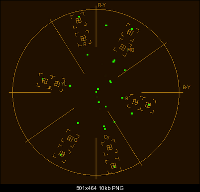

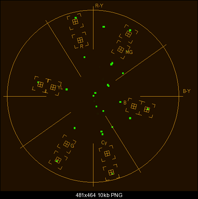

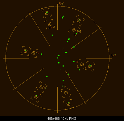

    So I decided to perform a different test. I generated the bars and tone in PP which are 75% SMPTE. And while I don't usually do this, I exported from PP as a QT format and brought that back into PP and sure enough there is a shift in the color. Notice how in the original image, each color bar is exactly in the color squares on the scope. However, in the QT export they have moved and this movement is obvious to the naked eye. So there is definitely some gamma shift being applied. The good news is I usually export from PP using utvideo. I brought this back into PP and the colors were very accurate. Phew. But you are correct. When I take the utvideo export and transcode it to ProRes 422 HQ using ffmbc 0.7-rc8 there is a slight color shift. Specifically, Red, Magenta, and Yellow are more saturated while Blue, Green, and Cyan are pretty close. I couldn't get ffmbc to read the utvideo avi and had to load it via Avisynth using AVISource(). However, I don't think Avisynth was the source of the shift because I transcoded the utvideo export to ProRes using ffmpeg and ffmpeg was able to read the utvideo avi natively. But honestly, the difference between ffmpeg and ffmbc is non-existent when I brought the ffmpeg encode back into PP.
    Also, and this is quite interesting. I took the ProRes file generated by ffmbc and loaded this into Resolve (Note: this file and the QT export from PP were the only files that Resolve would read. It would not read the ProRes file from ffmpeg or the utvideo export.) When I vectorscoped the ffmbc generated file in Resolve, it looked fine. Then, I exported this from Resolve as QT uncompressed 422 10-bit and brought that back into PP, and believe it or not, the colors look fine. No shift! The vectorscope is a little messy, but rest assured the color bars are exactly where they are supposed to be. So it looks like the problem is not with the colors per se. But rather how the programs read the flags embedded in the ProRes file.
    Finally, when I read into Resolve the QT export from PP, the colors are off just as before.
    So I am going to go out on a limb and say that ffmbc is accurate. The problem lies in the program and how it reads the encoded file.

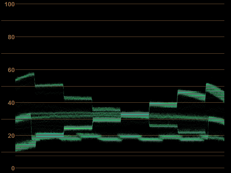

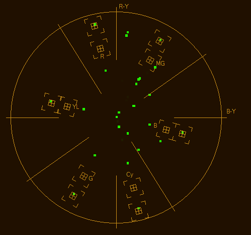

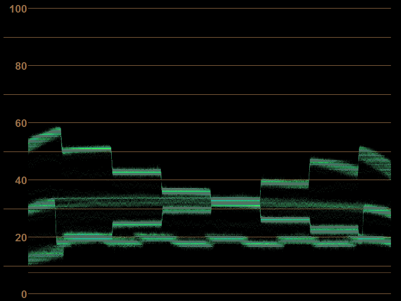

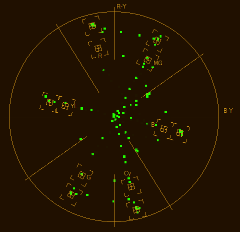

    Note: I generated the bars in a project set at 1920x1080 and exported all of them as 1920x1080 YUV 4:2:2 BT.709.

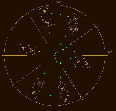

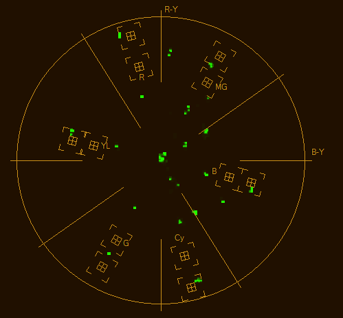

    So, in summary, below are the vectorscopes of the SMPTE color bars:
    1. Original bars generated in PP and scoped prior to export
    2. Exported as QT (color shift)
    3. Exported as utvideo YUV422 BT.709 (no color shift)
    4. Exported as Lagarith YUY2 (no color shift)
    5. Transcode the utvideo to ProRes 422 HQ using ffmbc (color shift)
    6. Transcode the utvideo to ProRes 422 HQ using ffmpeg (color shift)
    7. Round trip through Resolve using ffmbc (no color shift)
    1. Original SMPTE Color Bars
    2. QT Export from PP
    3. UTVideo Export from PP
    4. Lagarith Export from PP
    5. UTVideo Transcode to ProRes 422 HQ using ffmbc
    6. UTVideo Transcode to ProRes 422 using ffmpeg
    7. Resolve Export as QT
    Last edited by SameSelf; 1st Feb 2016 at 20:12. Reason: Added Lagarith export for comparison and documentation
  20. If you feed ffmbc YUV (but not YV16 or YV24) and export YUV in the same bit depth there should be no difference, unless the receiving program handles it differently, and some programs do handle it differently. Important to note that Premiere has a YUV capable since CS5 ; because many other programs work in RGB, and that is a common source of these discrepancies
    But when you convert an RGB source=>YUV (eg. maybe a color chart, maybe an image sequence, maybe an RGB export from AE you're converting to prores, not YUV colorbars), ffmbc will use Rec709 and ffmpeg will use Rec601, regardless of resolution . They will even write this in the metadata (but not all programs use the metadata to convert to RGB for display, most actually ignore the metadata). This also results a significant color shift and visible difference. This is also important to note if you're handling SD vs HD material . (There are ways to use colormatrix as -vf and to signal in/out color matrix with flags now, I'm just taking about default conversion)
    The other minor differences I was talking about refer to the dithering, those aren't large difference visible to naked eye under normal circumstances but detectable with scopes and certain situations like logos with gradients , those sorts of things. Single colors like color bars won't show those types of differences because there is no gradient. But something like a shadow, a sky those types of things will show those dithering differnences. The gradients will be smoother. This is also one of the reasons why the ffmbc prores encodes are much heavier (higher bitrate) than ffmpeg - the diterhing is essentially fine "noise"
  21. Here is a clip a I generated out of PP using utvideo that shows the color shifts of each test above.
