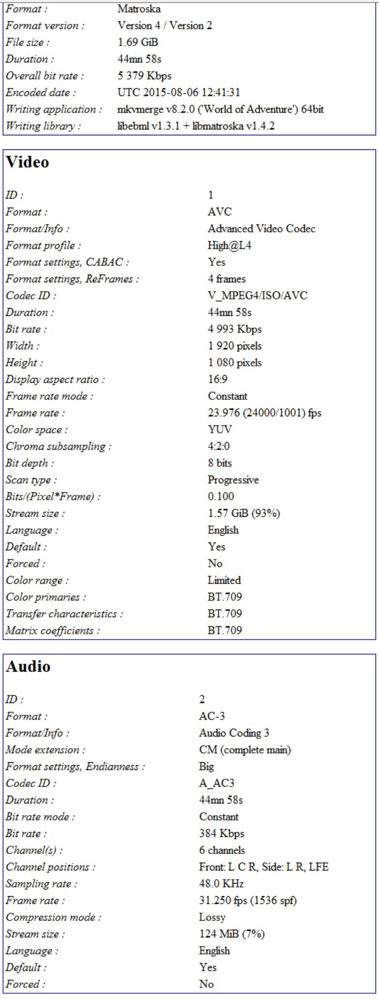

    Here are screenshots of the codec info from MediaInfo so you have an idea what I'm working with:
    Video 1: https://forum.videohelp.com/images/imgfiles/wfzzZZB.png
    Video 2: https://forum.videohelp.com/images/imgfiles/PosvgYS.png
