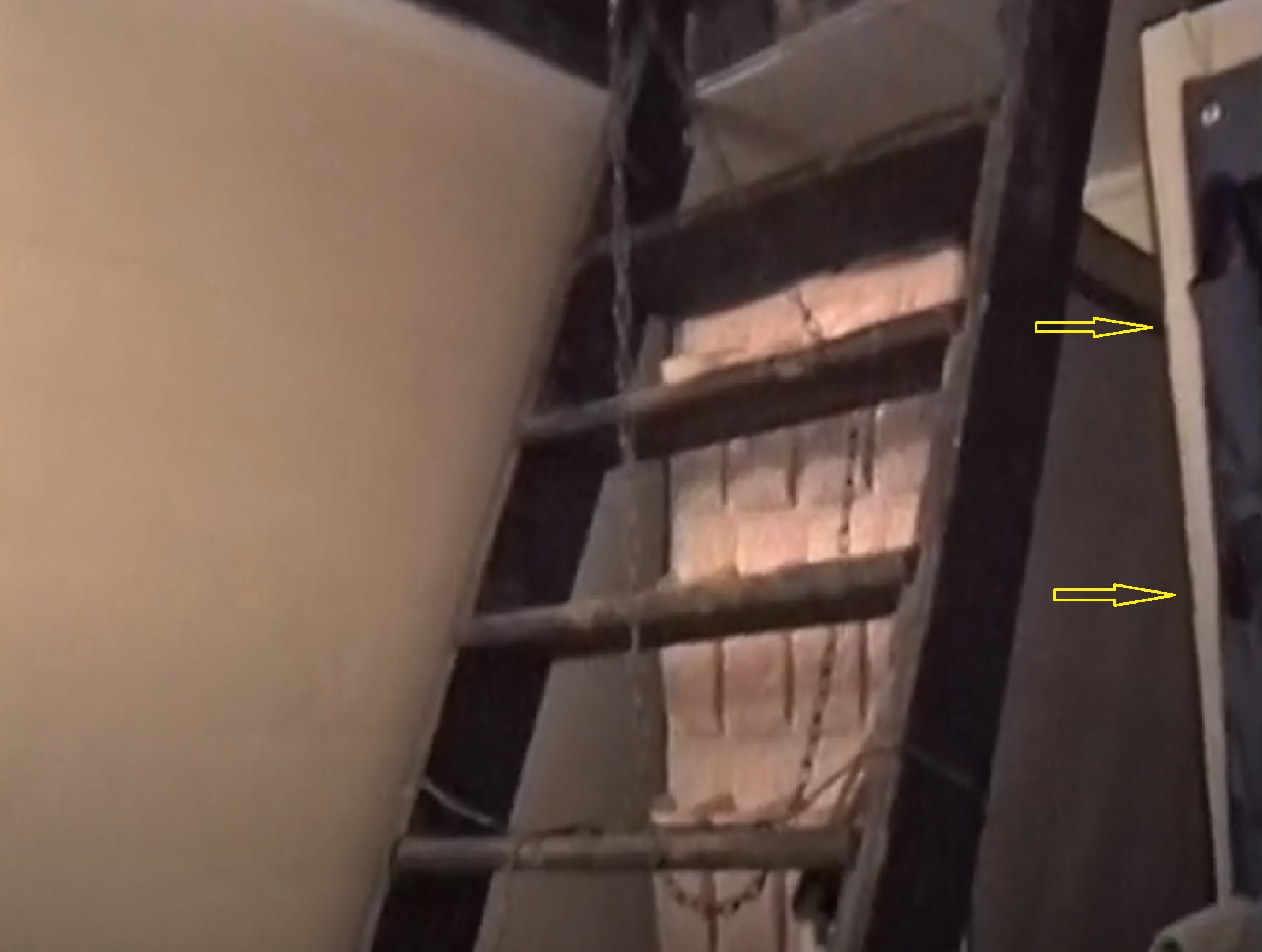

    Yes as said, that noise is normal, You do have a significant line jitter on all vertical lines, You could benefit from a camcorder that has line TBC or if the one you have has one just turn it on and try DNR as well if equipped.
    Jun 2020
    Fort Lauderdale, FL
    Just checked -- TBC & DNR are both on . Is this perhaps a symptom of capturing analog footage via firewire?
    I have a few other questions:
    • Is there a major or noticeable difference between doing the transfer via firewire when dealing with analog tapes, vs. using a proper capture card?
    • If I go the ATI AIW route (I have an old PC I built in 2002 that can take an AGP card) is there a prefered model in the Theater 200 series?
    • A lot of this footage was shot in Hi8 on a Sharp Viewcam; is it a good idea to aquire the same camera it was originaly recorded on, and is s-video out advantageous when dealing with Hi8 material?
    Thanks again for humoring the rookie!!
  22. Capturing Memories dellsam34's Avatar
    Jan 2016
    It's hard to tell from a youtube video, post a sample here so we can take a look.
    - Yes capturing analog tapes from S-Video in lossless AVI 4:2:2 is better than DV even if you compress the lossless AVI to H.264 afterwards, because H.264 is much more efficient than DV.
    - I don't know much about ATI AIW
    - Only if the camcorder that shot the tape was miss aligned, otherwise use the best camcorder for playback.
  23. Member
    Jun 2020
    Fort Lauderdale, FL
    Thanks again for all the input!!!
    Here's a link to the clip from youtube: http://atlanticstudios.com/hi8capture/FL1996.20-06-15.avi
    Is the TRV460 considered a good camcorder for capture?
  24. Capturing Memories dellsam34's Avatar
    Jan 2016
    I could not confirm if the TRV460 is the best camcorder but if it has S-Video and Hi-Fi Stereo for analog tapes and line TBC/DNR it should be adequate, those are basic requirement for a decent capture of the analog 8mm format, I just want to note that Sony back in the later days of the format made some Video8 and Hi8 camcorders with an extra feature called XR (extended resolution). If you have some of those recordings you may want to consider an additional Hi8 camcorder with that feature. XR tapes can be played back on a normal camcorder including the D8 but you don't get the benefit of that 10% extra sharpness in luminance.
  25. Capturing Memories dellsam34's Avatar
    Jan 2016

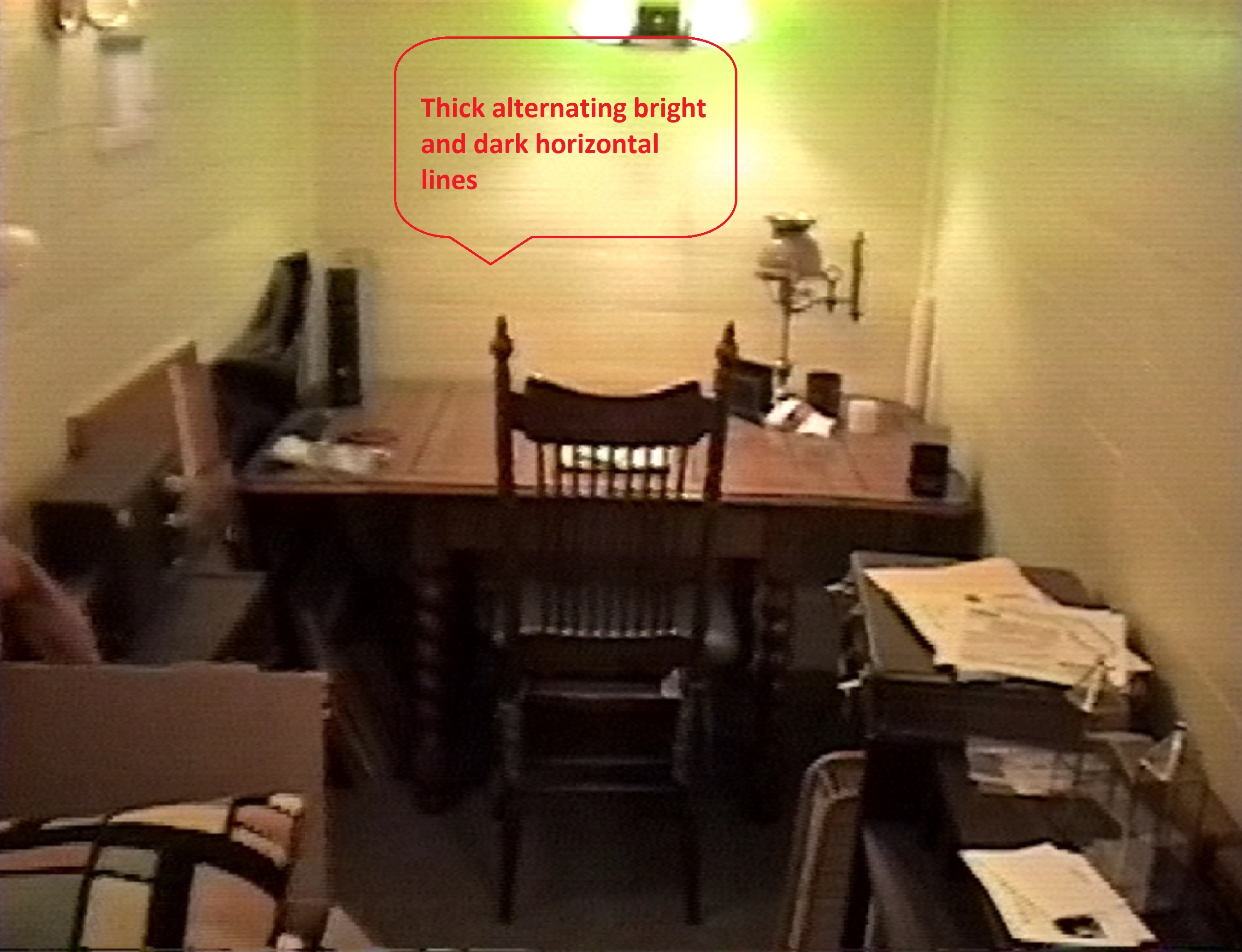

    Just like another member here, you have the same problem with those large alternating dark and bright lines, His were in certain areas, yours are across the whole video. As I mentioned before this may have something to do with the primitive imaging sensors used on those old camcorders, What camcorder shot those tapes?
