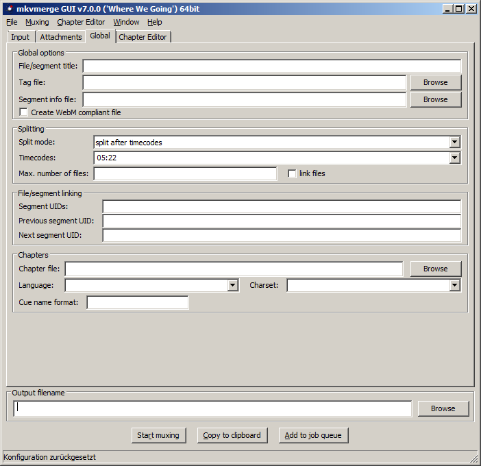

  10. I made a screenshot of the new GUI but it works exactly the same in the old GUI IIRC:
    [Attachment 35412 - Click to enlarge]
    Tip: hover your mouse over the mode and timecode fields of the GUI and yellow help text bubbles should appear explaining the format and everything.
    For "output.mkv" file names would be:
    output-001.mkv
    output-002.mkv
  11. Yes I've seen the bubble messages. Flashing anything is just a no-no. And at one point I looked at my folder and did get some result. Just not the result I needed.

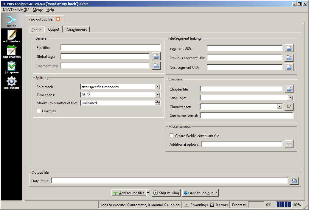

  13. Originally Posted by loninappleton View Post
    Is there a syntax command in the old style to say make a cut at 5 min :35 sec and save the remainder to the end (of file)? I monitored the piece again and now have a more accurate time placement for the edit.
    Like I said: the old and new GUI work the same way in that respect. Just copy what you see in my screenshot.
    [Attachment 35415 - Click to enlarge]
