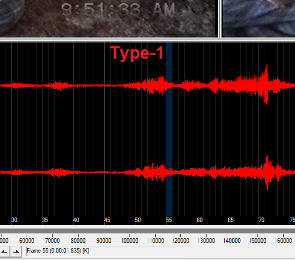

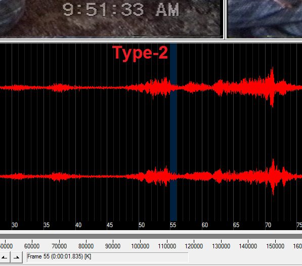

    Per this thread, switching to Type-1 did fix my problem. My thanks to all who contributed.
    At the start, they're the same...
Name:	DV type-2 - bad sync - f55 crop.png
ID:	35594 Click image for larger version
Name:	DV type-1 - good sync - f55 crop.PNG

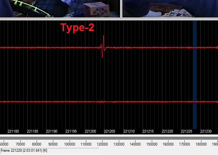

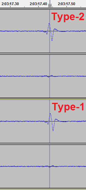

    At the end, not so much...
Name:	DV type-2 - bad sync - f221228 crop.png
ID:	35596 Click image for larger version
Name:	DV type-1 - good sync - f221228 crop.PNG

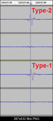

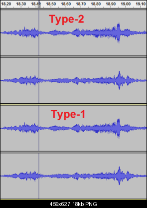

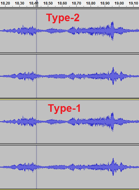

    The weird thing is, the audio tracks are actually in sync with each other...? I opened both AVIs in Audacity (FFmpeg import), aligned them near the start, and they're practically identical at the end.
Name:	DV type-2 vs type-1 - 0-00-18.PNG
ID:	35593 Click image for larger version
Name:	DV type-2 vs type-1 - 2-03-17.PNG
    (The reason for the timecode difference between the VirtualDub and Audacity screenshots is unrelated to sync. I simply trimmed 497 & 772 frames from the start of the files to match the starting frames in VDub.)
