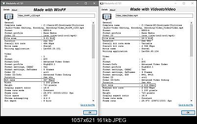

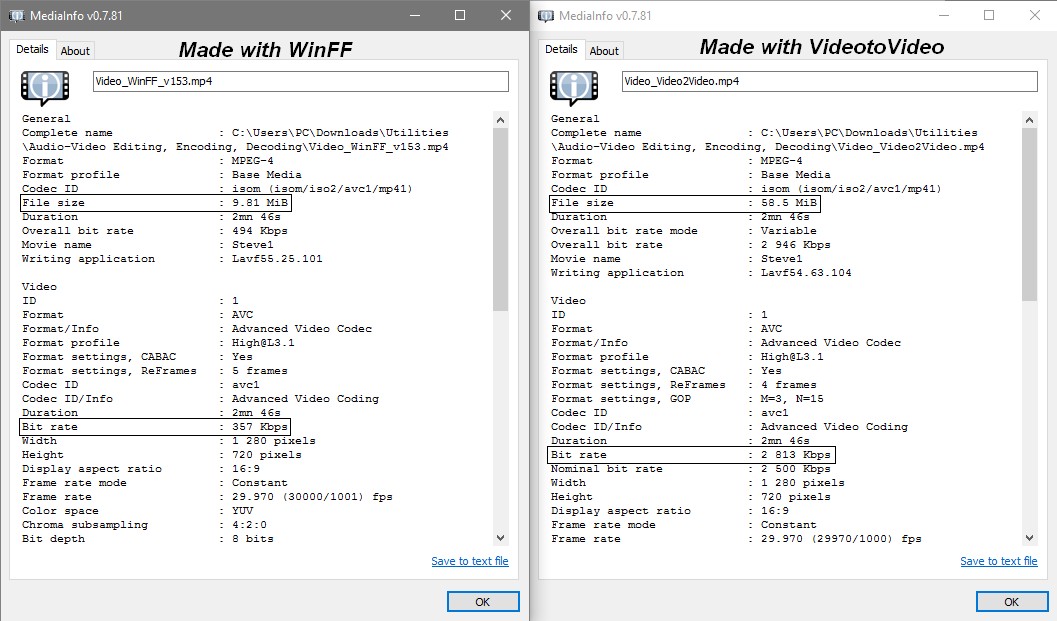

    I just did a .wmv conversion to .mp4 using WinFF and Videotovideo (at default settings) and the resulting file sizes are quite different; however, when I watch either video on my PC, they both look OK. So, my question is: Are very low bitrates OK for YouTube slideshow videos?
    FYI, I really can't see much of a difference.
    Thanks,
    gus

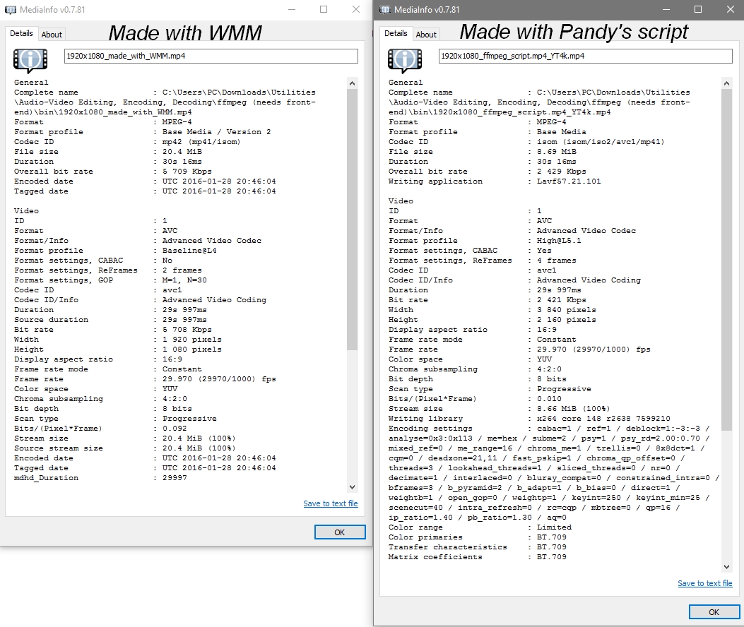

  18. Hi again pandy (and all),
    OK, I did the test and here are the results:
    First, I created two 30-second movies of a single quality image using WMM for one and the script for the other using a QP value of 16.

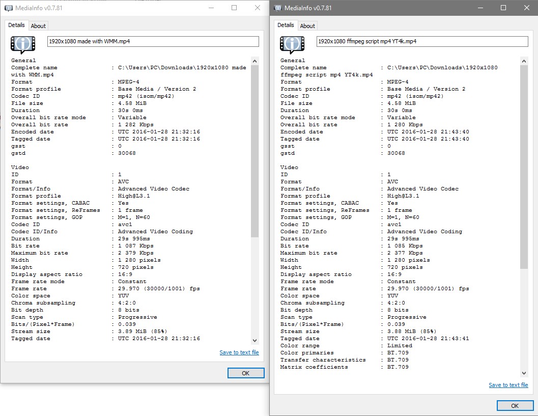

    Next, I uploaded both to you tube. I noted that even though the script video was smaller, it took twice as long to become active (eg, published) and the settings to watch the movie above 360p took an extra 10 minutes or so. Here are the movies for your comparison and/or edification. Now, viewing both at 1080p, I personally see no real difference in quality from a normal viewing distance:
    https://www.youtube.com/watch?v=r3ZOeY1PG24&feature=youtu.be
    https://www.youtube.com/watch?v=jmBuJ9lSnUU&feature=youtu.be
    And finally, I download both videos at 720p and they were both the same size with the same viewing quality (IMHO):
    My personal conclusion: This script is really neat and I can see some application for it; however, it really doesn't work for me because of the extra YouTube processing time and, since the downloads are the same size and quality, it is easiest for me to just upload the original .wmv or .mp4 file and be done with it. Also, thanks to everyone who contributed to this thread and a big thank you to pandy for his detailed guidance so I could actually do the test comparison.
    Cheers,
    gus
  19. Hello Gus, so i've checked above YT links and seem that "1920x1080 made with WMM.mp4" file is available only as 720p (at least it was maximum resolution reported by YT).
        "streams": [
                "index": 0,
                "codec_name": "h264",
                "codec_long_name": "H.264 / AVC / MPEG-4 AVC / MPEG-4 part 10",
                "profile": "High",
                "codec_type": "video",
                "codec_time_base": "1001/60000",
                "codec_tag_string": "avc1",
                "codec_tag": "0x31637661",
                "width": 1280,
                "height": 720,
                "coded_width": 1280,
                "coded_height": 720,
                "has_b_frames": 0,
                "sample_aspect_ratio": "1:1",
                "display_aspect_ratio": "16:9",
                "pix_fmt": "yuv420p",
                "level": 31,
                "chroma_location": "left",
                "refs": 1,
                "is_avc": "true",
                "nal_length_size": "4",
                "r_frame_rate": "30000/1001",
                "avg_frame_rate": "30000/1001",
                "time_base": "1/30000",
                "start_pts": 0,
                "start_time": "0:00:00.000000",
                "duration_ts": 899899,
                "duration": "0:00:29.996633",
                "bit_rate": "1.087000 Mbit/s",
                "bits_per_raw_sample": "8",
                "nb_frames": "899",
                "disposition": {
                    "default": 1,
                    "dub": 0,
                    "original": 0,
                    "comment": 0,
                    "lyrics": 0,
                    "karaoke": 0,
                    "forced": 0,
                    "hearing_impaired": 0,
                    "visual_impaired": 0,
                    "clean_effects": 0,
                    "attached_pic": 0
                "tags": {
                    "language": "und",
                    "handler_name": "VideoHandler"
    On other side "1920x1080 ffmpeg script mp4 YT4k.mp4" file was with UHD resolution:
        "streams": [
                "index": 0,
                "profile": "High",
                "width": 3840,
                "height": 2160,
                "coded_width": 3840,
                "coded_height": 2160,
                "has_b_frames": 1,
                "level": 51,
                "color_range": "tv",
                "color_space": "bt709",
                "color_transfer": "bt709",
                "color_primaries": "bt709",
                "refs": 2,
                "is_avc": "true",
                "time_base": "1/90000",
                "start_pts": 0,
                "duration_ts": 2699697,
                "bit_rate": "2.785094 Mbit/s",
                "nb_frames": "899",
                "disposition": {
                    "default": 1,
                    "dub": 0,
                    "original": 0,
                    "comment": 0,
                    "lyrics": 0,
                    "karaoke": 0,
                    "forced": 0,
                    "clean_effects": 0,
                    "attached_pic": 0
                "tags": {
                    "language": "und",
    Second video offer without doubts higher spatial resolution (yacht tackling is retained and visible without any problem - my notebook has only 1920x1200 resolution as such i was able to see only video reduces by half i.e. 1920x1080).
    Cheers!
  20. Hi pandy,
    I get the YouTube option to view the WMM video at 1920x1080 (1080p). That is a really cool .bat file! Thanks for sharing and help too!
    Best regards,
