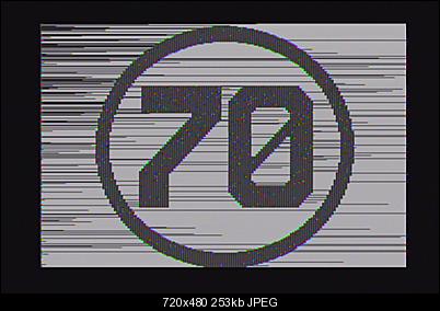

  1. I have a rather unique situation, I am trying to capture video signal from a a Random Number Generator (RNG) for a video display in a bingo hall. The video source is a very old piece of hardware made by Arrow international which outputs a digital image of a bingo ball. I can plug this in via composite input in a TV and the image looks great. I plug it in to the Diamond vc500 and the picture is black and white, has lines through it, the picture jumps vertically and flashes. There is a sample image below. This should be just a plain white background with a colored circled and number in the middle.
    I can plug in other video sources to my vc500 and they look fine. I tried this on both my laptop and desktop with the same results. Any ideas?
    I am wondering if there is some kind of filter, or amplifier that might correct this?

    This thing is probably outputting some non-standard video signal that the VC500 chokes on. I was going to suggest it's 240p like old video game consoles, but I found posts saying that people use the VC500 with the NES.
    If you have or can borrow a DVD recorder, try seeing whether that will accept the signal. If not, getting a PC capture device that will do it is probably hopeless and I doubt you want to invest in a full-frame TBC just for this.
