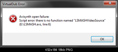

  1. I have the following loaders successfully installed on my system: AVISource and FFMS2. I have read here that L-SMASH is sometimes a preferred loader when dealing with MP4 or MOV. So I thought I would give it a try. The problem is I have no idea how to install it. I downloaded the 32-bit version and copied the dlls in the Avisynth folder to my Plugins folder for Avisynth. But when trying to load a video, I get a no function found error for the LSMASHVideoSource line.
    There are no instructions included in the download from what I can see. Usually it is as simple as copying the dlls and .avsi script to the plug-in folder (e.g. FFMS). But I can't find a .avsi file in the download.
    Any help is greatly appreciated. Thanks!

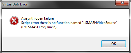

    And here is the Error am getting when I try to open the avs script in vdub. It obviously does not recognize LSMASHVideoSource (line 6).

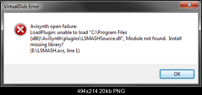

  5. Try explicitly loading the dll in your script:
    LoadPlugin("C:\Program Files (x86)\AviSynth\plugins\LSMASHSource.dll")
    Modify the path if necessary. Do you get a different error message?

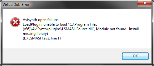

  6. Thanks jagabo. I think we are getting somewhere. The error is now this:
  7. Did you follow points 2 and 3 of my post?
  8. sneaker, thanks, after installing Visual C++ 2013 (x86) it finally worked. An HTML link to that download was sitting in the L-SMASH download, but I didn't realize that was what it was telling me to do.
