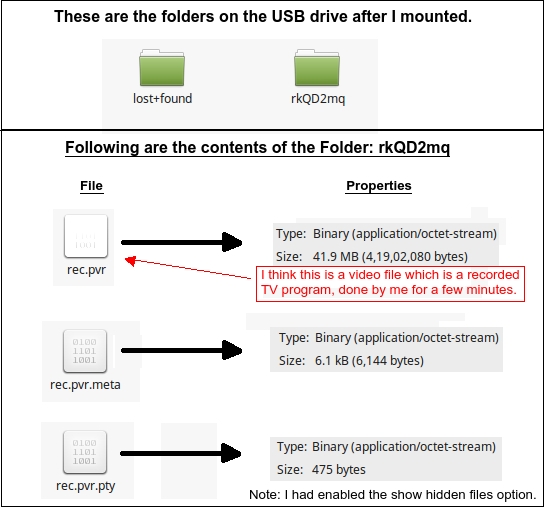

    Yes I can mount the USB drive. And its contents are as shown in the screen shot below;
Name:	Set-top-box Folders.jpeg
    You need to able to copy the files to the hdd without messing up the USB partition/file structure.
    I was not able to copy the files, even with root privileges. Permission denied. The file structure is Ext3. The STB initially asked to format the drive when inserted for the first use. Just to test, I formatted the USB in Ext4 on my Laptop and inserted it in the STB. It didn't accept. But then I removed it and again reformatted it to EXT3 on my Laptop, and it accepted it! I was able to record a program and watch, as normal.

    Can you play the rec.pvr with for example VLC Media player? Or try open the rec.pvr with mediainfo and see if it can see any video details. If not I guess it will hard to get your files in similar file format.
    Does the set-top-box manual mention anything about USB video-playback? Some boxes can play mpg, avi/divx/xvid files.
  5. Thanks Baldrick,
    No Baldrick, I tried but, they could not be played with VLC. The MediaInfo does not give much of information, except that its aspect ratio is 1.333333 and its size.
    There is no information in the manual regarding types of files compatible with the STB. However, I did something. I converted a HD video to two NTSC file, mpg and mp4 files and pasted it on the USB, after formatting it on the laptop to ext3. I even re-named one of them as rec.mpg. Then I connected it to the STB. But the STB did not find the files at all, the USB was shown to be empty!
    Thank you Baldrick for your compassion.
    Regards
  6. Originally Posted by Anil Kagi View Post
    They're probably encrypted.

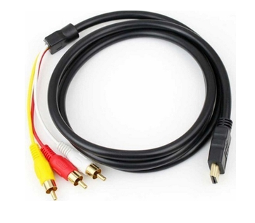

    Since I want to watch my videos from the Laptop on my Standard-Definition-TV [Can I post this here? Or should I start a new thread?]; how about connecting my Laptop to the SDTV, through a HDMI-RCA AV cable? I have a HDMI slot on my laptop and the 3-slot RCA on the SDTV. Here below is the image of a HDMI to RCA AV cable.
    Name:  HDMI to RCA AV cable.png
    Can I watch the videos from my Laptop on the TV, by connecting thus? Would it require a converter in between? If so; how bout converting the HD video to NTSC, with the help of conversion software in my Laptop and then relaying it to the SDTV? Though the quality of the video would be degraded, but still I would prefer it because I can watch it on a bigger screen.
    Thank you for being with me.
    Regards.
  12. Originally Posted by Anil Kagi View Post
    I don't know exactly where you saw that cable but it probably won't work. I bet if you look at the small print in the ad you will see something like "requires a digital to analog converter", or "this cable is not a signal converter." For example:
    http://www.amazon.com/VAlinks-Extension-Converter-Satellite-Projectors/dp/B00RMYVW4K/
    Unscrupulous sellers advertise cables like that knowing you're not going to demand your $5 back when you find it doesn't work. You need an HDMI to composite/audio converter box like this:
    http://www.amazon.com/Tendak-Composite-Converter-Adapter-Supporting/dp/B00KBQZC4M/
    That device accepts a digital HDMI signal and converts it to analog composite video and stereo RCA audio signals. The device also requires power from a USB port. I believe there are some devices that siphon power from the HDMI signals
    I was aware that the cable functions as a signal transmitter, but not as a signal converter. However I was banking on, the video conversion software inside my Laptop.

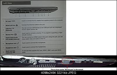

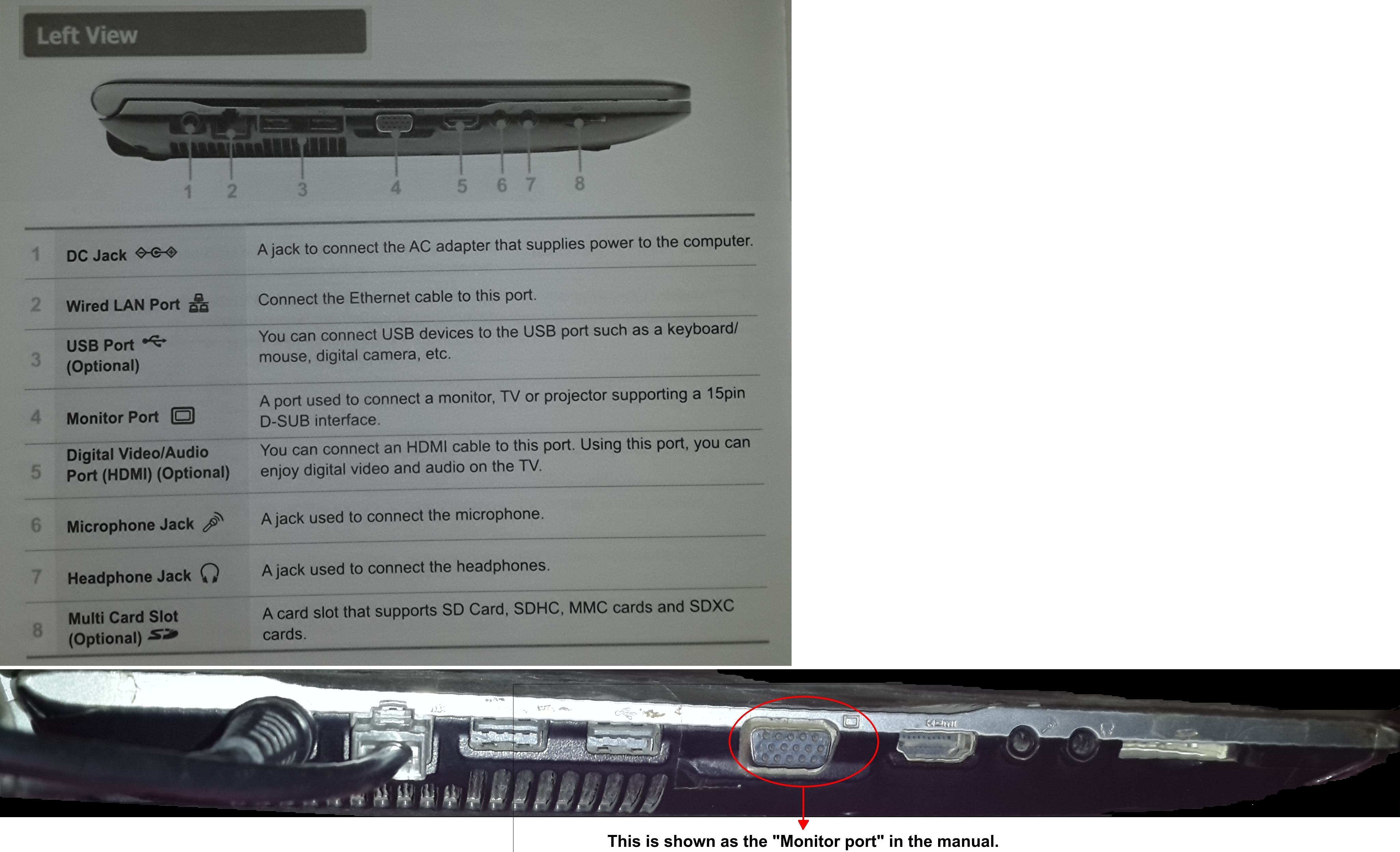

    "Monitor port: A port used to connect a monitor, TV or projector supporting a 15 pin D-SUB interface."
    The 15 pin D-SUB interface, refers to the projector I suppose, and not the TV. Or does the TV also, has to have it?
    How about this?
    Yes, the TV would need a VGA port to use the 15 pin D-SUB interface. Some LCD TVs include a VGA connection, sometimes labeled "PC". Analog TVs don't, or at least I have never seen one that does.
    You need an external VGA to composite converter to connect an analog TV to a PC's VGA port.

    Are there appropriate cables available that can connect my Laptop HDMI or USB [whichever is needed for Plex streaming to materialize.] and the Coax? I searched the net for HDMI/USB to Coax cable, [Because that is what takes the input signal on my STB] I couldn't find any.

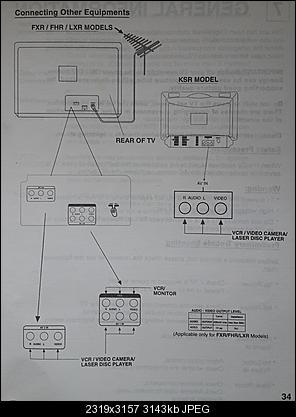

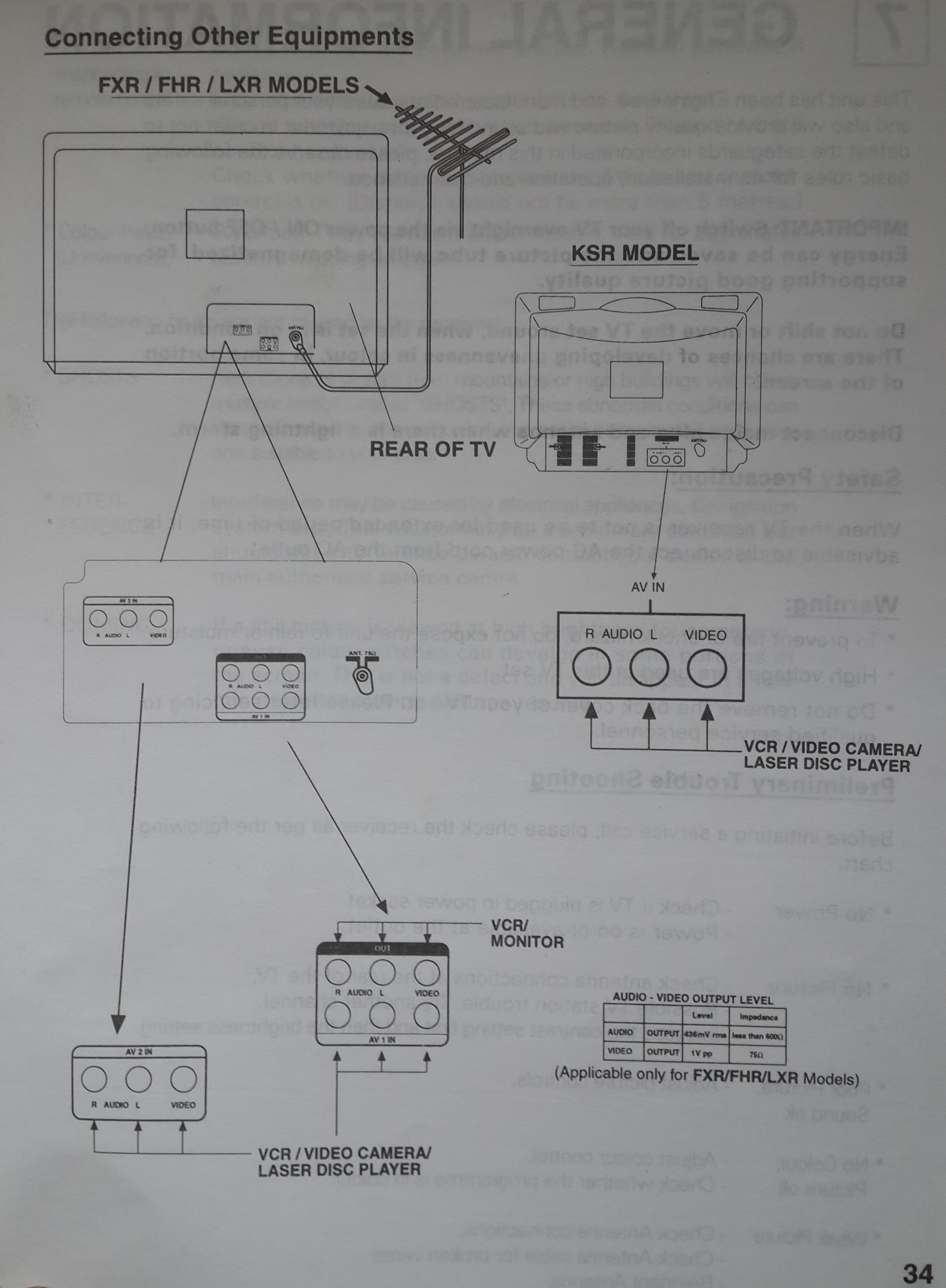

    Originally Posted by hamilton accie View Post
    Please post the make and model number of your TV.
    This will allow the forum members to ascertain what is or is not possible.
    I have given here below the specifications of the TV to the best of my ability. Forgive me for not doing that earlier.
    Company: BPL
    Model: FHR 15HA1, 53cms
    Television System: CCIR B/G
    Colour System: PAL, AV-NTSC
    Channels: VHF E2-E12, UHF21-69, X-Z+2, S1-S41, CATV Hyperband Channels.
    There is a page in the manual book in which a diagram is given under the heading, "Connecting other equipments". I am reproducing the page here below.
Name:	Connecting other equipments.jpg
    Thanks again Hamilton accie, for your compassion.
    Regards

    And then there is another option I suppose. [I don't know whether I can mention this here, or have to start a new thread.] I have heard and read that, TVs, whether HD or SD, can be connected to the Laptops as an additional Monitor. And whatever is displayed on the Laptop monitor, is also displayed on the SDTV. I also have a slot on my Laptop, whose description in the manual is as below.
    Since my Laptop already has a monitor port, does it mean that an analog TV can be connected to it and used as a secondary monitor?
    Though my TV does not have 15 pin D-SUB interface, can I use a '15 Pin VGA to 3 RCA Composite AV Cable Adapter', [like the one in the link given below] and connect my Laptop to the SDTV?
    http://www.amazon.com/S-Video-Composite-Cable-Adapter-Converter/dp/B0087ZB1E4
    If this is possible, will the AV played on the Laptop be displayed on the TV, where both Audio and Video are available. I ask because, I read that the VGA transmits only video and one would need a separate audio cable to get the audio. But my TV does not have an exclusive audio input slot.
    Is the 15 pin Monitor port available on my Laptop, actually a VGA slot or something else? If it is the VGA, then by connecting the above mentioned adaptor, will the audio also be available on the TV? I have given the image of the slots on the Laptop below.
Name:	Laptop slots.jpg
    Thanks for staying with me, Usually_quiet.
    Regards
