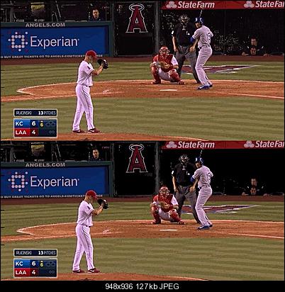

  5. I don't think you'll find any filters in VirtualDub. But you can try something like this in AviSynth:
    ffVideoSource("SatisfiedJadedHornet.mp4")
    bmask=mt_binarize(28).mt_inpand().mt_expand().Blur(1.0).Blur(1.0).GreyScale().Invert()
    Overlay(last, ColorYUV(gain_y=-256), mask=bmask)
    That gets rid of most of it without damaging the rest of the picture too much. Original on top, fixed on bottom:
    But you'd be much better off figuring out why this is happening in the first place and avoiding it.
  6. Originally Posted by jagabo View Post
    [Attachment 35298 - Click to enlarge]
    Just went through the hoops and it worked perfectly. Incredible! I know it's just a band-aid for a bigger problem, but since this doesn't happen very frequently, this is a life saver.
