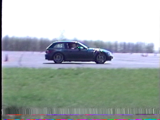

  1. Hi guys I am trying to convert some old Hi8/Digital8 tapes to a digital format. I've got a bunch of old tapes that I recorded with a Sony Handycam CCD-TRV67. I recently picked up an DCR-TRV340, which is supposed to play my old tapes and convert them to digital. They play just fine, but I am getting some distortion and the audio is fuzzy. This happens with all my tapes. Also, when I put them back in my old camcorder, they play fine. But of course my old camcorder doesn't have digital output. Also the other weird thing is that when I record new video on the TRV340, there is no distortion in video or audio. I have attached a sample screen grab. Has anyone else ran into this problem or is my camera just faulty?
    [Attachment 35283 - Click to enlarge]

  4. Looks like a play speed issue -- either tracking is out of spec or tapes were recorded at EP?
  5. Originally Posted by smrpix View Post
    Yeah that's what makes me think the head stills seems to be okay. If it works fine recording and playing back in the Digital8 format...
    Not sure what EP is. Is there a way to tell if it was recorded in EP? If that tracking is out of spec, is there any way to this fix this or is it better to just find a different camcorder?
    EP mode is "extended play"; it's a mode which gives you a longer recording time on the cassette, at the expense of some video quality, by running the tape at a slower speed. However, due to the slower speed, the helical-recording stripes are packed more closely together (and at a slightly-different angle, as well), so the tracking tolerances are less forgiving, which often gave rise to situations where EP-mode tapes might only play back "cleanly" in the same camera they were originally recorded in. The manual which came with my 340 did not recommend playing back EP-mode tapes directly on the camcorder, for exactly that reason; it recommended using the original camera, if available, and using the 340 as a passthrough converter.
    "Fixing" the tracking is generally not practical, nor desirable, especially if the problem is that the original Hi8 camera's tracking was a bit out-of-spec to begin with. If the camera was out of spec, then the tapes have been recorded with their stripes out of spec as well; if you try to "fix" the tracking on the 340 to match the tapes, that means your 340 will now be out of spec too!
  13. Wow thank you so much for the information! Well maybe since the 340 records/plays tapes just fine in the Digital8 format, the problem is really the older camcorder? The old one could have recorded tapes out of spec... Haha I really have no idea. I'm not sure it's worth selling this 340 and getting another handycam just to see where the problem lies. Do you think I would lose any quality if I use my old camcorder as a playback device and just use the 340 as the passthrough? The only thing that sucks is that I won't be able to use the controls in my software to stop/play/rewind/ff
