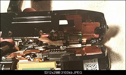

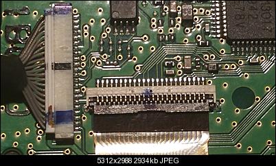

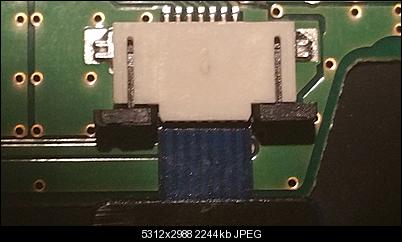

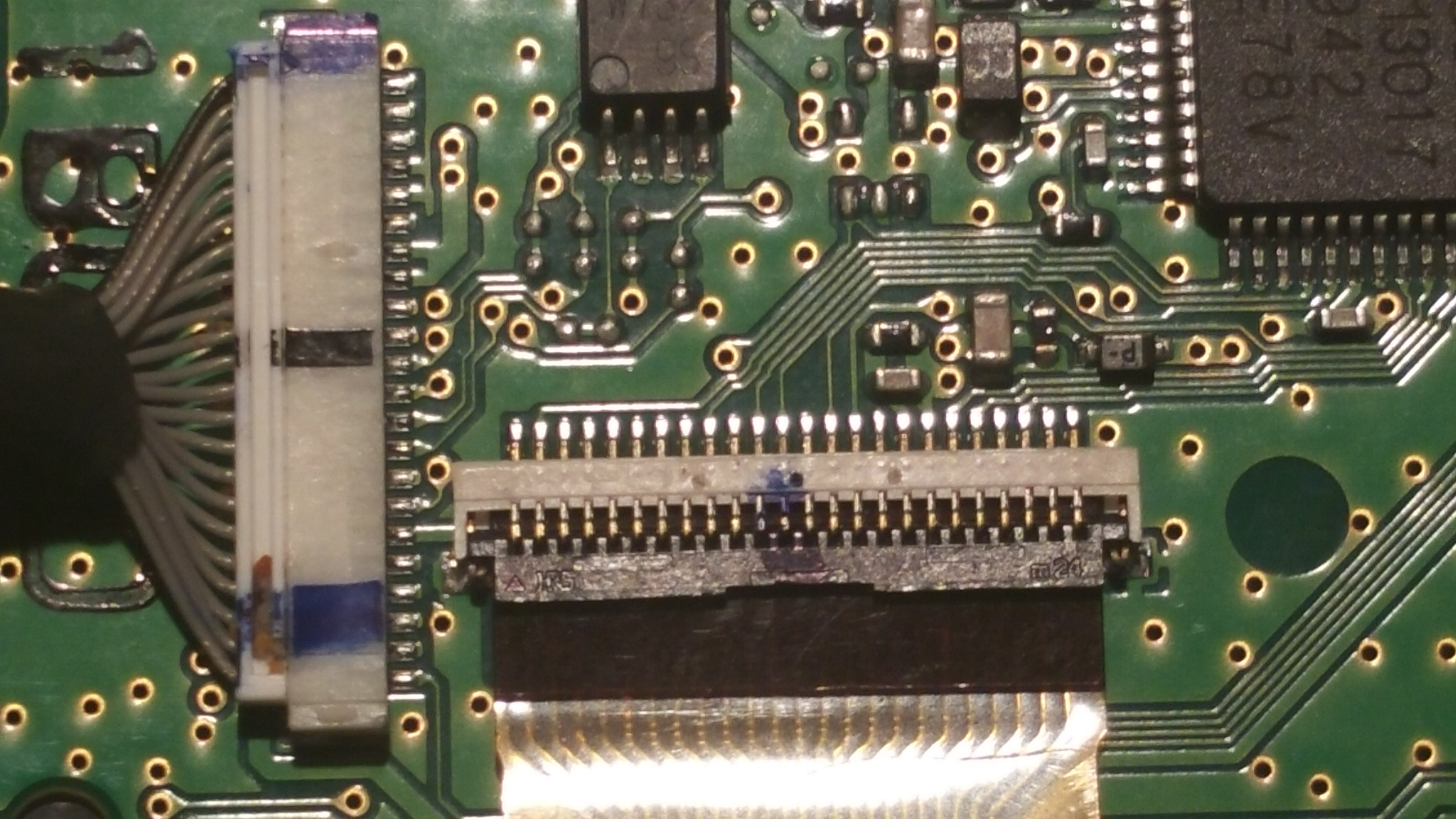

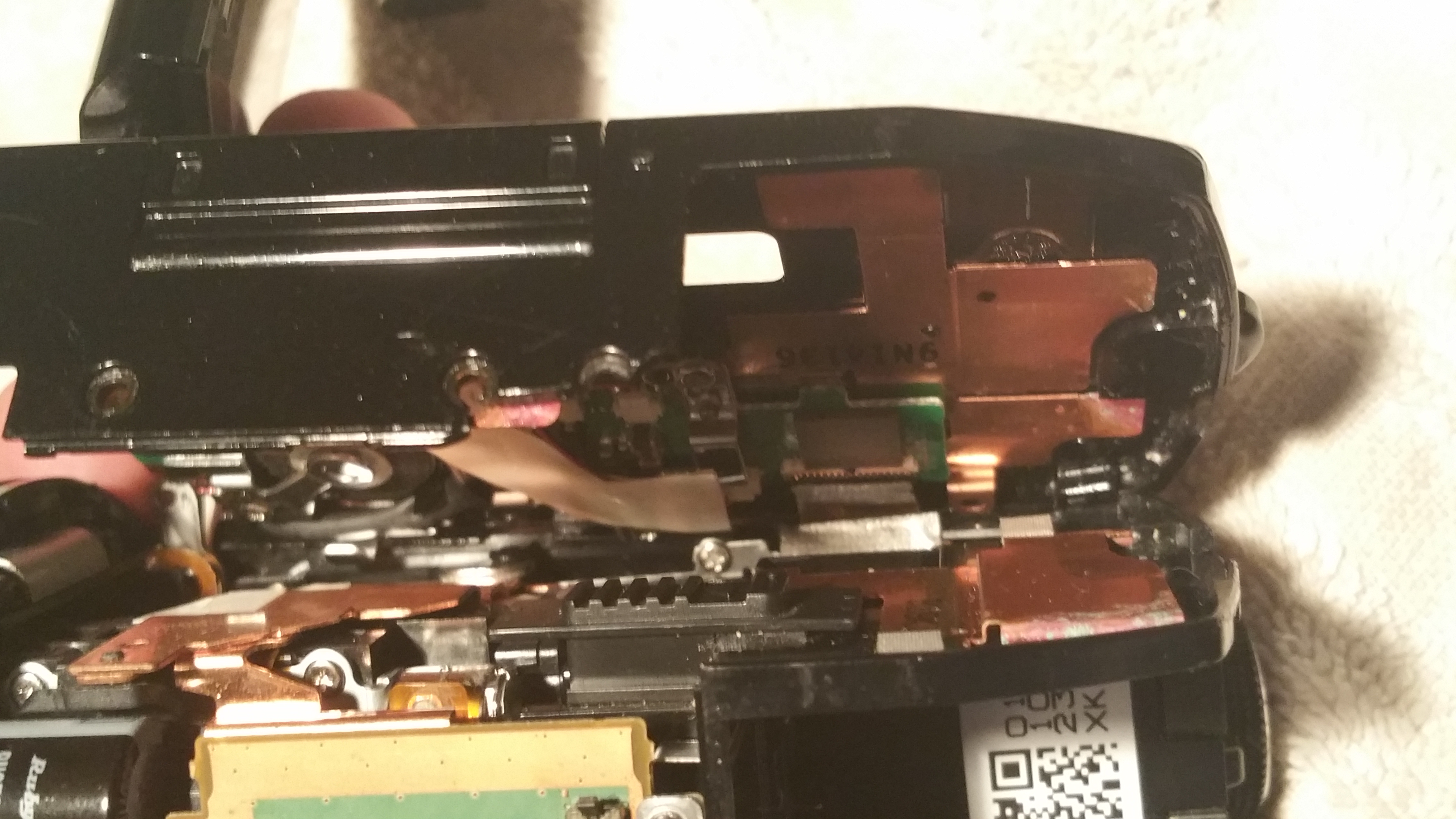

  4. I checked and took pics tonight - It seems I have solid connections.
    Out of all the ribbon connectors, which one is more likely to have a direct effect on the screen power?
    The connection that is hardest to connect is the screen assy to the body, but I know it is connected.
    Maybe overthinking..
    I wonder if by touching the motherboard it may have shut it down?
    Do any of the chassis screws act as grounds?
    Running out of theories.. But, something is the cause...
    Thoughts?

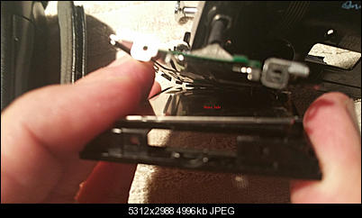

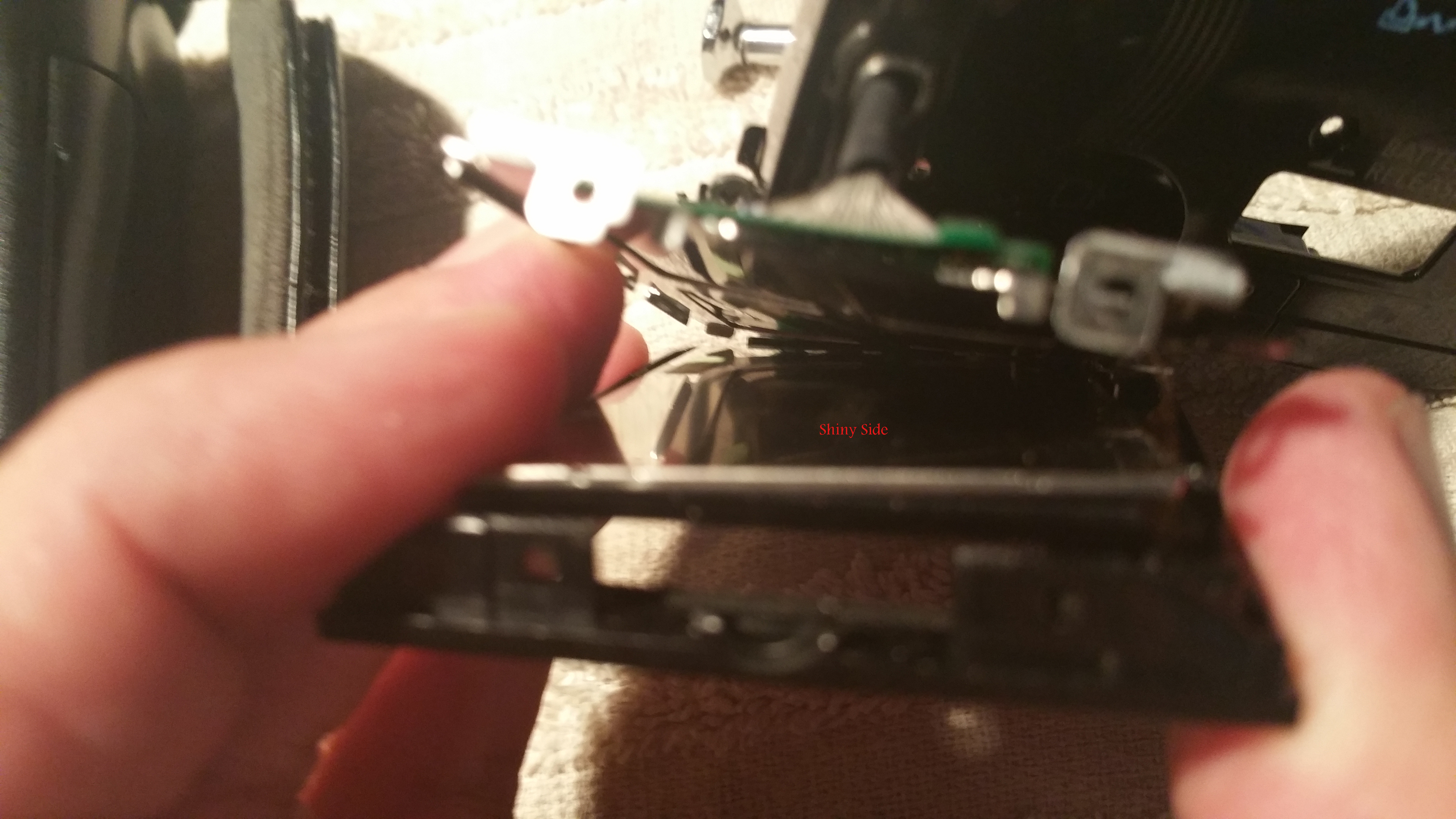

  5. Would the digitizer normally show some signs of damage?
  6. I don't think there is any way I could have put it back, upside down.. That would be sad!
    Is this right?Click image for larger version
