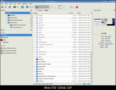

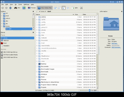

    I found a replacement for xplorer2 in the form of Double Commander (the Dolphin file manager was getting too frustrating) and it's surprisingly similar so hopefully I won't miss xplorer2 all that much.

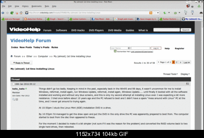

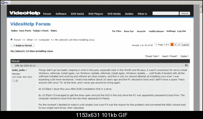

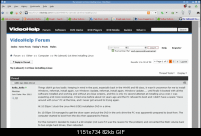

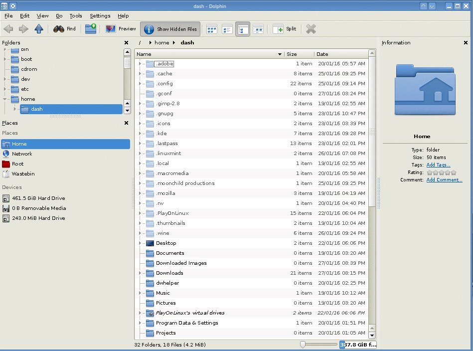

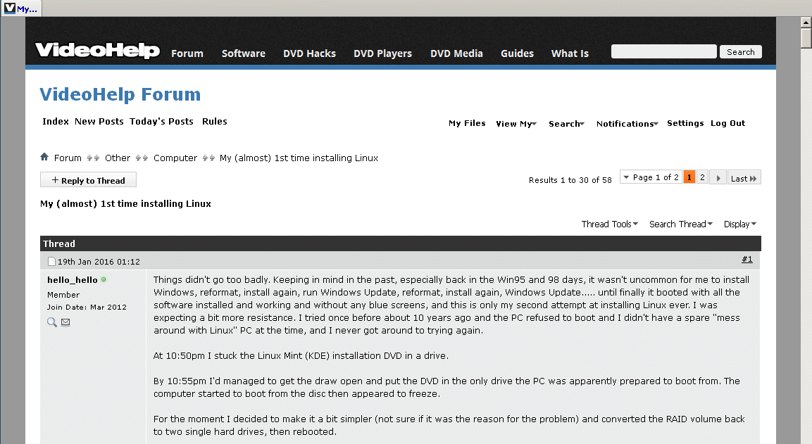

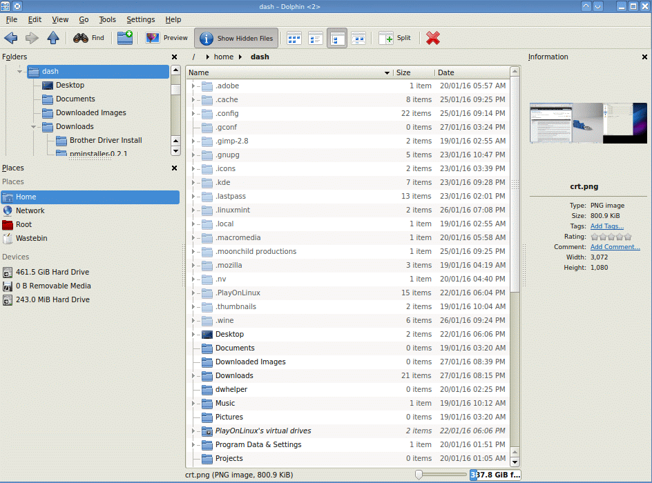

    The monitor is a 1080p Benq 27", model EW2750ZL.
    It's a cheap monitor to be sure, and maybe it's the relatively large size that doesn't help, and maybe I should have used it with XP or Win7 for a while before installing Linux so I'd have something to compare it to (I'll connect it to my XP PC later) or maybe it's just my brain. I've never liked reading text on an LCD. FXAA is disabled, the Nvidia drivers are set to "use application settings" and I've tried setting anti-aliasing to "system settings" and "custom" (sub pixel rendering RGB, hinting slight) although they look the same to me. I've installed the Microsoft fonts. Here's some screenshots, although I'm fully aware they don't let you see what I see, given a screenshot of a window on my CRT looks the same as a screenshot of the same window on the LCD. I think it's just my brain vs LCDs. Text doesn't look out of focus on the CRT when anti-aliasing is enabled. It just doesn't look as sharp. I haven't messed with any of the Firefox/Pale Moon text settings yet. I assume they're set to use whichever font a web page wants to use, if it specifies one.
    The first page of this thread. With anti-aliasing:
    Without anti-aliasing:
Name:	vh without.gif
    Same page: Windows XP screenshot:
    The Dolphin file manager. With anti-aliasing:
Name:	dolphin without.gif
    You'll probably need to open each image in it's own tab to stop the forum resizing them.
    Not that I want to sidetrack the thread too much with my monitor woes (as I suspect that's what they are) and I've no idea how well the screenshots will translate when viewed on another monitor, but to me the anti-aliasing seems out of focus a little on the LCD, maybe over-done a bit when viewing a web page, whereas the OS itself (ie the Dolphin screenshots) look better with anti-aliasing enabled, even when viewed on a CRT.
