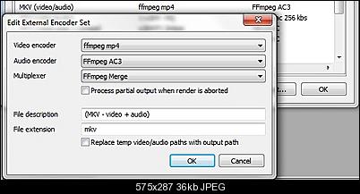

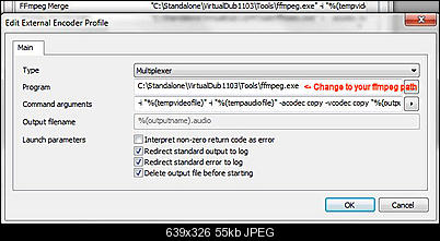

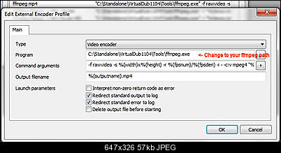

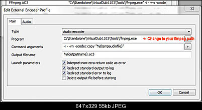

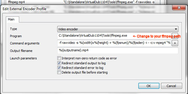

    Anyway, I set Virtualdub to use MP4 V3 compression codec and Audio compression to use AC3 codec. I am enclosing images of how I set up the external encoder as a reference for others that might view this and get a clearer understanding of this feature. Basically, I created an encoder set:
    'FFmpeg Merge', as the muxer under the encoder tabs (Options -> external encoders -> encoders tab)
    'FFmpeg MP4', as the video under the encoder tabs (Options -> external encoders -> encoders tab)
    'FFmpeg AC3', as the audio under the encoder tabs (Options -> external encoders -> encoders tab)
    The script portions were:
    Video =
    -f rawvideo -s %(width)x%(height) -r %(fpsnum)/%(fpsden) -i - -c:v mpeg4 "%(tempvideofile)"
    Audio =
    -i - -vn -acodec copy "%(tempaudiofile)"
    Muxer =
    -i "%(tempvideofile)" -i "%(tempaudiofile)" -acodec copy -vcodec copy "%(outputname)"

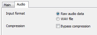

    Normally you would be correct in your steps but that would be to have VirtualDub use IT'S encoders and save the file. But to let the external encoders (ffmpeg) do the encoding, it expects raw data from VDub and a final compression from the audio. By converting to WAV, you just add another step and ffmpeg audio encoder script is set to COPY it so it will copy WAV -> WAV. If you set it to AC3 in VDub, it will be encoded once and thats all.
    Video has a raw data setting and that worked on my test but it's going to send raw data anyway but just won't allow direct stream copy to be selected so, bottom line set the final compessions, audio and video in VDub and that should work. Any other setting are touchy and you get strange results.
    I also added
    -f rawvideo -s %(width)x%(height) -r %(fpsnum)/%(fpsden) -i - -c:v mpeg4 -b 3200k "%(tempvideofile)"
    This improves the final output to near what you had, Actually you can tweak the Video encoder per ffmpeg settings after you get it working in a simple form first.
    I made a video of how it works for me and what I did in sequence at https://files.secureserver.net/0sECwCKGihk6SQ You can download and watch because its a Godaddy site and they quit allowing conversion to watch online. Dumb for them since the cloud, dropbox and others allow better usage and viewing.
    Anyway,
    1. Go with basic setting first
    2. Set VDub Video AND Audio compression settingsa
    3. Use the FFmpeg plugin (FFInputDriver.vdplugin) if you have it since it works here.
    4. You can View-> Log and look for any errors when things don't work also.
    Let me know what happens.

    After viewing the log file, I understood the mistake, i.e. under FFMpeg Merge - I didn't check the box 'Delete output file before starting'
    When I did it, every thing went on fine and finally I succeeded. Thanks a lot Bud for your patience. You have added a feather in my learning
    curve. Thanks again for your immense help.
