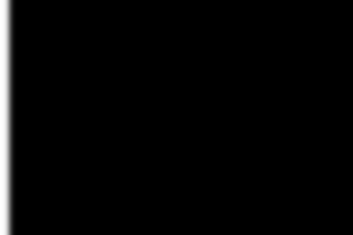

  6. Then you might be able to use frame interpolation techniques, rather than inpainting, by interpolating only the area in question, either by using a mask to leave the rest alone, or by cropping down to only the part needing interpolation, something like this:
    A=Last
    B=A.ReplaceFramesMC(first bad frame number, number of frames needing interpolation)
    Mask=ImageSource("Fog.bmp")
    Overlay(A,B,0,0,Mask)
    I uploaded a JPG rather than a BMP, for the smaller size:
