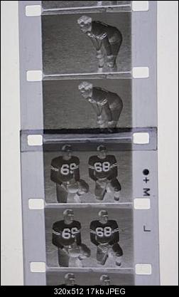

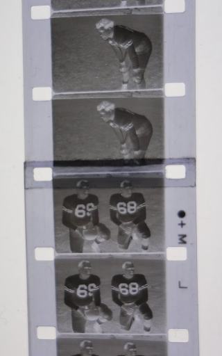

When film is edited by cutting and pasting you can sometimes see the glue at the top or bottom of the frame.
Can you show me example? I didn't understood.
I don't have any examples handy. It's s thin horizontal line of junk at the top (or bottom) of the frame. Exactly what you might imagine the glue holding two pieces of film together at a splice would look like.
<edit>
Here's a sample image of a length of film with such a splice:
</edit>
