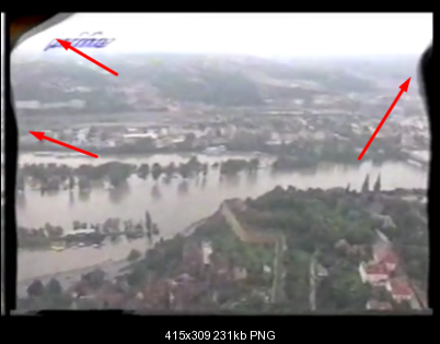

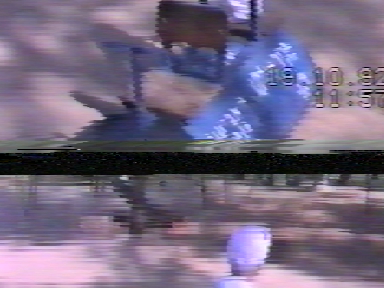

    Update:
    It seems that I have.
    Does external TBC device can fix also this:

  21. Canopus ADVC devices have a full frame TBC, not a line TBC. A full frame TBC puts out a constant signal whether or not the input is clean, just like the graphics card in your computer puts out a constant signal to your monitor when your capture card loses sync -- the Desktop remains intact even if the picture in the capture software's window is messed up.
  22. Originally Posted by jagabo View Post
    Please answer me which external TBC device can fix the problem I mentioned in post 19
    and if so then which kind of TBC - "full frame" or "line". From what I understood it is the line tbc (if it really can fix it)
    What do I get from "full frame TBC" ? What you mentioned can be done in the computer if it is only adding frozen frames when the signal is lost..
  23. The problem in post #19 is a vertical sync issue. If it's just an occasional frame a full frame TBC might fix it by substituting the previous good frame. If it's consistent over longer periods adjusting the VHS decks tracking, using a different VHS deck, or using a different capture device is more likely to fix it.

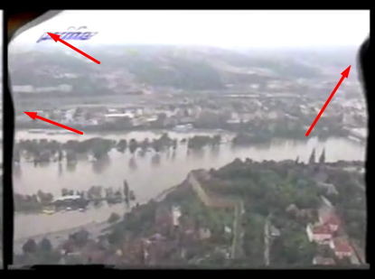

  25. A line TBC corrects individual scan lines, aligning them horizontally and making them all the same length (using the horizontal sync pulses as the reference). If the input signal is lost or too badly degraded a line TBC will do nothing useful.
    A full frame TBC is basically a video capture device. It captures frames to an internal frame buffer and outputs frames from that frame buffer. If there is no incoming signal or the incoming signal is badly degraded the contents of the frame buffer may be the last field or frame that was actually captured or may be blank (blue, black, noise, error message, whatever). But the output signal will always have perfect vertical and horizontal sync pulses. This is important for TV studios that must always put out a signal with perfect sync. A full frame TBC does no image processing (well, some have proc amp controls and some include a line TBC). It does not interpolate missing frames. At best it subtitutes an earlier frame for missing or damaged frames.
  26. Originally Posted by jagabo View Post
    You mean that it corrects this type of error
    right?
    And this is the only error that it can fix? It can't fix the image jump frames?
    OK now I think I understood.
    I think this part of the process already done on the computer - If there is no new frame then it shows and uses the last one.
    But this - "But the output signal will always have perfect vertical and horizontal sync pulses" does not happening.
    My device is not ignoring frames like image jump..
    But I think that maybe there is an option to deal with it later in the later processing step by avisynth. I'm right?
    Is there plugin / function in avisynth that its job is to detect any "image jump" frames automatically and replace them with fixed frames?
  27. Originally Posted by gil900 View Post
    [Attachment 35322 - Click to enlarge]
    right?
    Yes.
    That is it's main job but it might fix other problems simply because it's better designed than many capture devices. For example, some capture cards occasionally have problem detecting which is the first scan line of a field -- they start with an earlier or later scan line. So the picture bounces up and down by a scan line or two between frames. Another device may be better at detecting the first scan line and won't have that bounce.
    It depends on the capture device. Some stop capturing if the signal is too mangled. Some will falsely detect Macrovision and blank the picture. Some may skip the frame leading audio/video sync problems, etc.
    I don't know of any that will automatically fix such problems. You can manually locate the bad frames and insert copies of other frames, or insert motion interpolated frames.
    This is not an option any more. I did just that some time ago it is very, very painful process.
    Maybe there's a way to automatically detect image jumps by looking for unusual motion?
    I mean to use some plugin that log unusual motions and maybe in most cases it will be image jumps..
  29. Originally Posted by gil900 View Post
    When film is edited by cutting and pasting you can sometimes see the glue at the top or bottom of the frame. And the seam sometimes causes the frame to jump up or down in the projector for one frame. There is a filter that fixes this by detecting scene changes then replacing the bad frame with a copy of the one before or after. I don't remember the name of that filter. It might work for single frame errors but not for longer stretches.
    I don't think any filter will recognize the frame in post #19 as motion. But many filters have scene change thresholds that would detect it. Of course, they detect every scene change too.
  30. When film is edited by cutting and pasting you can sometimes see the glue at the top or bottom of the frame.
    Can you show me example? I didn't understood.
    Can you give me an example of "single frame error" that the filter can detect and fix?
    I would love to know the name of the filter.
    Other thing - If I am going to insert "motion interpolated frames" then there is no way that I will do it as before - through code in avisynth (The most painful thing I've ever done).
    Do you know about some user frindly video editing software (like sony vegas for example)
    with easy option to insert motion interpolated frames?
