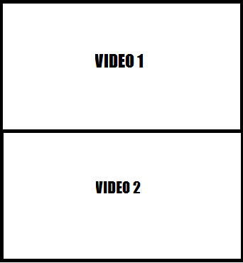

  1. Basically, what i want to do is make 2 video fragments display like this:
    Or like this:
    I heard FFmpeg can do this, but i can't find a good GUI that provides this utility and the command window is too confusing to use.
