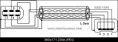

  12. I took a look at the pinout :
    http://hardwarebook.info/IEEE1394
    The 6 pin connector Vg is connected to the inner cable shield and the ground return.
    The 4 pin connector is only connected to the outer cable shield
    So I guess the safer option is a 4pin to 4pin cable and following the safety procedure. There is not much you can do for the camcorder's psu.

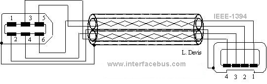

  13. Originally Posted by ackboo View Post
    I can see that is how it is supposed to be configured...
    I have found that the attached schematic seems to be nearer the mark . Certainly, that schematic is how my own Firewire 4 to 6 cable is connected...
    (That is the external cable screen to the 6 pin connector 'shroud', and the internal cable screens to pin 2 of the 6 way connector (Vg), and the connector 'shroud' at the 4 pin end.)
    Hence my comment about a Vg reference...
