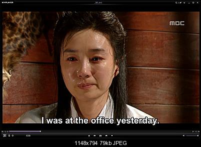

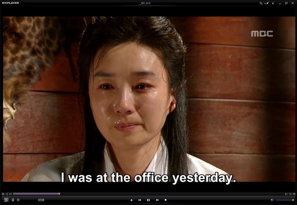

    Here's KMPlayer playing the above script with a random SRT subtitle file:

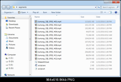

  11. Start NotePad. Copy and paste the contents of the code box in post #8 into it. Save the document with .BAT as the extension. Ie, give it a name like MakeAVS.bat. You now have a batch file.

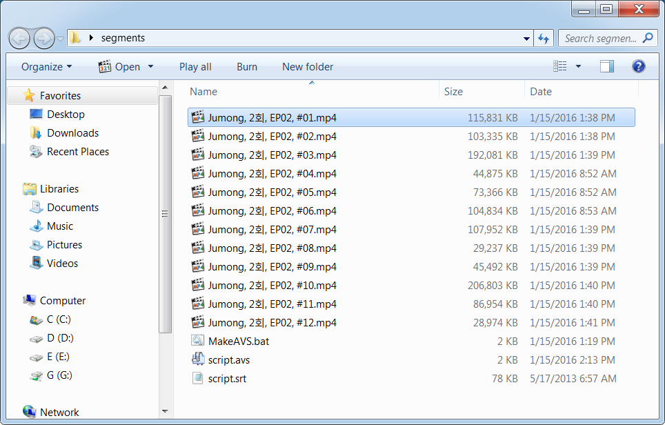

    To drag/drop mulitiple files onto a batch file open the folder with your files in Explorer. Make sure the files are sorted by name, alphabetically. Left click on the first file to highlight it:

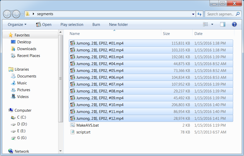

    Hold down the shift key and left click on the last file. That should select all files from first to last, they should be highlighted:

    Move back to the first file, press the left mouse button on it (don't release yet), drag to the batch file, and release. A file named script.avs will be created. You can open that script in a player or editor that supports AviSynth scripts. I included an SRT file in the same folder to verify the subtitles were working as expected.
