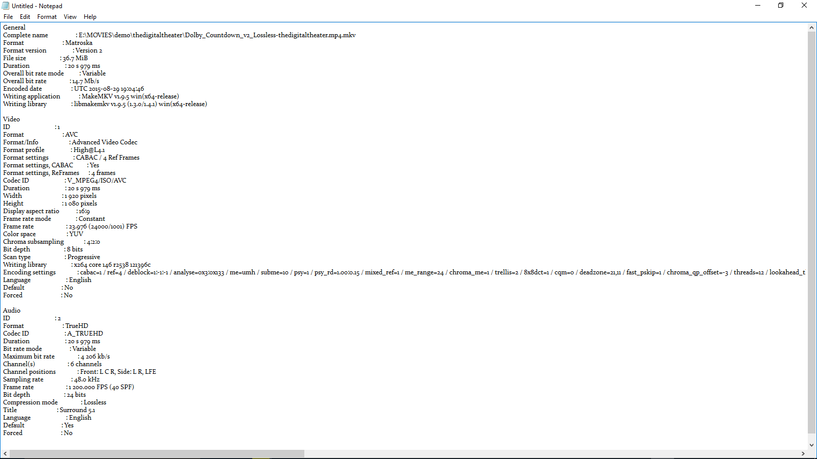

  5. HEY there every one....
    I tried to follow the steps in that steps provided in the forum and finally successfully converted a mkv TrueHD+Atmos to M2TS ...that is playable on my sony bluray(SONY BDVN9200W)...
    But there is a problem.....The source file i had was a 24bit....but after going through all the steps as Ennio instructed ,i was able to mux it in tsmuxer and the output now has a 16bit TrueHD and when i played it on my bluray, its not showing the bitdepth ...as it used to show it earlier, whether its 24 or 16Bit along with the audio codec that's playing on the bluray, if i press the mediainfo button om my remote.....and the file(TrueHD+ac3) i got out of Useac3to was 7GB+...but when i went through Mediainfo 17.10 after succefully muxing and creating a M2TS video files in Tsmuxer....its showing that the the TrueHD+ac3 is just 600mb in Mediainfo 17.10 !!!!
    So is there any solution for it ....so that i would get the output as 24Bit in tsmuser or, have i gone wrong anywhere during the process..?
    And i also noticed that ...the sample video file which Ennio (Atmos_trailer) has uploaded had the same media-info as i got ...if im not wrong...
    Here is the mediainfo of wht i muxed....Image
    [Attachment 43731 - Click to enlarge]
  6. pls some one reply me....im breaking my head from a couple of days..please

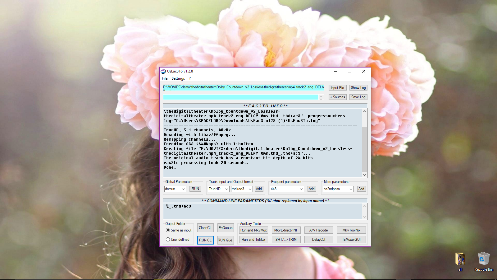

  9. Hey there Ennio
    No there's no such thing shown to me on the eac3to .
    I hav uploded some of the screens,in that the one with the name muxed is the final video i muxed with tsmuxer,and other file has the original information of the video file.

  11. Member Ennio's Avatar
    May 2005
    Netherlands
    @ vishal.vj
    Did you try latest eac3to version 3.34? Maybe that'll help? I wouldn't know what else to help you out...

    And i absorbed one thing in common, the mediainfo after demuxing the original source(24bit 48KHz) in UsEac3To and muxing the thd+ac3 in tsmuxer.....it still says (mediainfo) 24bit as 16bit !!!!
    ORIGINAL :
    General
    Complete name : E:\MOVIES\demo\thedigitaltheater\Dolby_Countdown_v 2_Lossless-thedigitaltheater.mp4.mkv
    Format : Matroska
    Format version : Version 2
    File size : 36.7 MiB
    Duration : 20 s 979 ms
    Overall bit rate : 14.7 Mb/s
    Encoded date : UTC 2015-08-29 19:04:46
    Writing application : MakeMKV v1.9.5 win(x64-release)
    Writing library : libmakemkv v1.9.5 (1.3.0/1.4.1) win(x64-release)
    Video
    Format : AVC
    Format profile : High@L4.1
    Format settings : CABAC / 4 Ref Frames
    Format settings, CABAC : Yes
    Format settings, ReFrames : 4 frames
    Codec ID : V_MPEG4/ISO/AVC
    Width : 1 920 pixels
    Height : 1 080 pixels
    Display aspect ratio : 16:9
    Frame rate mode : Constant
    Frame rate : 23.976 (24000/1001) FPS
    Color space : YUV
    Chroma subsampling : 4:2:0
    Bit depth : 8 bits
    Scan type : Progressive
    Writing library : x264 core 146 r2538 121396c
    Encoding settings : cabac=1 / ref=4 / deblock=1:-1:-1 / analyse=0x3:0x133 / me=umh / subme=10 / psy=1 / psy_rd=1.00:0.15 / mixed_ref=1 / me_range=24 / chroma_me=1 / trellis=2 / 8x8dct=1 / cqm=0 / deadzone=21,11 / fast_pskip=1 / chroma_qp_offset=-3 / threads=12 / lookahead_threads=1 / sliced_threads=0 / nr=0 / decimate=1 / interlaced=0 / bluray_compat=0 / constrained_intra=0 / bframes=3 / b_pyramid=2 / b_adapt=2 / b_bias=0 / direct=3 / weightb=1 / open_gop=0 / weightp=2 / keyint=250 / keyint_min=23 / scenecut=40 / intra_refresh=0 / rc_lookahead=60 / rc=crf / mbtree=1 / crf=15.0 / qcomp=0.60 / qpmin=0 / qpmax=69 / qpstep=4 / vbv_maxrate=20000 / vbv_bufsize=30000 / crf_max=0.0 / nal_hrd=none / filler=0 / ip_ratio=1.40 / aq=1:1.00
    Language : English
    Default : No
    Forced : No
    Audio
    Format : TrueHD
    Codec ID : A_TRUEHD
    Bit rate mode : Variable
    Maximum bit rate : 4 206 kb/s
    Channel(s) : 6 channels
    Channel positions : Front: L C R, Side: L R, LFE
    Sampling rate : 48.0 kHz
    Frame rate : 1 200.000 FPS (40 SPF)
    Bit depth : 24 bits
    Compression mode : Lossless
    Title : Surround 5.1
    Language : English
    Default : Yes
    Forced : No

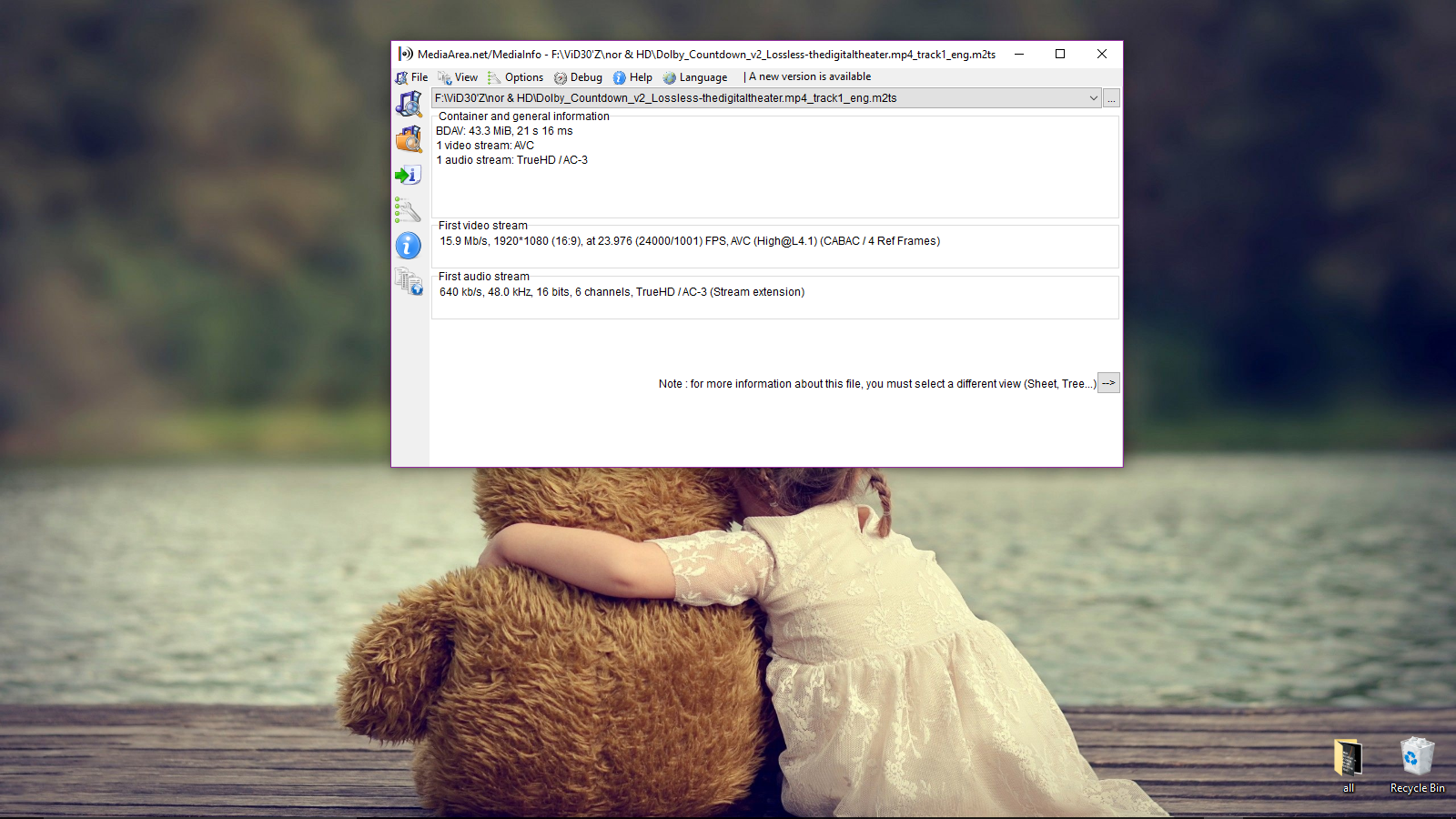

    FINAL MUXED (AFTER USING THE LATEST eac3to)
    General
    Complete name : F:\ViD30'Z\nor & HD\Dolby_Countdown_v2_Lossless-thedigitaltheater.mp4_track1_eng.m2ts
    Format : BDAV
    Format/Info : Blu-ray Video
    File size : 43.3 MiB
    Duration : 21 s 16 ms
    Overall bit rate : 17.3 Mb/s
    Maximum Overall bit rate : 35.5 Mb/s
    Video
    Menu ID : 1 (0x1)
    Format : AVC
    Codec ID : 27
    Bit rate : 15.9 Mb/s
    Maximum bit rate : 40.0 Mb/s
    Color space : YUV
    Bit depth : 8 bits
    Bits/(Pixel*Frame) : 0.321
    Stream size : 39.9 MiB (92%)
    Audio
    Menu ID : 1 (0x1)
    Format : TrueHD / AC-3
    Muxing mode : Stream extension
    Codec ID : 131
    Duration : 20 s 992 ms
    Bit rate mode : Variable / Constant
    Bit rate : 640 kb/s
    Frame rate : 31.250 FPS (1536 SPF)
    Bit depth : 16 bits
    Stream size : 1.60 MiB (4%)
    Service kind : Complete Main
    @ ennio
    And i saw the same results in the mediainfo of ur previous video , which u have uploded in the forum #23
    mediainfo of the final muxing
    [Attachment 44335 - Click to enlarge]

    @ vishal.vj
    I think I can't help you any further, other than that MediaInfo would probably state the bitdepth of the embedded AC-3 track, which your sourcefile (atmos only) of course does not have.
    I do try to carefully say that things are all right because of the MediaInfo data of the original .m2ts file, which comes from the original Atmos demo disc.
    Latest MediaInfo says on the original m2ts file also "Bit depth: 16 bits". So I wouldn't worry...??

  26. Member Ennio's Avatar
    May 2005
    Netherlands
    Originally Posted by ridonkulous View Post
    ...and produced another .mkv file with the thd track inside
    No need to, you can directly import the .thd track as source in eac3to.
    ...scoured the forums to find out I need ffmpeg to actually make the process work
    I never was aware that ffmpeg was needed.
    Here's my workflow to get eac3to and UsEac3to GUI up and running.
    Download https://www.videohelp.com/download/eac3to334.zip and unpack it as your eac3to folder.
    You'll find UsEac3to (the GUI) here https://forum.doom9.org/showthread.php?t=145574 (choose download GUI only)
    Extract file in eac3to folder. Now you can run "UsEac3To.exe" as GUI to eac3to. Follow the steps as posted earlier.

  29. Member
    Feb 2018
    Australia
    Thanks for that. OK downloaded that, spotted the Useac3to.exe file inside the eac3to file, opened that.
    A window came up automatically still requesting I link software to the programme, when I thought that by opening the .exe file all that stuff would have been instantly recognized by the GUI.
    I closed that window off and tried to input a file, and the same result, didn't open.
    Maybe I do need to manually input this stuff (so I tried copying this into the window where it asks for a file; C:\Users\SP 1\Desktop\eac3to334-UsEac3to128.zip\eac3to334-UsEac3to128\, and a sign came up saying catastrophic failure)..........
  30. Member
    Feb 2018
    Australia
    ...OK spoke too soon.
    I stupidly expected the programme to run just by unzipping the file. I had to unzip and the EXTRACt the file onto the desktop, THEN open it up and Voila it all works.
    Currently processing a file now. I selected thd+ac3 output, a command line appeared and I just hit RUN CL. The command screen is up and a file is happening. I'll report back the results.
