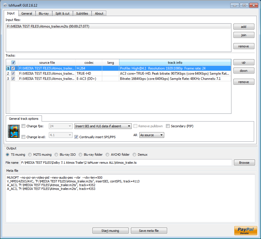

  26. Member Ennio's Avatar
    May 2005
    Netherlands
    Tsmuxer doesn't recognize the atmos 7.1 and just opens the h.264 and ac3.
    You don't get this in your tsMuxer window?
Name:	tsMuxer Dolby Atmos trailer.png
