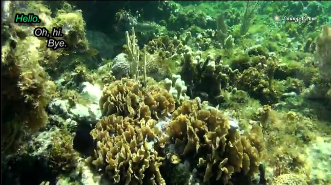

    This will allow subtitles to be interpreted as:
    Dialogue: Marked=0,0:00:12.00,0:00:15.00,MainB,,0000,0000,00 00,!Effect,{\a5}{\c&H80FF00&}Hello.
    Dialogue: Marked=0,0:00:12.00,0:00:15.00,MainB,,0000,0000,00 00,!Effect,{\a5}{\c&HE0E0E0&}\h\h\h\h\h\h\hOh, hi.\N\h\h\h\h\h\h\h\h\h\h\h Bye.

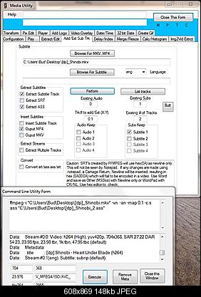

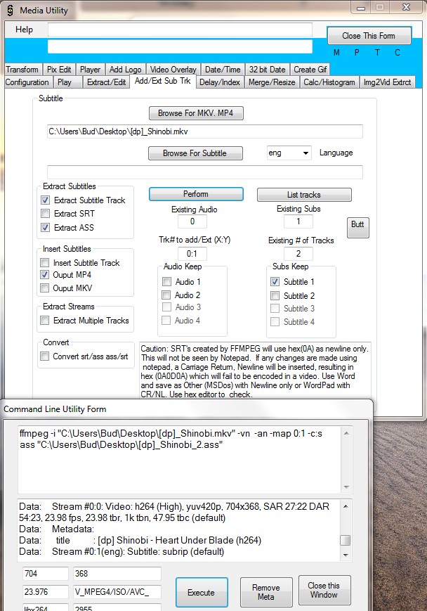

    If extracting normal subtitles (not such as DVDSub subtitles) use:
    ffmpeg -i "C:\Users\Bud\Desktop\[dp]_Shinobi.mkv" -vn  -an -map 0:1 -c:s ass "C:\Users\Bud\Desktop\[dp]_Shinobi_2.ass"
    It works as shown below on a video with only video and subtitle track, no Audio. The format is the same just change the '-map 0:1' to whatever subtitle track you want.
    E.G. Video, Audio, subtitle 1 -> -map 0:2
    E.G. video,audio,subtitle 1, subtitle2 -> -map 0:3
Name:	ScreenHunter_190 Mar. 23 23.12.jpg
