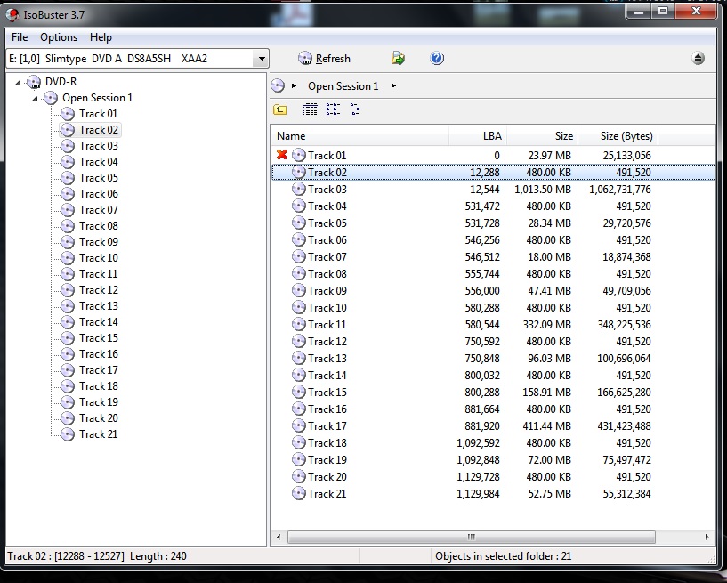

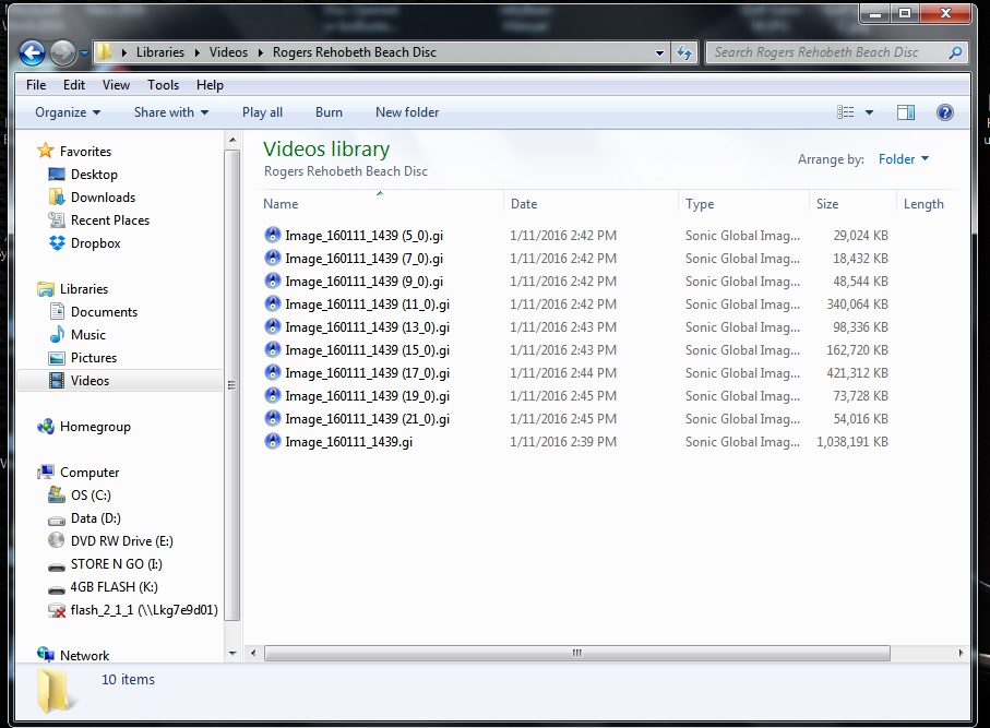

    I hope I did this right....I've attached two screen shots. One of the disc I was able to read using Roxio, and one of the disc using IsoBuster. I'm not sure what they indicate, except there's a red X alongside of Track 1 on the IsoBuster pic. Hopefully you guys can determine what direction I need to go in from here. Thanks for all the input!!

    Another development...as aedipuss suggested, I renamed the largest and smallest file with the extention mpg. I then was able to play that file using VLC !! So all is not lost. Thanks for that idea aedipuss! The othe thought I had, is...could track 01 with the red X be the index or directory for the disc? I don't know what to tell IsoBuster to do at this point. Thanks guys, for the input.

    track 1 may be an unfinalized video from the recorder. you might not find anything to read that. if you can copy it to your hard drive try using a hex editor to see what's in it.

    Thanks for the input. Do you think that Track 01 can be a missing finalizing indication? I'm inclined to try and finalize the disc, but need a program like CDroller to read the suspected unfinalized disc. If it tells me it's already finalized, then I think the approach would be to re-burn a DVD by converting the .gi files to mpg and processing the files with Nero or Roxio to burn a new DVD. I think that should work, yes? Also, do you know of any freeware program that can read an unfinalized disc? I really appreciate you sticking with me on this issue!
