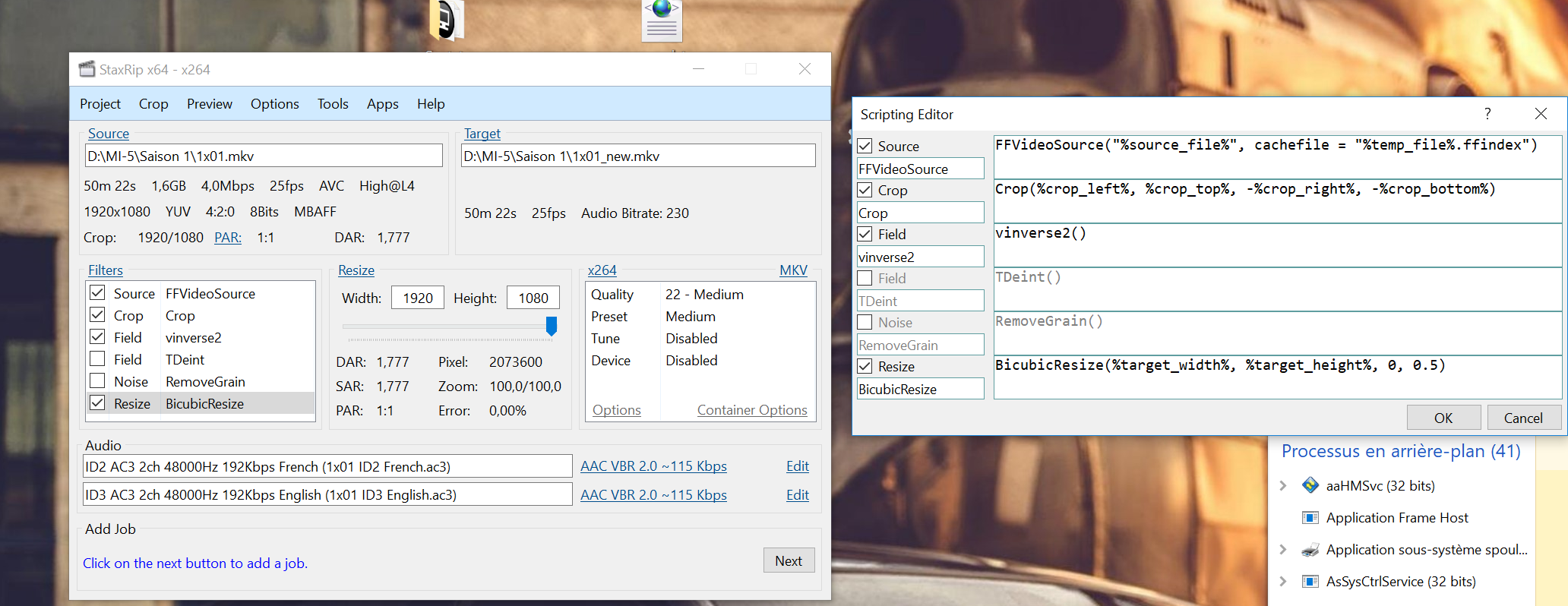

  16. Vinverse appears to be integrated staxrip on the contrary no difference after encoding the defect of fields remains
    LoadPlugin("C:\Users\jax\Documents\staxrip\Apps\Pl ugins\both\ffms2\ffms2.dll")
    LoadPlugin("C:\Users\jax\Documents\staxrip\Apps\Pl ugins\avs\vinverse\vinverse.dll")
    FFVideoSource("D:\MI-5\Saison 1\1x01.mkv", cachefile = "D:\MI-5\Saison 1\1x01_temp\1x01.ffindex")
    Crop(10, 6, -10, -6)
    vinverse2()
    BicubicResize(1920, 1080, 0, 0.5)

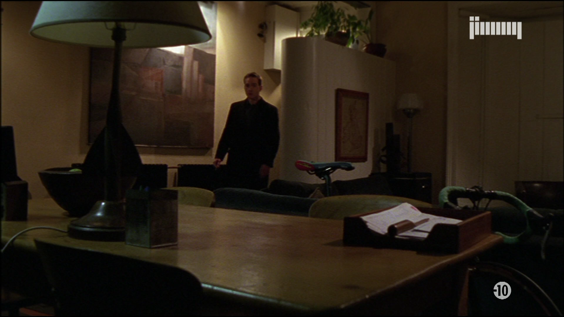

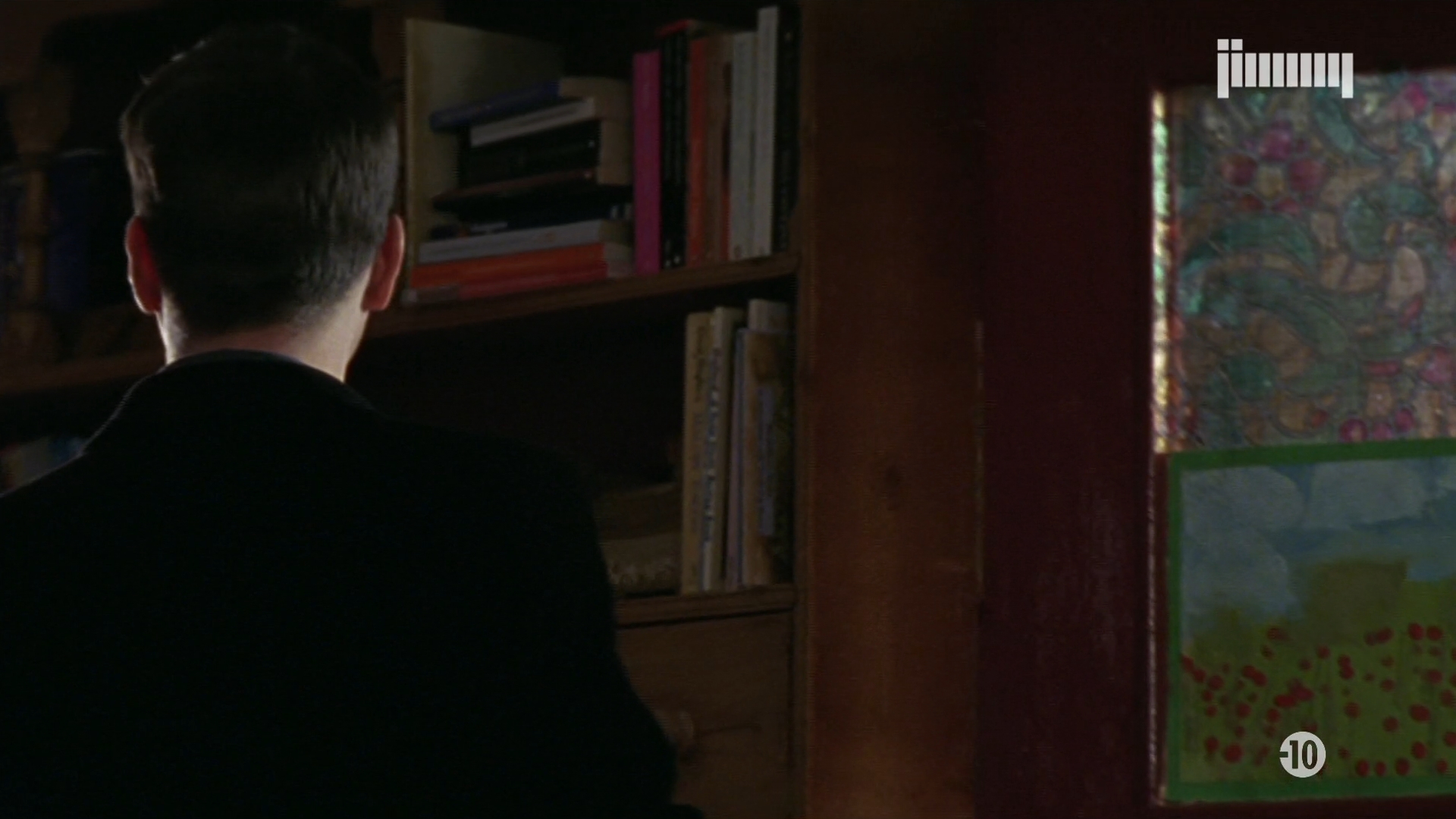

    [Attachment 41478 - Click to enlarge]
    after
    [Attachment 41479 - Click to enlarge]
