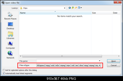

  11. VirtualDub will also look for source plugins in its plugins32 folder if there is one. Use the "files of type" pulldown to force the use of the "AVIFile input drive (Compat)" source filter. That may give you a more explicit error message.
    I'm not finding the "files of type" pulldown anyplace - ?

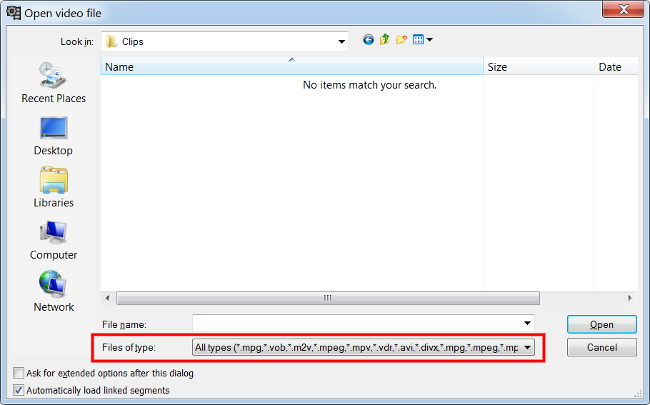

  13. It's on the File -> Open Video File dialog:

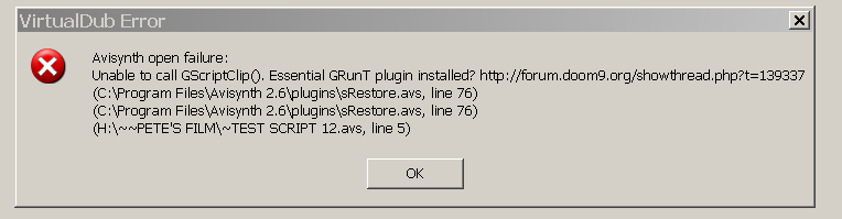

    Thanks, found it and here's the error:

  15. Looks like you need the GRunT plugin. http://avisynth.nl/index.php/GRunT
  16. I asked earlier if you had all the required filters:
    Srestore requires other filters before it works. Do you have them as well?
    And when you go to the SRestore page you see, clear as day:
    Optional plugins:
    TIVTC - (only for cache>0, not default)
    RemoveGrain v1.0b - (only for double-blend-removal, not default)
    Average - (only for double-blend-removal, not default)
    GRunT (only for Srestore v2.7f or greater)
    And earlier you said:
    Originally Posted by bvdd View Post
    I replaced srestore 2.7e with 2.7h.
    So, the problem should have been obvious. However, I sympathize because when I forget to load the Grunt.dll, VDub mentions it specifically as being missing and you weren't getting specific error messages. And the Grunt.dll didn't used to be necessary and maybe if you had stuck with version 2.e you might have gotten it running earlier. AviSynth can be difficult, alright, at least partly for the reasons you discovered - different versions of important filters often need different versions of other filters just so they can work.
